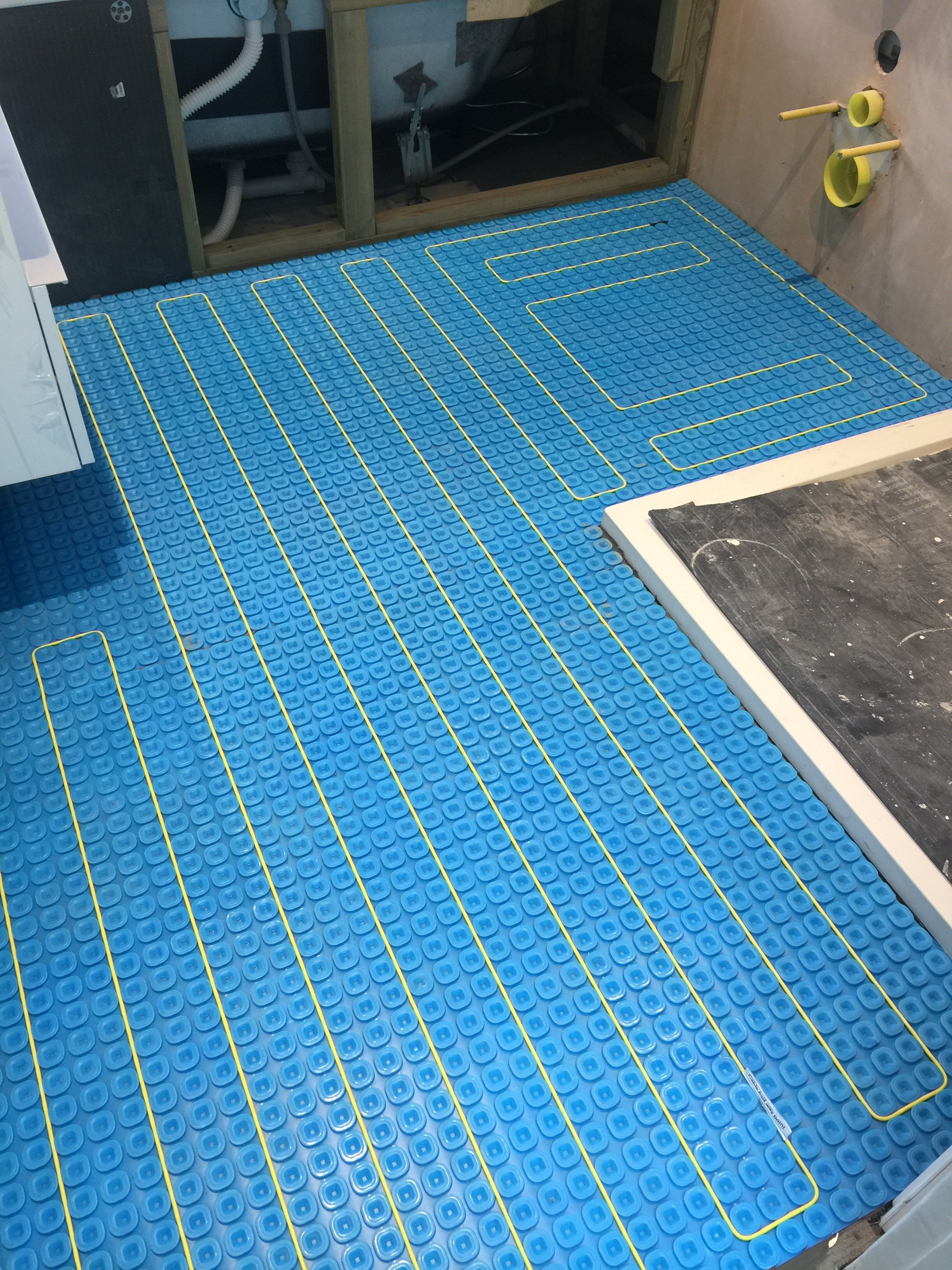

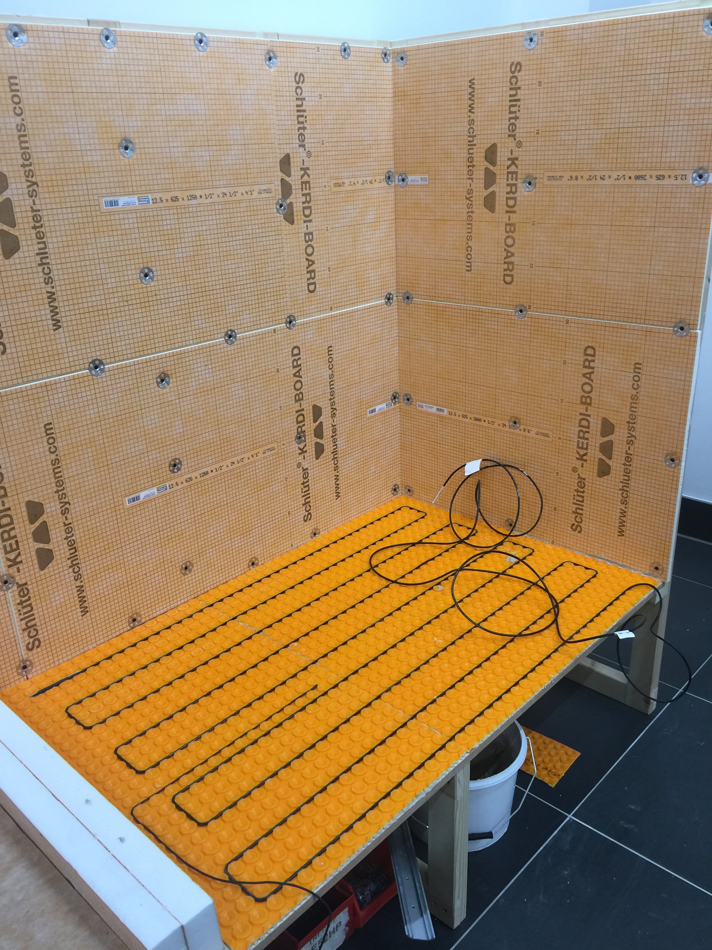

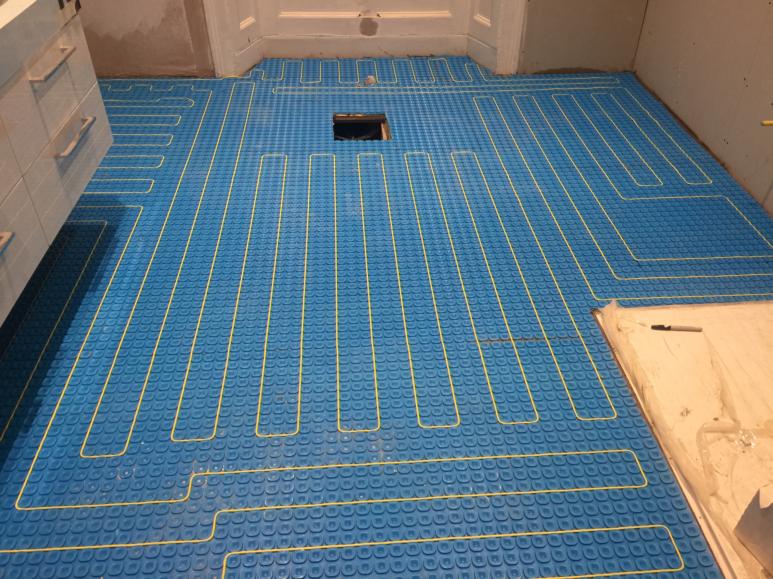

View attachment 88596 View attachment 88597 View attachment 88598
yes its exactly what I was thinking... impressive system (and expertly laid may I add)

Well with regular electric UFH it should not be run beneath permanent items of furniture or sanitary ware. I can't imagine this being any different.
So you would preferably have some kind of room layout plan to work to, therefore avoiding wardrobes and the like. By the time you leave these spaces out, as you can see in the images above, you may well find you're down to 20m2 anyway.
However, most controllers take multiple mats, up to 4 normally I think, so increaseing the m2 up to even 30m2 from 19m2 is never going to be a problem.
