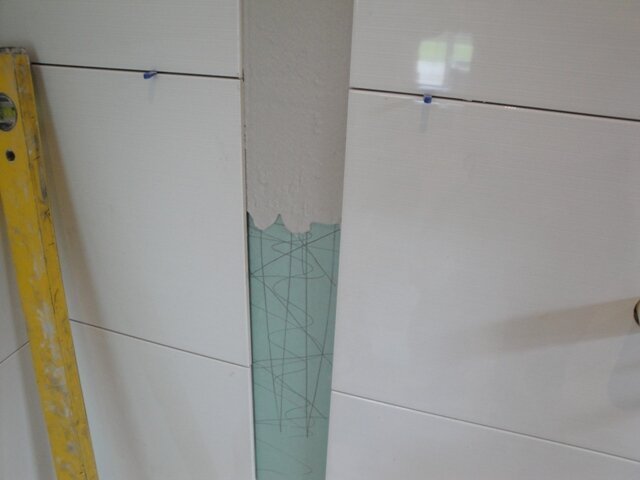

Something like this, use tile off cuts to leave an opening for the mosaic
Thanks, Whitebeam, especially for the picture.
That's a great solution for leaving the correct width for the border to go in.

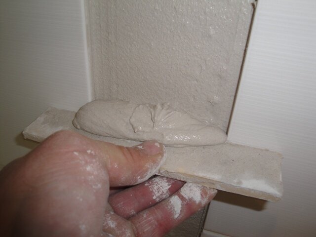

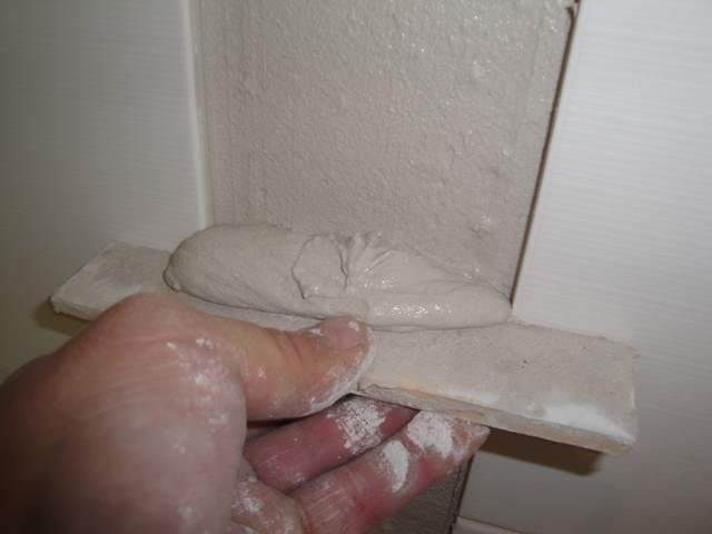

Had this discussion today, Im not so much a fan of the self adhesive mosaic bedding strips. I prefer to tile bottom then top with a baton then screed the border in with a piece of timber cut to size.
I prefare the old dog eared screed:thumbsup:

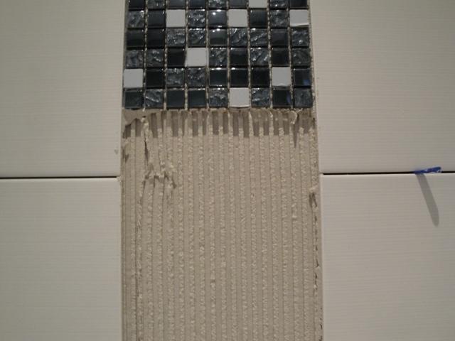

I quite often use both, the mosaic mesh stiffens the strips up, but still leaves enough of the biscuit exposed to get a decent adhesive coverage and the dog eared method builds out the adhesive to the required thickness.
