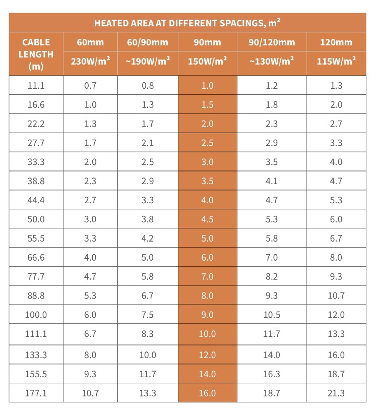

On the subject of spacing, the warm up dcm pro, which is probably the same cable, have a strange recommendation, can anyone enlighten me on how you run that at 190w per m? Do you alternate the spacing ?

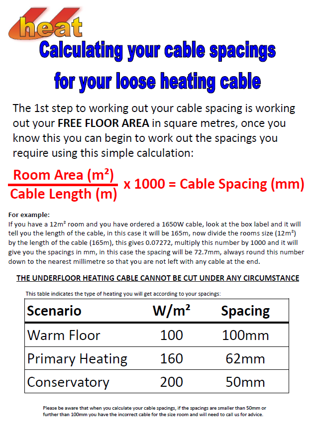

It's down to the spacings of the cables, if you want 200w/m2 for a heating cable you'd do the following,
5 x 200 = 1000w so you need 1000w cable to heat that area at 200w/m2, you then find a cable around that wattage, so ours would be an Elektra 980w 98m Cable.
You then have to work the spacings out by doing the area divided by the length of the cable. 5 / 98 = 0.051. You then have your cable spacings of 51mm.
If you'd want 160w/m2 or 100w/m2 then you'd just change the equation around to suit them wattages and find a cable to suit.
