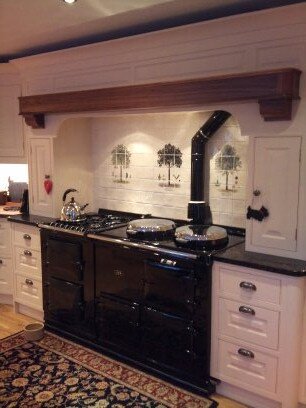

1262309038837.jpg The only feature to look out for with their hand made crackle type tiles is the 'shape and size'. No matter how much care you take they are made to have a particular 'look' and aesthetically rustic. In the many years in using their crackle glaze tiles I've never sealed them and it is possibly a procedure that is now recommended.

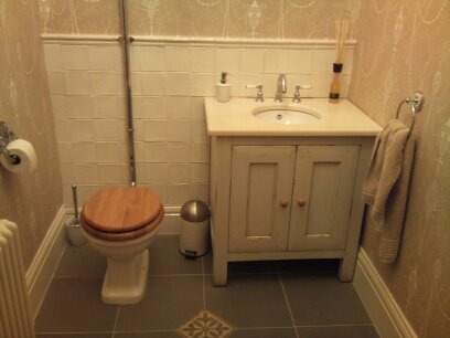

View attachment 40739 The only feature to look out for with their hand made crackle type tiles is the 'shape and size'. No matter how much care you take they are made to have a particular 'look' and aesthetically rustic. In the many years in using their crackle glaze tiles I've never sealed them and it is possibly a procedure that is now recommended.
