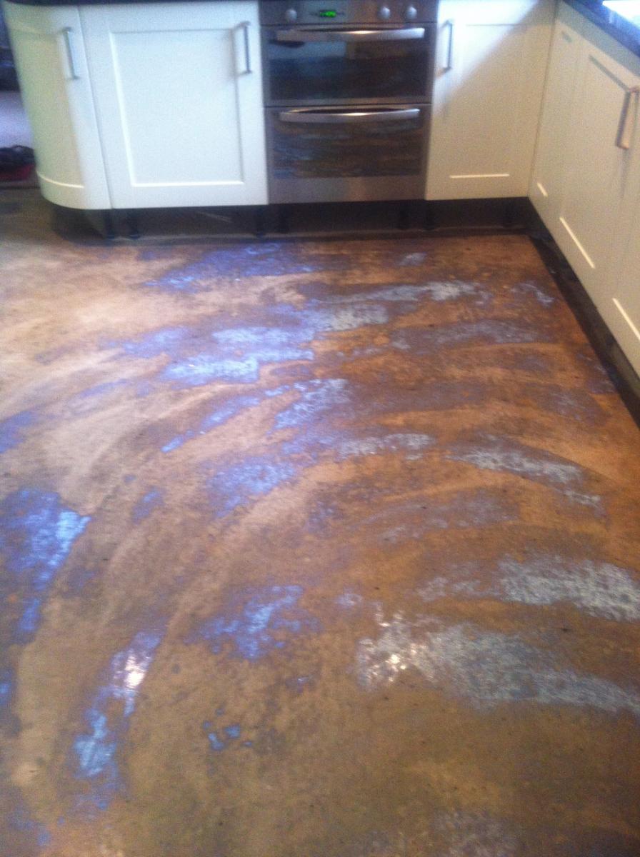

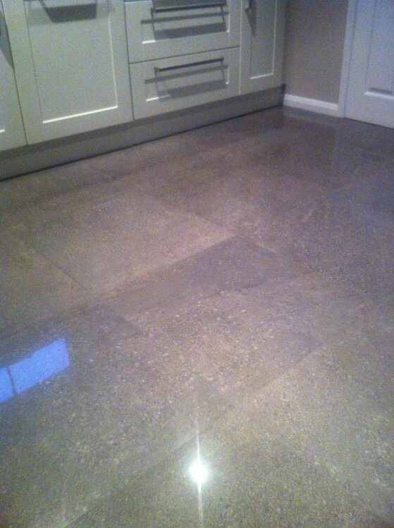

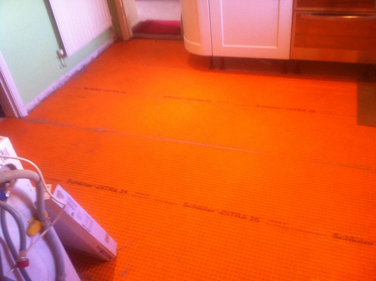

I used Ditra a couple of years ago on a kitchen floor that had a crack in it and I was fixing Porcelain. Customer was happy to pay for it and I just wanted to be doubly sure, only time I've used it when it wasn't natural.
