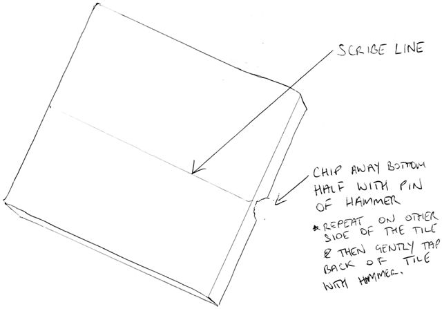

Hey mate,
If the side of the tiles are not seen, it helps to chip away the bottom half of the tiles side just under the scribe line using the pin of the hammer then gently tap the back side of the tile beneath the scribe line. This is how I was taught to cut them.
Hope the pic helps
