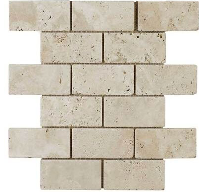

Is there any trick to cutting this type of tile -- 48x98mm in 305mm square sheets (yes, I'm using a electric wet saw).
What is the technique for grouting this kind of tile so that you keep the grout out of the little holes in the tile itself?

I normally just use a 4 inch angle grinder to cut travertine its a bit dusty but just cut it outside or have a vac handy to catch the dust, if you don`t want the holes filled on the face just point the joint but it would be easier to fill the holes, i would recommend a 6mm notch trowel any deeper and the adhesive would start to come through the joints, regarding the adhesive you will be best using a slow set adhesive as it gives you more time to work with it.
I agree, would be much easier (and IMO better) to grout the holes in at the same time. What colour grout are you going for? As above regarding the adhesive. I would try a 4mm trowel, press a sheet of Mosaics back into the adhesive then pull them off and see what the coverage is like, you should be ok to use a 6mm if you need to as, I assume, the trav is 10mm thick.
On another note, you will want to work really cleanly, keep at bucket of clean water next to you as you work and wipe off any adhesive from the face of the tile straight away :thumbsup:

Did you look through all the colours that they do in Ultracolor? They do 26, you can usually find a pretty good match to the stone. White looks horrid with trav IMO. No you shouldn't need to back butter them, you might want to spread the adhesive with the teeth of youe trowel and then smooth them over using the flat side of the trowel to give a really good coverage behind the tile. Also I use a grout float to press the tiles back, the last thing you want is to have one or two that dont stick.
