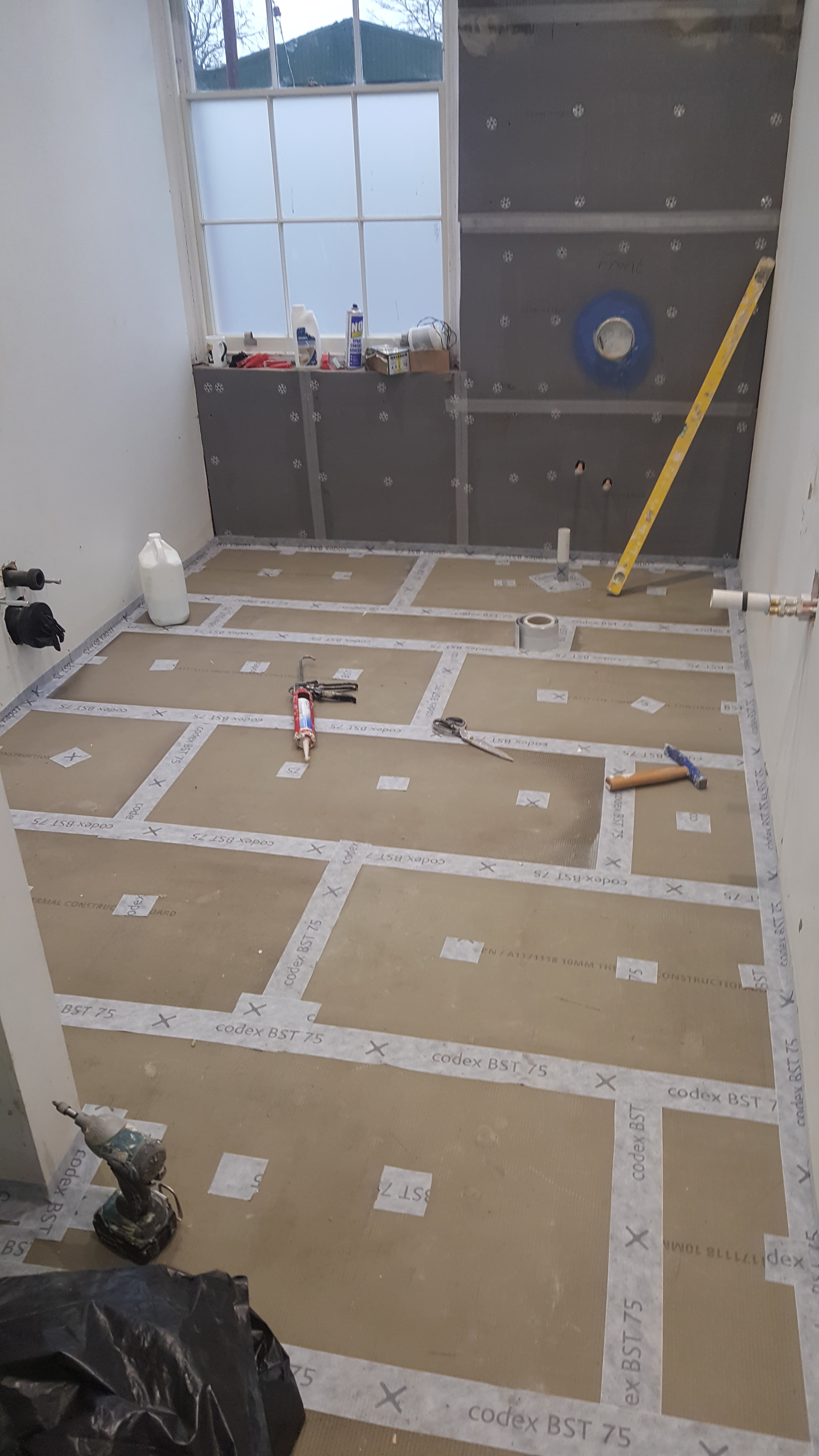

C’mon then, show us your tanking.
Ardex with butyl tape
0A9C5BD6-8470-41B5-836A-D60C32E7CBB0.jpeg 5F116E3F-E2D3-4D6C-8DC9-DB8710F91DF9.jpeg
Wet rooms wedi or similar and the sticky tape but not done one this year.

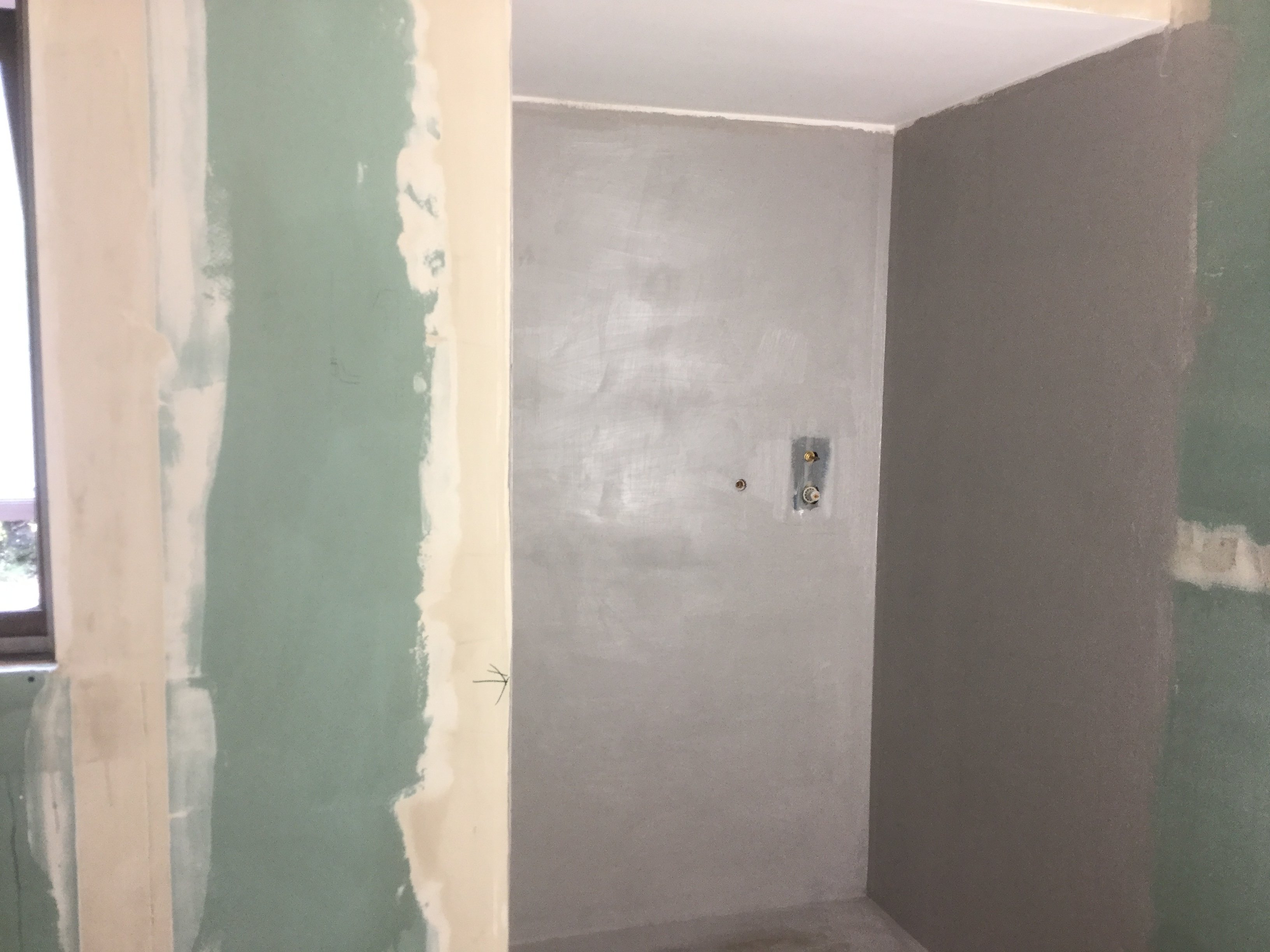

Monday I used Weber.sys protect which is my paint on tanking of choice

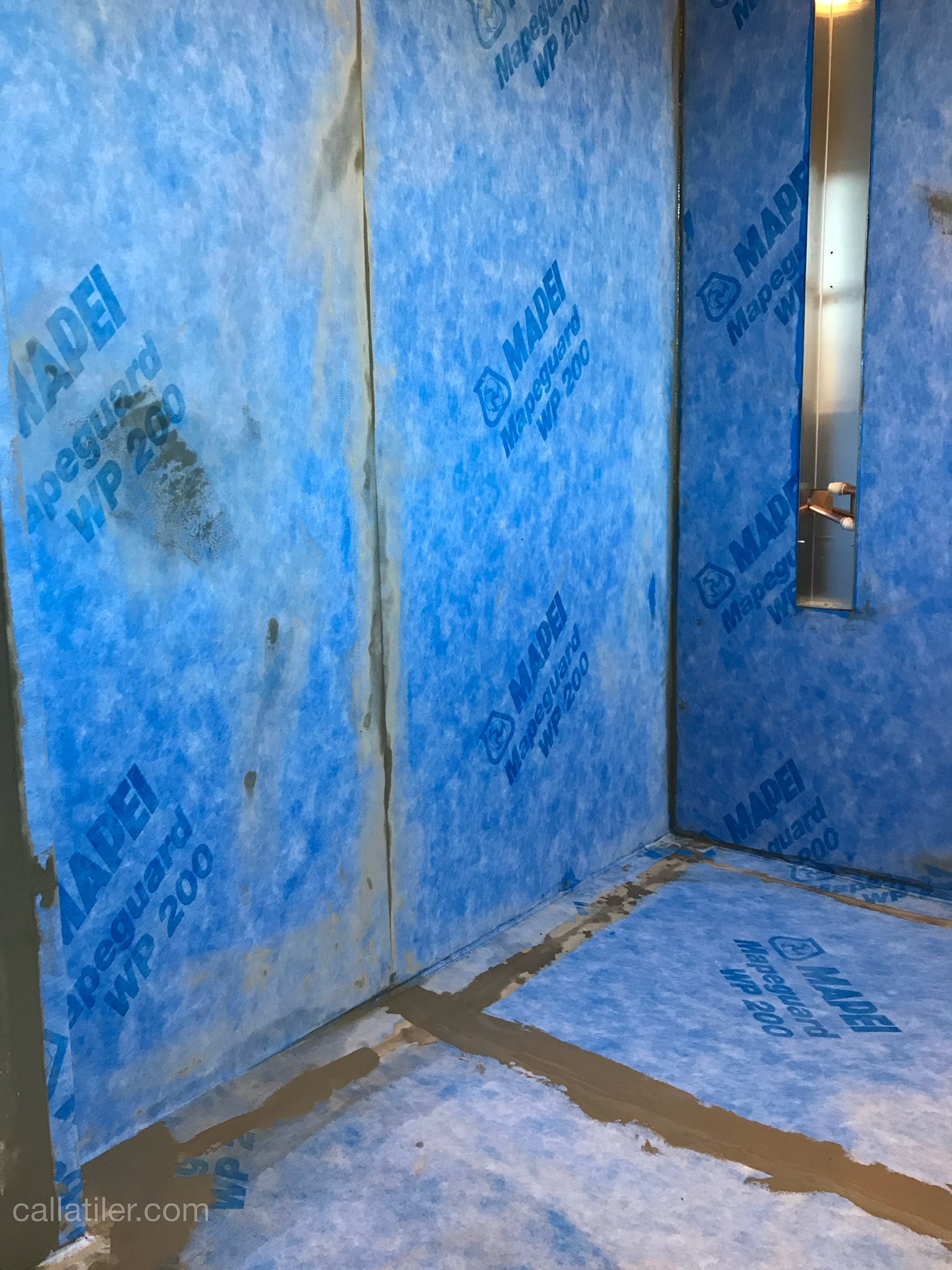

Hey! How do you find using the WP200?
I've done a few hundred SQMs of Prodesso Profoill, I do prefer it over liquid applied expect when there are too many fiddly bits. Hoping Mapei NZ will bring WP200 here soon
The Mapei wp 200 is very easy to use and is my go to system. Used many times now and trusted.
