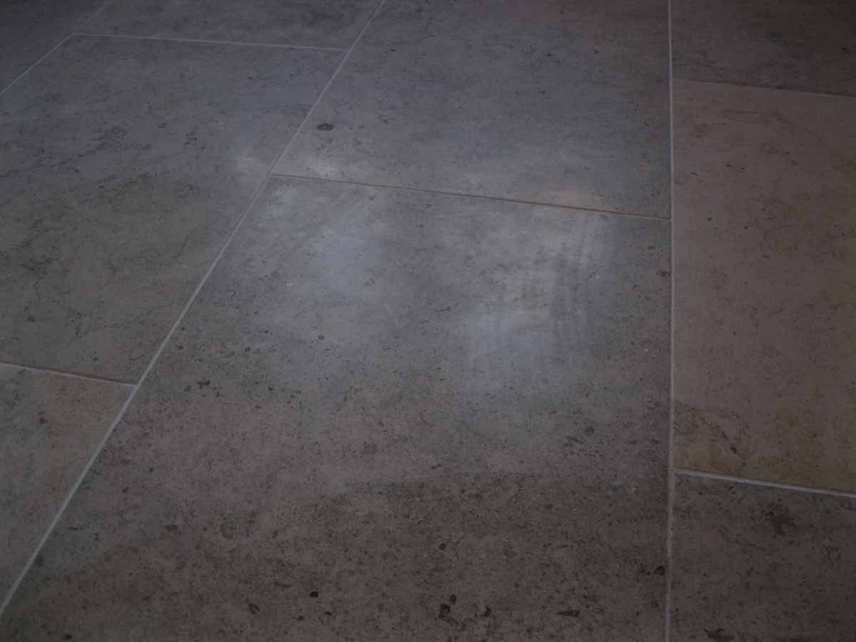

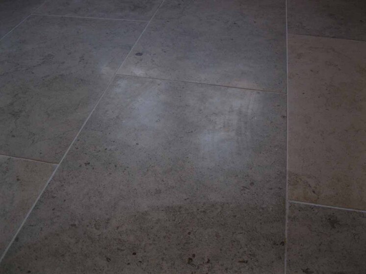

We were going to have a go at sealing the floor tonight. Before we started I noticed some strange marks; they looked like streaks and small blobs. At first I thought it was dirt or some other residue so I fished out the cleaner the fitter left only to read:
"HG cement grout film remover. PLEASE BEWARE! Do not apply to calciferous natural stone such as marble, travertine..."

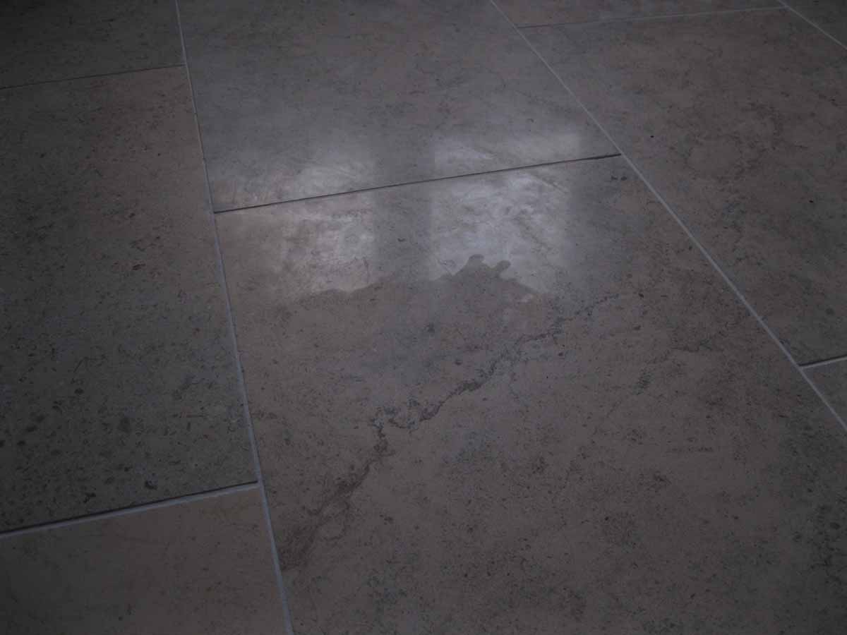

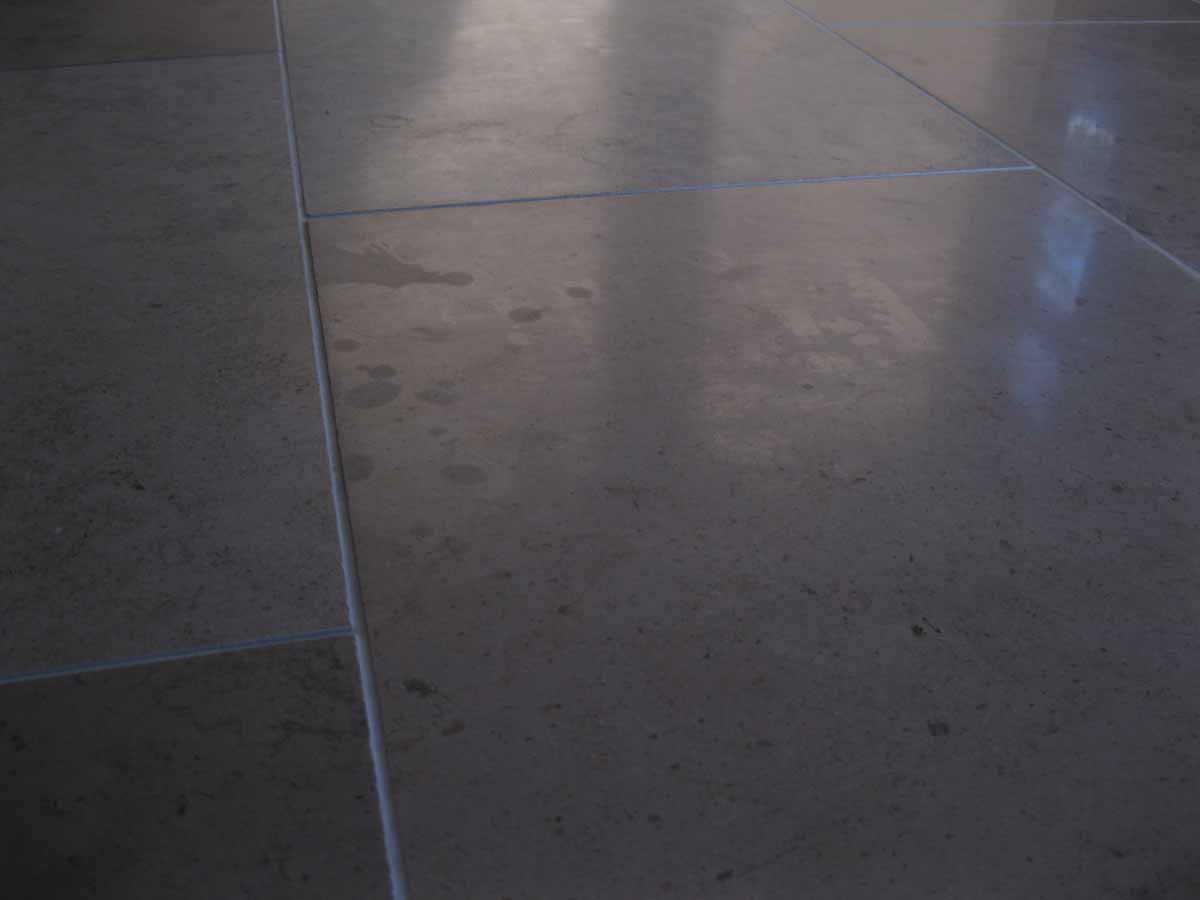

This started alarm bells ringing. The product contains phosphoric acid; we used to use bottles of dilute acid on Uni field trips to distinguish calcaereous rocks. I think that this cleaner has etched the tiles.
When the sealer is applied the tile look wet and shiny as you'd expect. When the sealer dries the etch marks remain as obvious as on unsealed areas.
I've attached a couple of photos, although they do show the damage all that well. I reality it looks much worse:

OOOOHH .. He has really knacked that floor hasn't he..
You are correct and he should not have used that product on Limestone..
You need to state this to the kitchen guy and demand it is replaced...you paid for a new floor , so do not let them try and hide that etching, let us know how it goes...

Thanks for your thoughts. Further inspection has revealed similar (and worse) patches all over the kitchen. One in particular is really rough to the touch - we reckon he must a spilt some of the cleaner and just left it. Also there are loads of scratches in the 'etched' patches.

I spoke to the suppliers on Saturday morning - spoke to one of the directors as it happened. He confirmed the mistake: the acid has eaten into the honed surface which can't be undone by chemical / washing etc. He said there are two options 1) in-situ re-honing (by a stone floor restoration firm) or 2) replace.

Hi Duncan , yes it is perfectly ok to re-hone the floor , but if you are not happy with the finish then you do not have to accept the result.
But yes it can be done and a good company will have it like new .

A profesional company with the right tools should have it as new, just make sure they protect everything.
