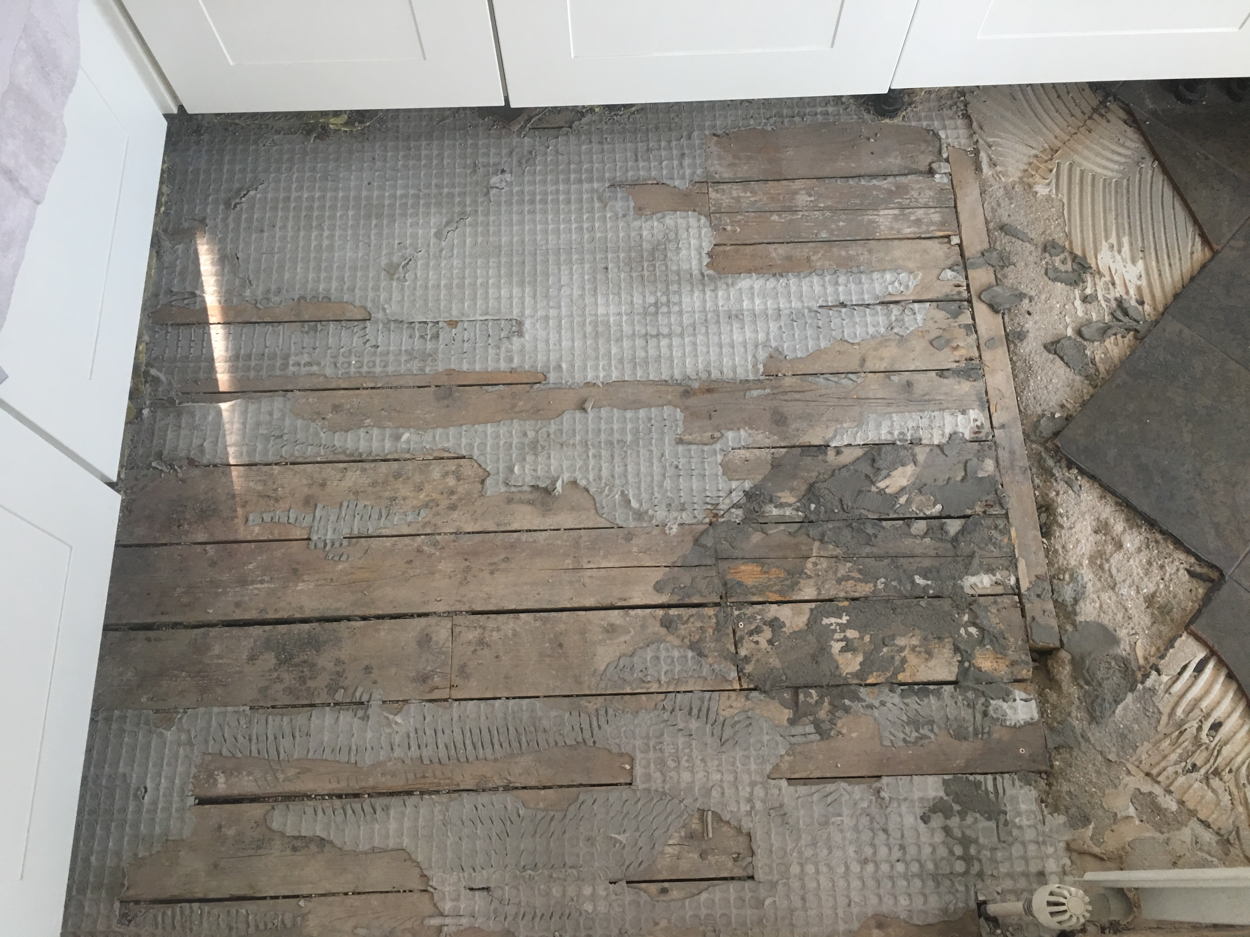

Started a job today and been thrown a few curve balls.

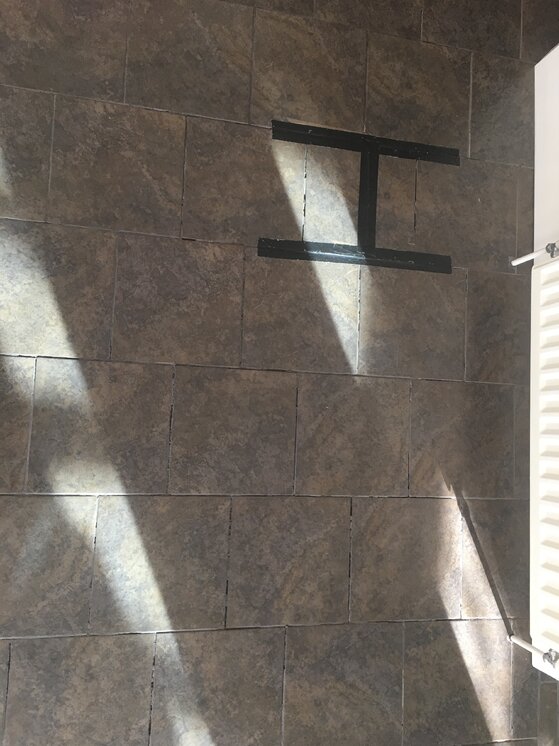

Customer had tiles cracking grout breaking up (builder said he could do the tiling). Customer said half the tiles had been fixed to concert and half to floor boards. Sounded like a simple tear up, secure floor boards, fix Hardie backer and take it from there.

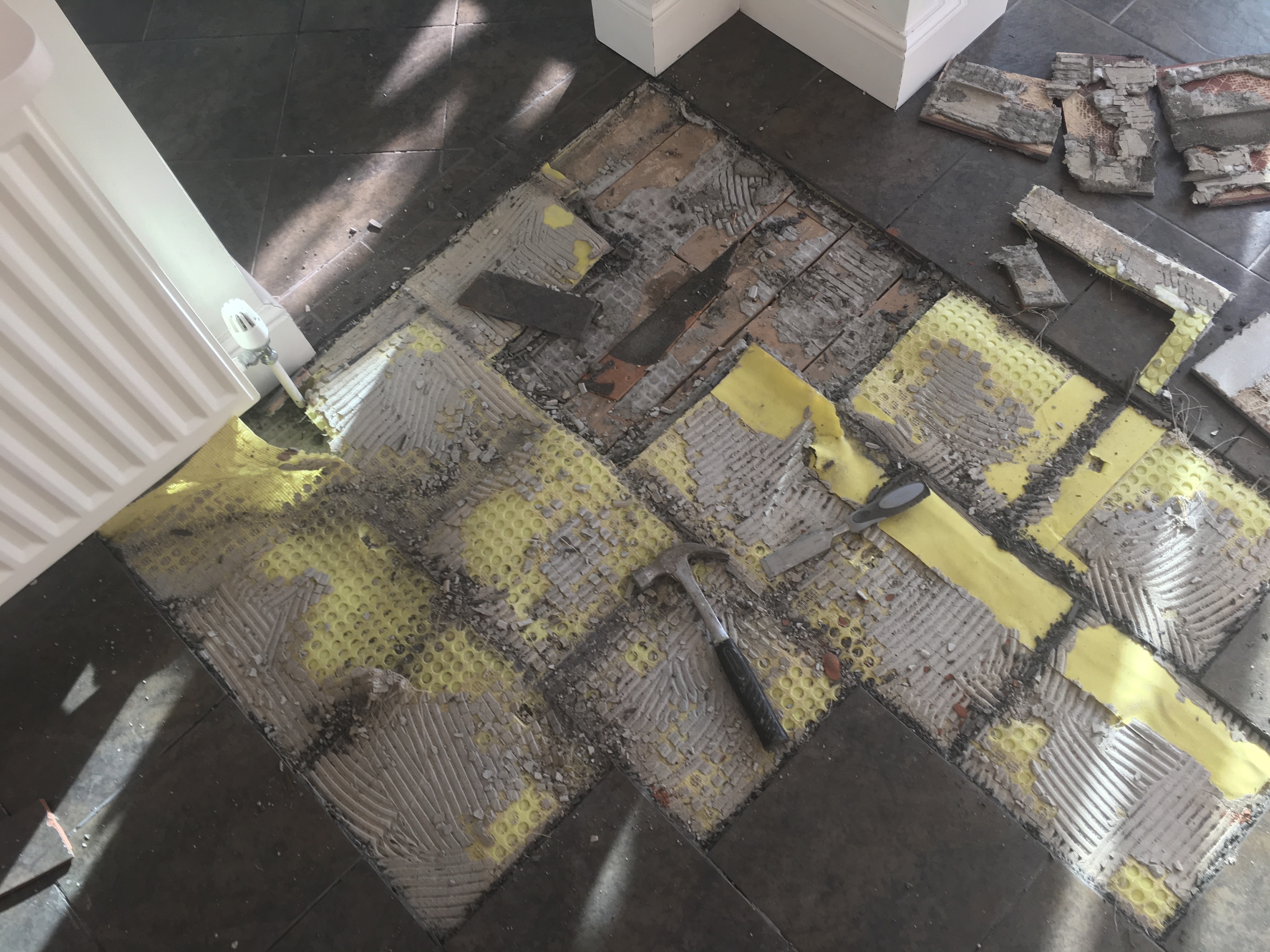

Anyway got there today starred removing ties to find a mixture of matting, no matting, dot and dab, latex adhesive and patched up floor boards with heating pipes practically stuck to the floorboards (also fell through a patched up floor board).

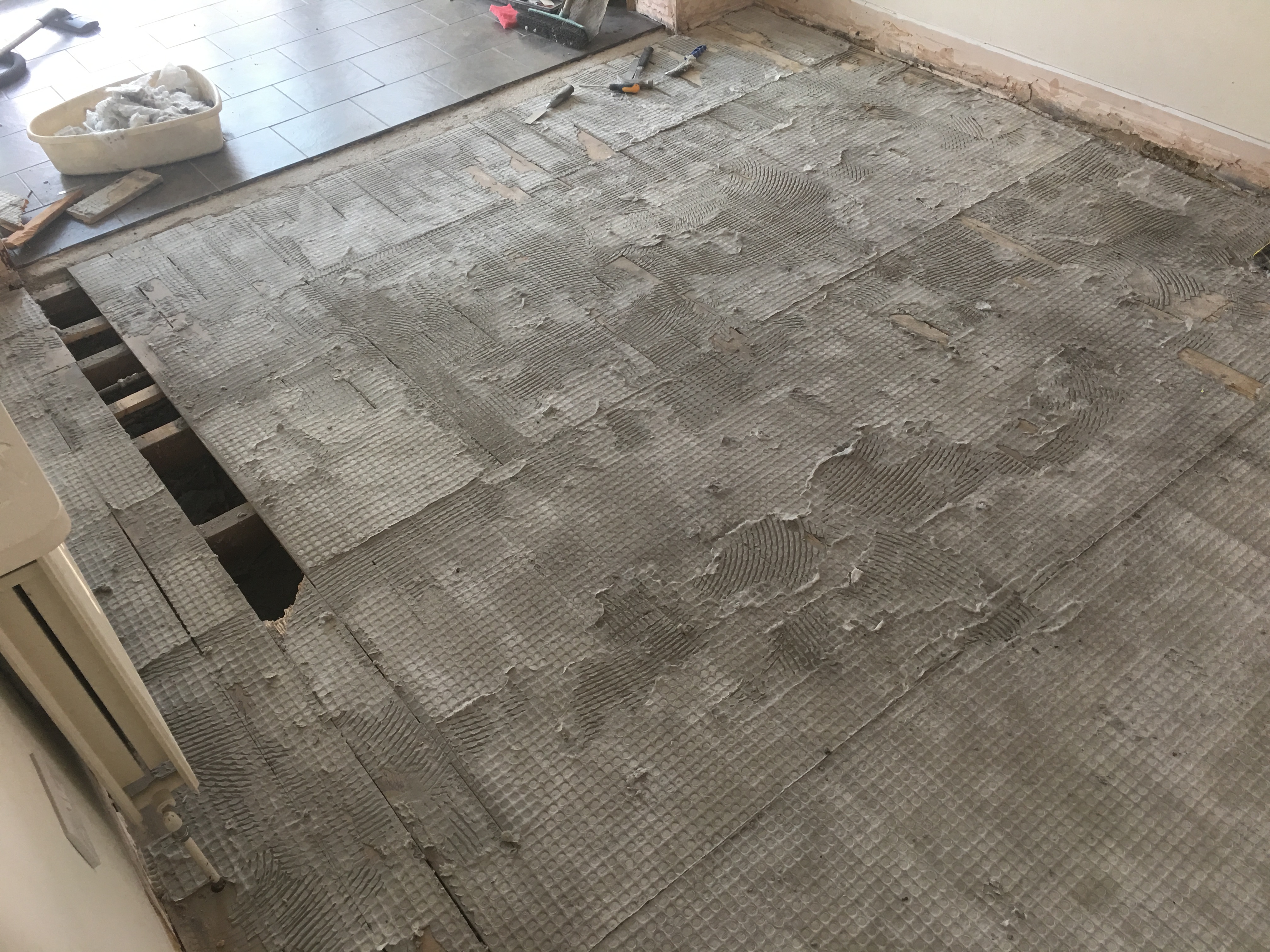

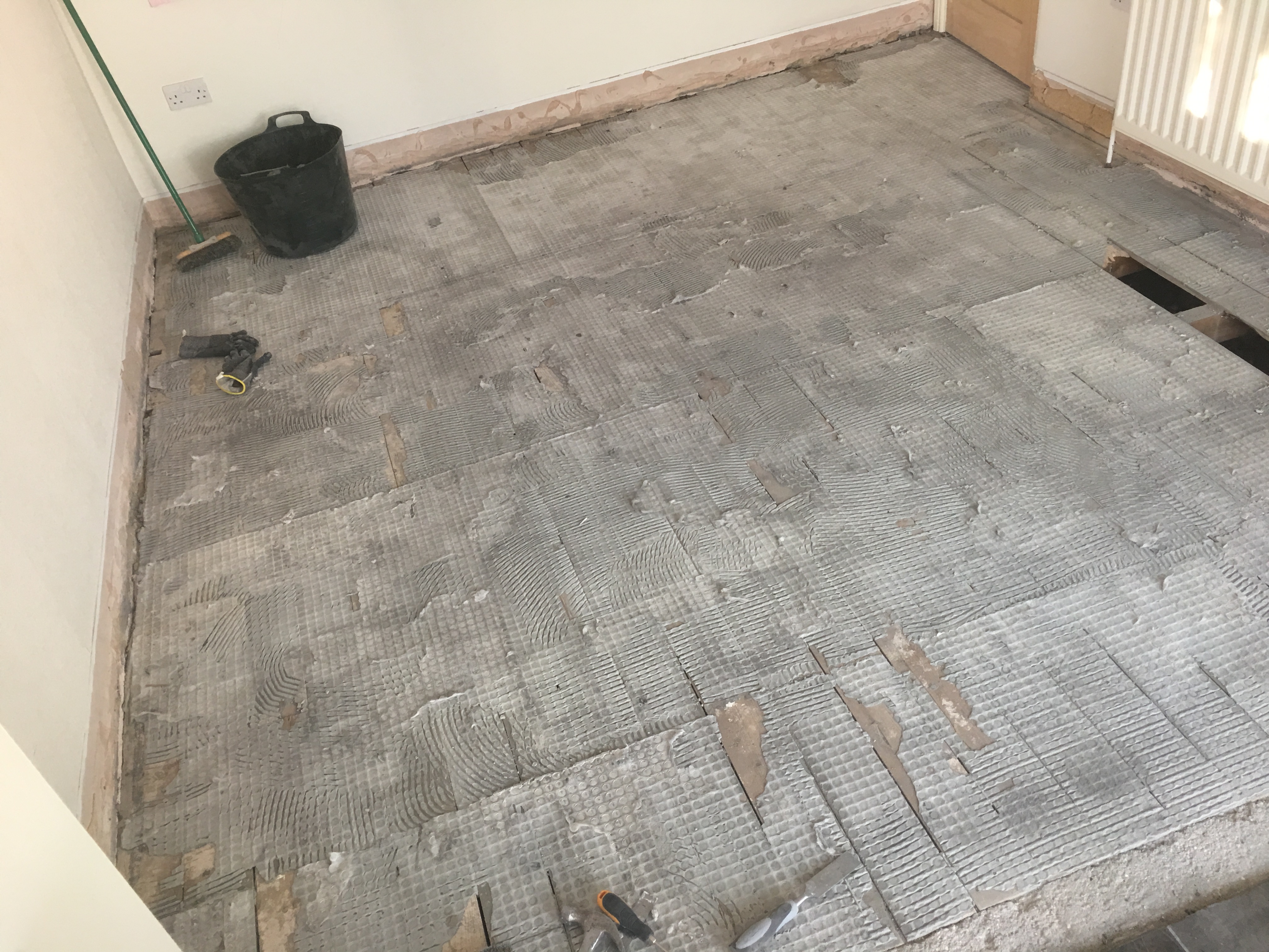

Tiles and matting have now been removed. I am fighting a losing battle removing all the mesh from the substrate.
Another curve ball the customers have thrown is that they do not want an expansion gap. I have explained that BS states.... but the customer is adamant they want me to find a way round it.

Any other thoughts on the rest? Will the remaining mesh be an issue do you think?

Any thoughts on the rest of my prep pal. Im a bit concerned about the mesh.
J Sid
Mesh is fine

check for bounce on the wood floor, good chance to have some boards up and reinforce if needed.

With the exception of a bad floorboard the rest have no bounce but I'll have a good jump around tomorrow to make sure.
