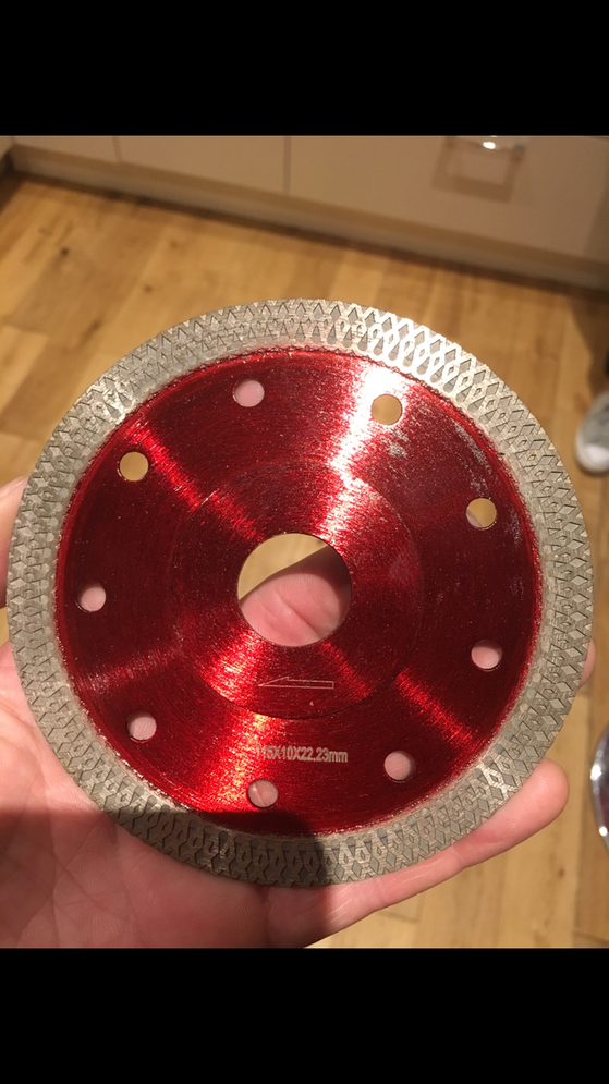

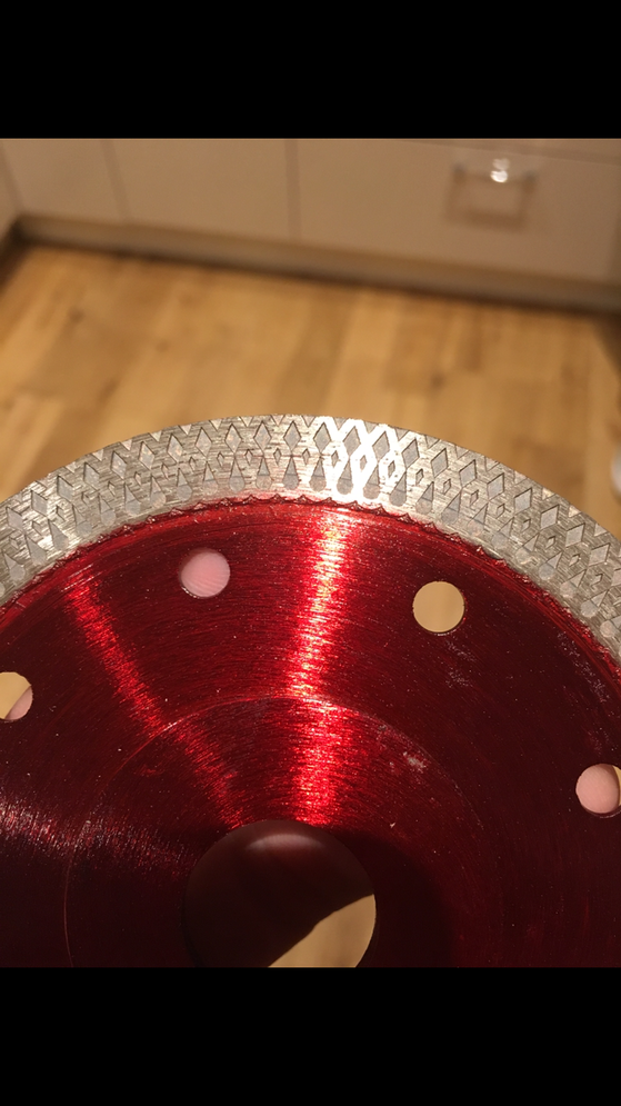

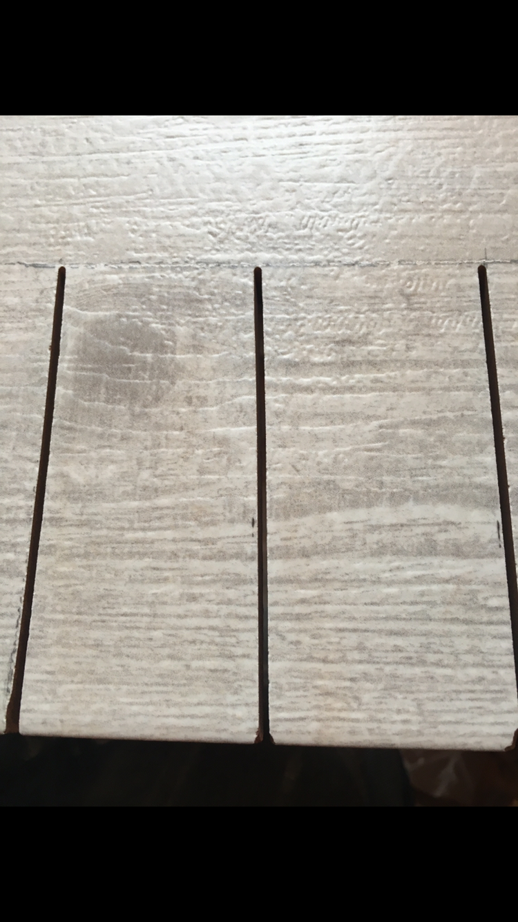

Alan from ATS sent me a new blade to try.
I've only had the chance to try it on ceramic tiles but have to test it on natural stone & quartz to see how it cuts.
On the ceramic it leaves a great cut, I've a slight bit of wobble in my grinder but I think this is the best blade I've used from ATS to date.
Will report back the more it gets tested.

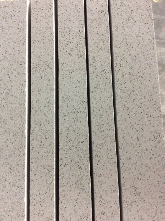

I received one also, I've had it tested on 20mm Quartz, at 115mm might prove restrictive with Quartz because 20mm is about its limit.
However, this is the very first two cuts (2 on right) up against a 150mm segmented blade which is normally used for Quartz.
I had given it to a guy who fits Quartz on a daily basis, his initial impressions were good but was concerned that as it didn't have much width to the cutting blade, therefore he thought it may have problems clearing the debris.
I'll try it on some limestone and Porcel-Thin tomorrow.

Julian I was the same, the 1st cut I stopped & took the grinder outside & ran it through a concrete block a few times, back in the house it was cutting great.
It removes debris very quickly form the cut.
