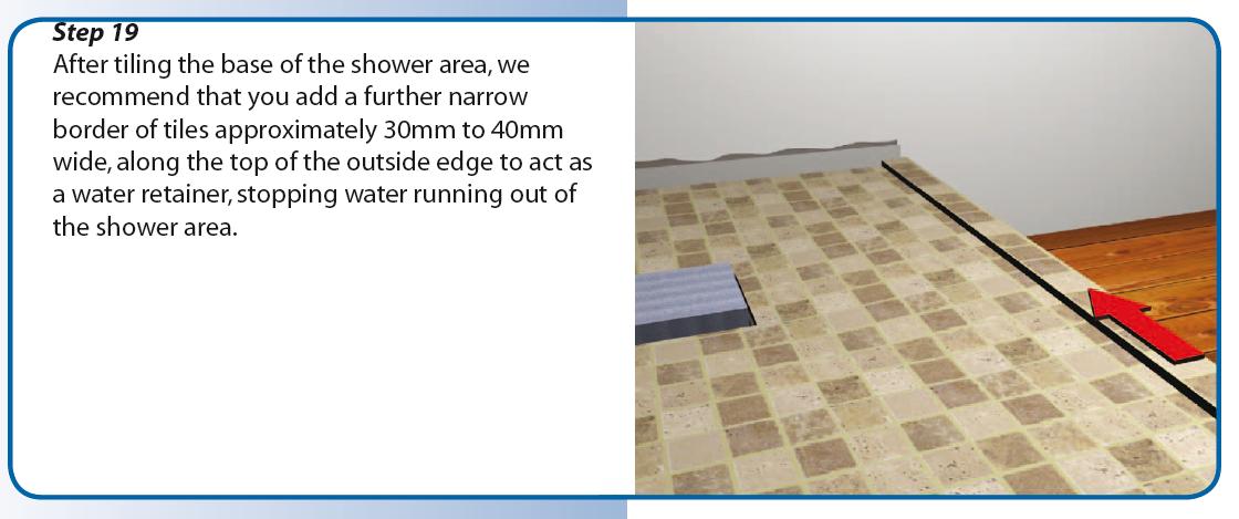

This is what the documentation says!
So that's how you do a wet-room.....i've been wasting all that time forming a floor and putting the right amount of fall on it. When i should have just tiled the floor Flat and stuck something on top to stop the water..... genius! How do B & Q get away with it?
