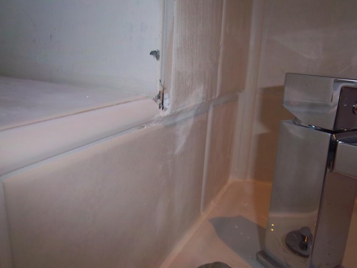

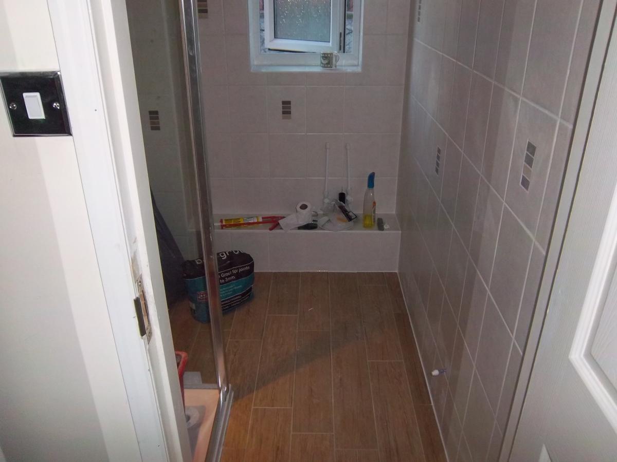

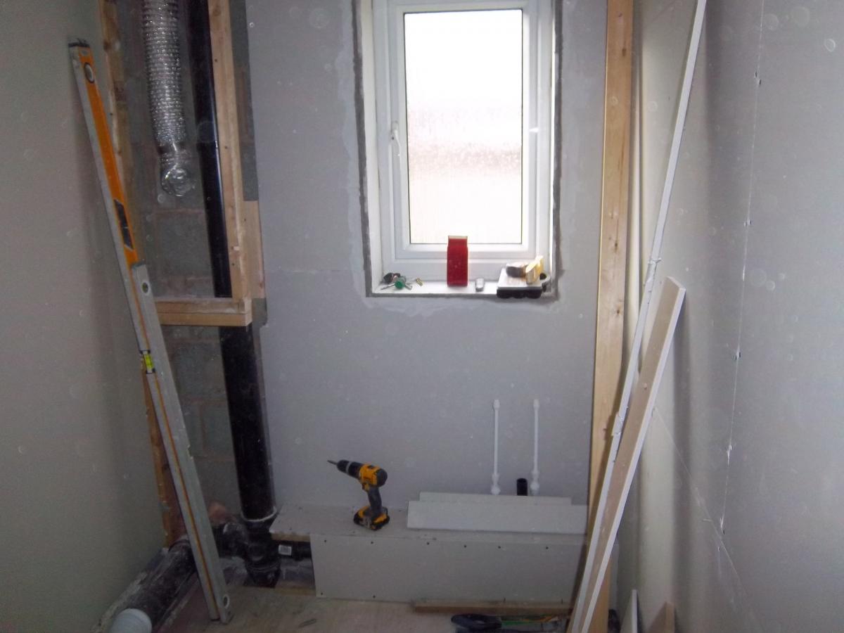

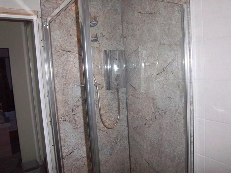

This was installed by a so called tiler/bathroom fitter. As you can see it was all ripped out. The shower trap was connected to nothing so the water would have poured through the ceiling, the shower screen was not fixed together so if the the customer leaned against it it would have separated which would have been very nasty indeed.

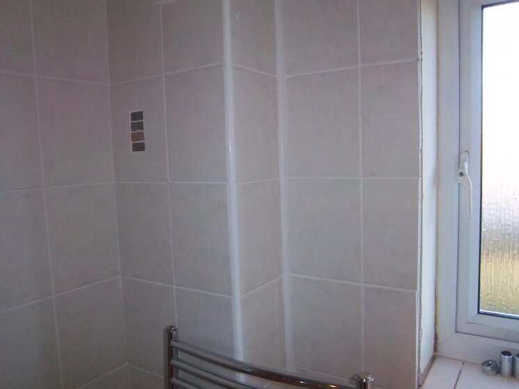

The white profiles in the corner are 20mm plastic? never saw that before.
He tiled straight onto the paint so the tiles just fell off quite easily.

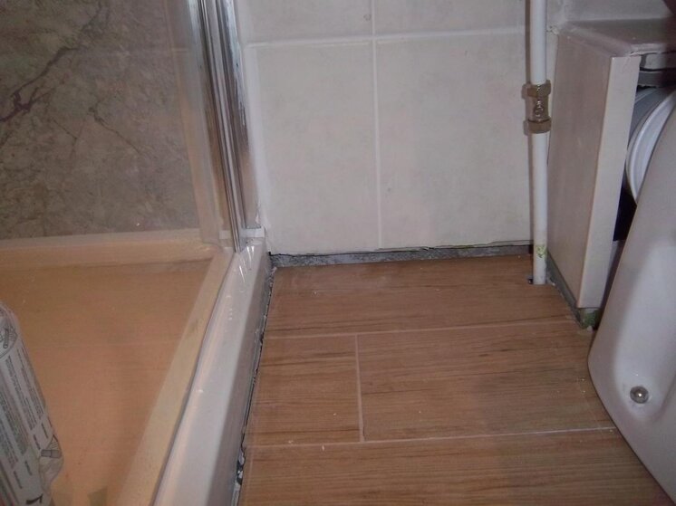

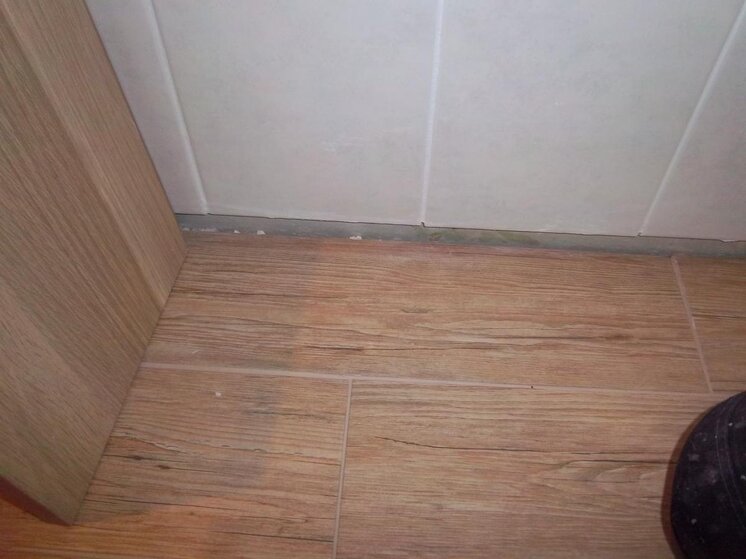

20mm gaps from the wall to the floor, the floor was still wet after two weeks, he used ready mixed adhesive and grouted the same day, knelt in the shower cubicle to avoid kneeling on the tiles.

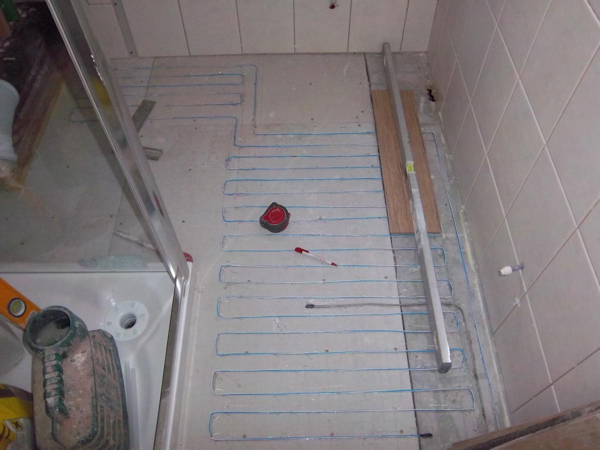

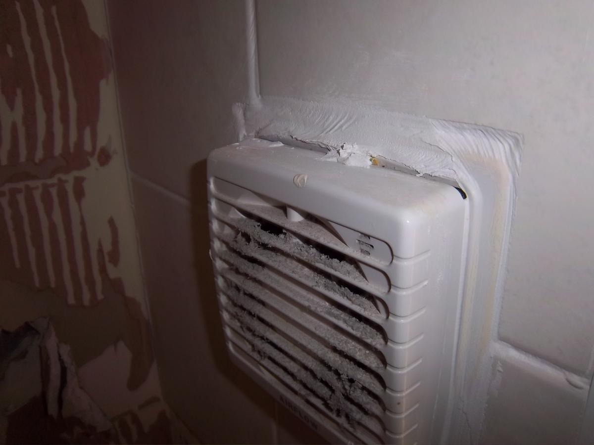

I saved the UFH but that was never going to work anyway as he didn't have a live feed to it nor did he have a switched spur anywhere in sight. Loo was bodged with Silicon as was the trap/waste on the sink.
The floor was not fixed down at all in an area of 3/4 metre, he had just left it, no inserts in his pushfit plumbing, the isolater for the loo didn't work. Plus as a leaving present he used an empty tub of ready mixed as a loo, dirty bugger!

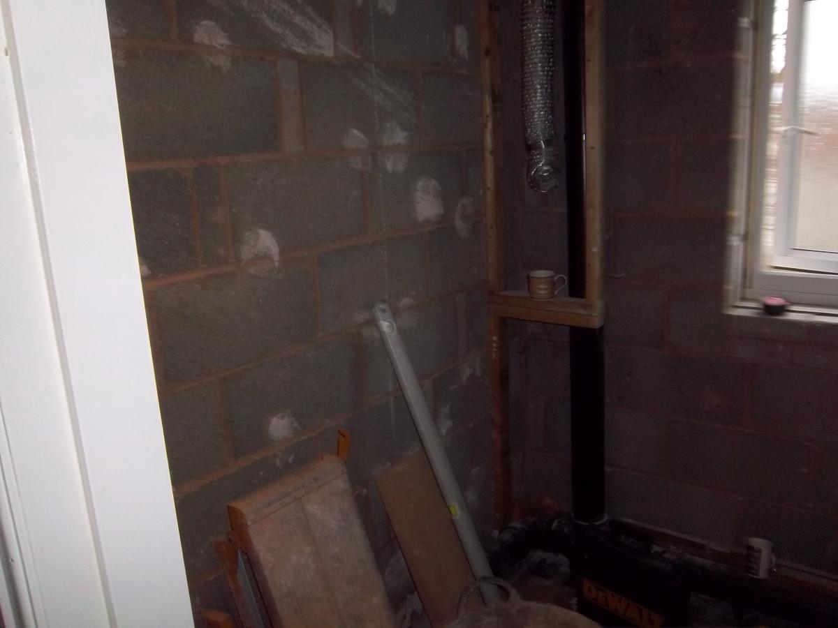

Was the block walls dot and dabbed plasterboard and was they removed....
