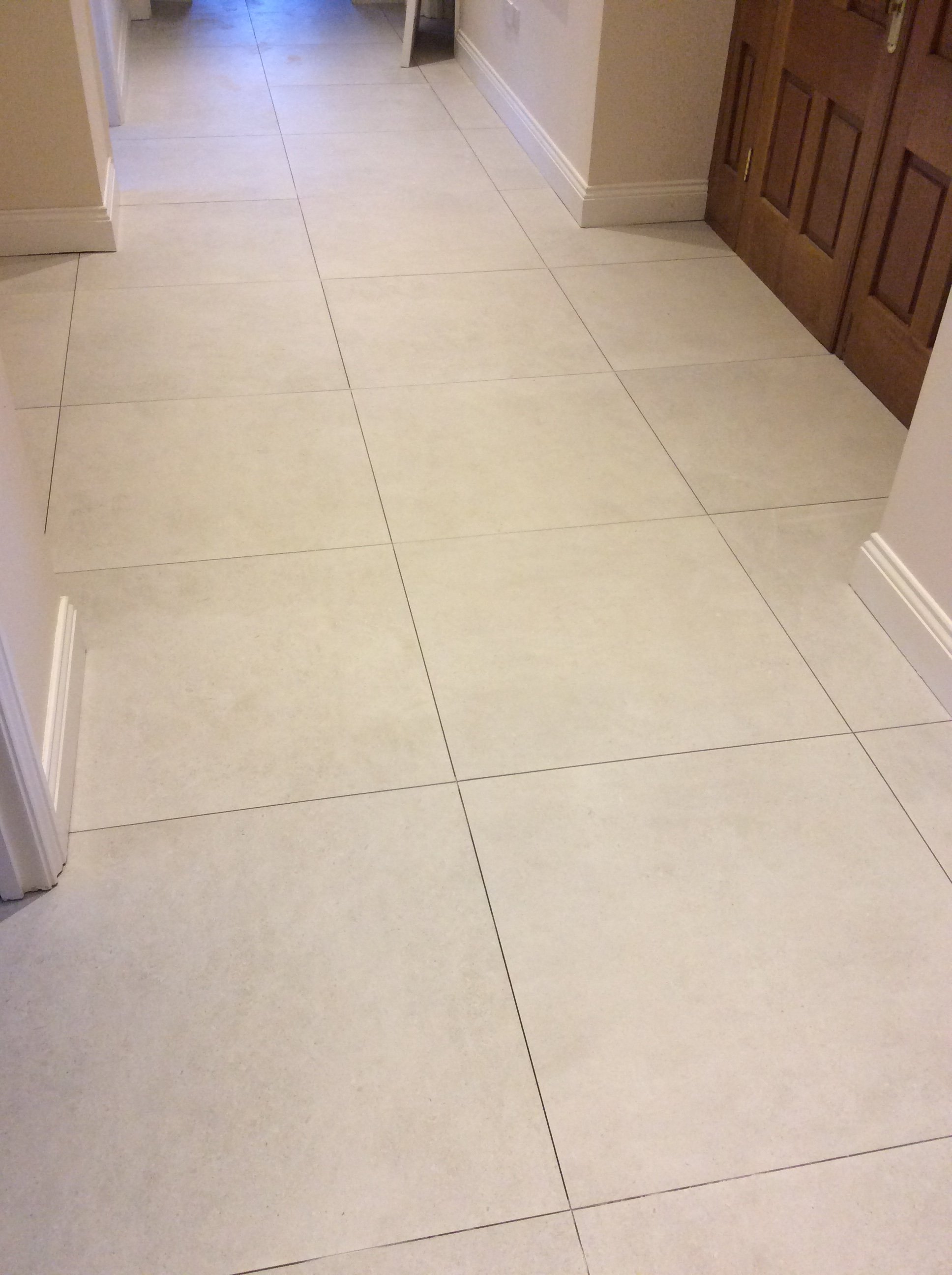

Just laying large format 80x80 porcelain tiles on underfloor heating with 2mm grout line in my place. Also laid on Durabase isolation layer.
Any advise on Grout Type and Colour. My preference is a colour that merges in with the tile colour rather than contrasting it.
The tiles are very light in colour. They are Sinseti Explorer Bianco.
Thx

I like the idea of Expoxy grout in a lighter colour to blend with the tiles, but what about the hardness of Epoxy grout and the tile expansion on to the 2mm grout from the underfloor heating ? Would this cause a cracking issue in grout or tiles ?
