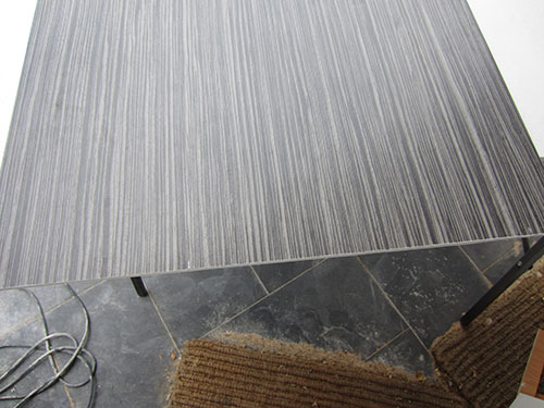

These are the tiles I have chosen...1200x600......:

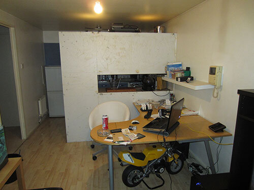

and this is where they are going to live:

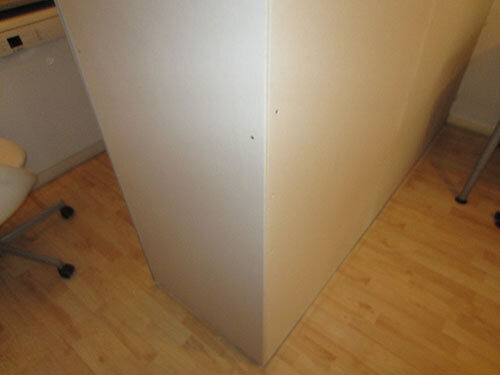

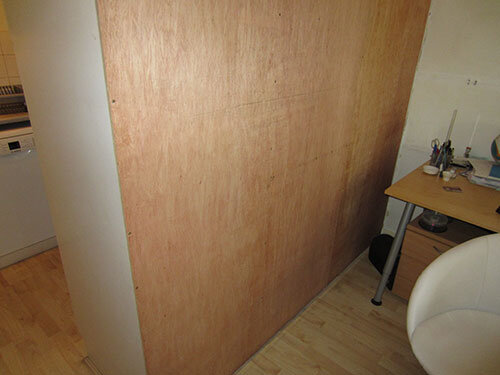

because of the finish I want..... (READ>>>MY WIFE WANTS!)......the void between the units has to go.........so I have removed the conti board and ply'ed over:
the ply is there to give me something solid to screw to after I have installed the tiles....(there will be floating shelf's).........

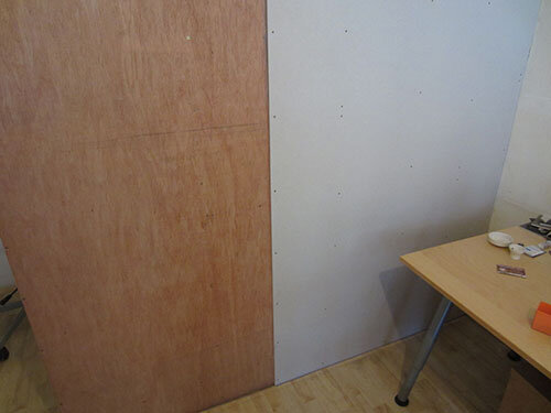

but because I want to fix to something "other" than ply, I have overboarded with plasterboard:

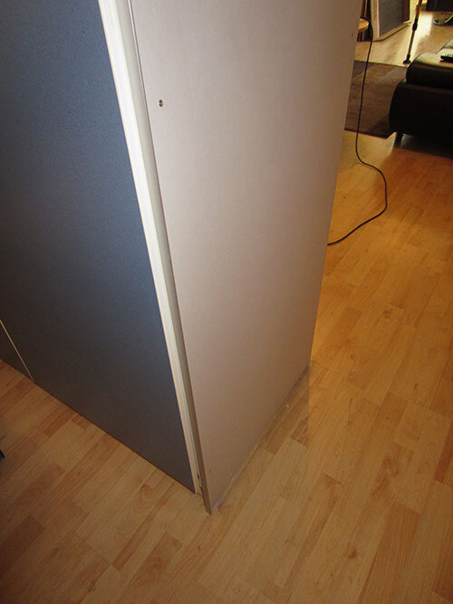

and I have even done the return on the kitchen units:
where the "rough" edge of the plasterboard faces the kitchen I have installed a 15mm brushed ali trim behind the plasterboard and this protrudes about 6mm.....not ideal.....but enough.....(I could only get 15mm trim today!)
and that looks like this:

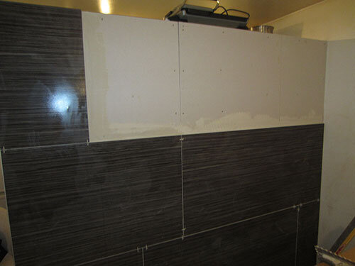

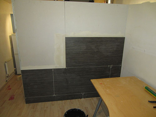

I wanted whole tiles at the top and as many full tiles as possible.....this was difficult due to the size of the wall's.......but I went for it........

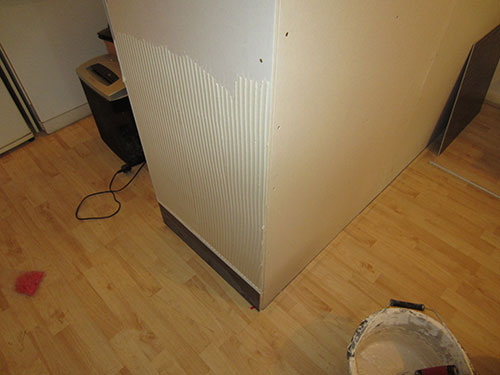

full tiles at the top needed a skirting..........so I did that first:

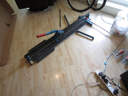

Oh and here is the cutter I am using.......I got it from RAY TT........cut's thes tiles like a dream:
After cutting a tile......I removed the "rough" edge with my new 80 grit polishing disk that Gary the tiler gave me!.....and it worked a treat:
Before:
After:
you might not be able to see the "harris" I have put on the tile.......but basically after every dry cut I polished the edge of the rough cut..........

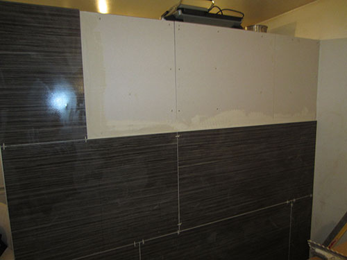

got the side of the wall up........and installed the trim for the front:

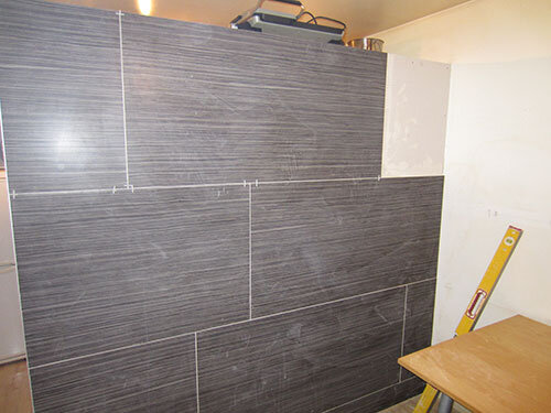

now onto the main feature wall:
after setting out I knew I needed a 14cm (140mm) "skirting" cut......that makes a fair bit of waste out of tiles this size.......but.......it will look the best so.........
I got on with it!!!!!
and here is how it looks from the corner:

I just decided that that will look most "contemporary"....made it up as I went along to be honest Andy.....and I was short of tiles (my fault)..........but random joints was the only really good way I could show whole tiles...
if it was regimented there would have been 3 whole tiles and some large cuts, I know that's fine....but personally I think "mixing it up a bit" has paid off..........
but as you know....."opinions are like bottoms!......everybody's got one!".........

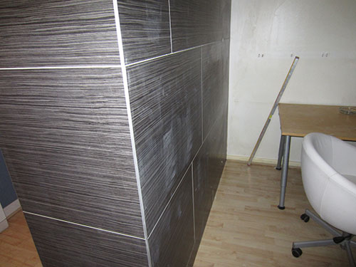

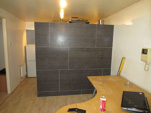

Here is the finished job......grouted up in anthracite..........my wife has had a smile all weekend!!!
Dont look too shabby for a first attempt!!!!!
best wishes
Lee.
