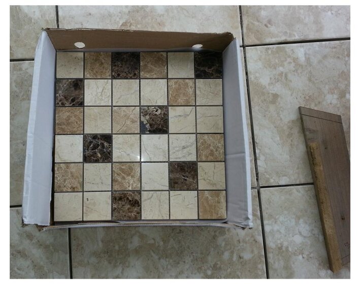

Just staring to cut marble mosaic tile squares – and need to cut them without crumbling, chipping and shattering - if possible?.
These are 300x300 sheets of 50mmx50mmx10mm squares cut into 3 sections of 2 (100mm wide) squares x 6 (300 long) @ 22.5 degree cut with factory plastic mesh on rear. Cost £10.00 a sheet so not cheap (or are they???).
I’ve got 30 cuts to make so need a solution.
I’m using a Vitrex wet saw (yeah I know...buy in haste repent at leisure.....) with a 180mm solid blade.

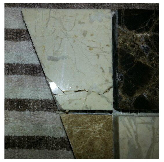

Before cutting I am wrapping the sections in masking tape to stop movement and also using a wooden guide on top to hold them down flat and help with pushing through saw (slow feed). In addition to this they are all being fed in shiny side up so the cutting direction is downward. Despite all this I’m still getting chips/fracturing and for 6 cuts made so far had had 2 of them fall apart once tape removed.
Is this what we have to live with when cutting these or is there a foolproof way of cutting?

Done that - not happy with results - blade is a 1.8mm in both grinder and wetsaw. The saw is getting a good cut using a guide it's the crumbling thats killing me.
Looks like they are breaking along the fissures, you'll be hard pressed to stop that if they're that brittle.
