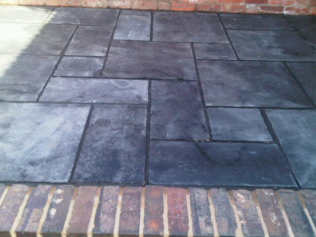

Just had 45m2 of black strata limestone laid, we cleaned it last week and allowed it to dry and then sealed it the next day with Thompsons clear limestone sealer, it dried for about 6 hours and then came the rain. I have now a patio covered with what looks like white salt marks and it looks horrendous. I called back the guy who laid it, who brought round some patio cleaner that contained acid, we tested a couple of the slabs, seemed ok so proceeded to do the top end of the patio (where the shed shall be laid) it has now taken the colour out of the slabs and left them greyish white. What should I do next?
Hi lucy..
It is water bloom... and needs removing
but the use of acid will make it worse.. and grey the slabs..
You need to use LTP Grimex and give the slabs a good clean.... then leave to dry , once dry then use 2 coats of LTP stone oil and then 2 coats of LTP colour enhancer , this should give you a really nice finish.
Thanks dave for your speedy reply, when you mean the colour enhancer is that the intensifier or the mattstone product? I notice there are 2 mattstones one with H2o so which is best to use? As I mentioned we only applied the acidy stuff to the top area of the patio which seperated by a step from the bottom half of the patio, which we also sealed and has the whitemarks on but we didnt put the acid cleaner on this bit thank god, so this part of the patio still has the thompsons sealer on it with white marks, should I treat this area the sames as the top area? Its only the top area of the patio that we cleansed to see how it would come up and this is where the limestone has gone grey so the process that you have mentioned above should i do it on the whole of the patio regardless? It has cost us £4000 and at the moment I feel distraut with the whole thing, I feel as though it is ruined, I wanted to post some pictures to show you but not sure how to on here
IMG00378-20110701-0755.jpgIMG00373-20110629-0806.jpgthis photo is how it looked before with marks on
this is the top bit of
patio that we cleaned

hi Dave, much appreciated, please can you tell me what I should be applying to the top patio thats has been sealed, then went patchy and now has been washed with acid and lost its colour and B, what i should do with the bottom patio that was also sealed at the same time but is covered with marks also but hasnt been washed with the acid. Plus the method, pulling my hair out! I have located a place close to home where I can get the products, thanks Lucy
