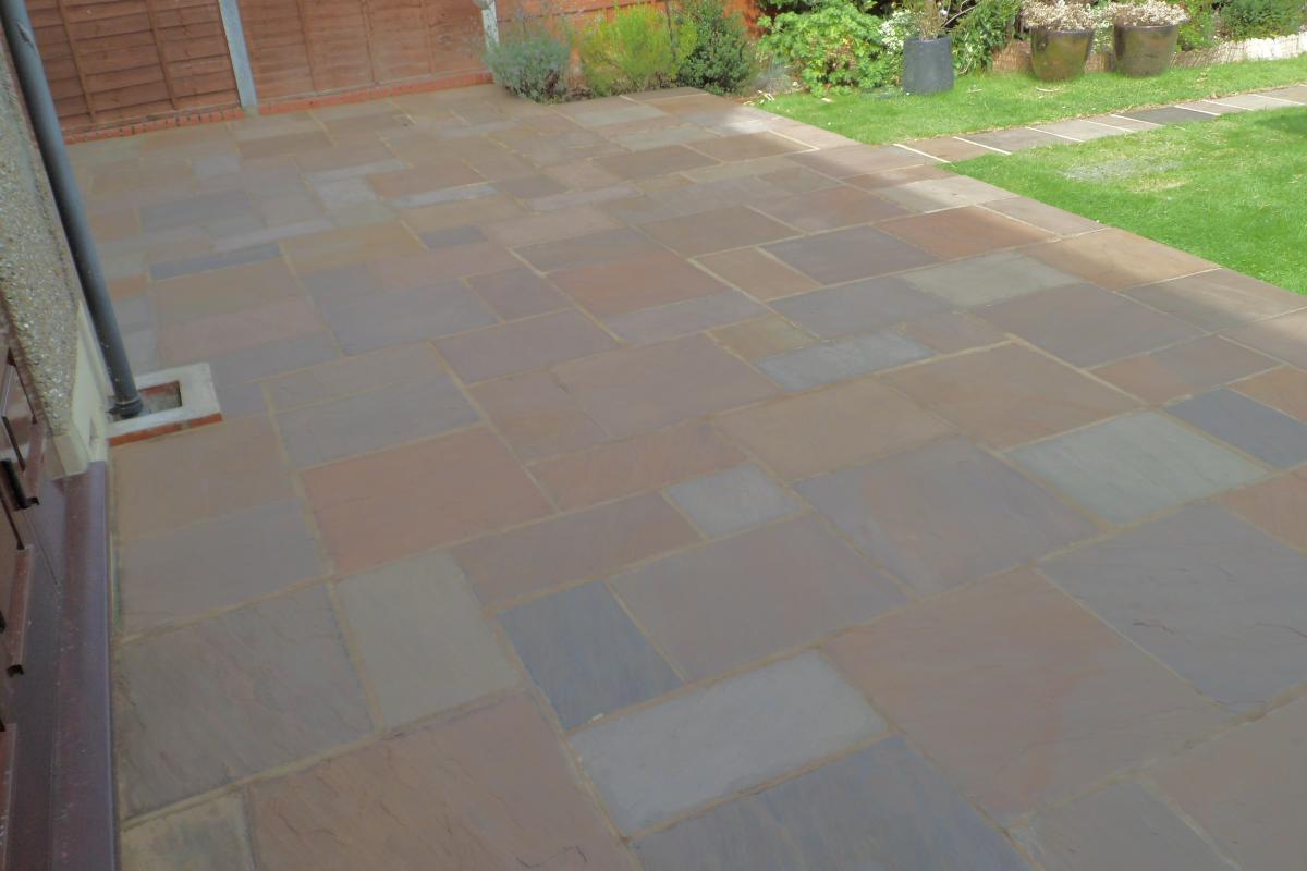

Just a follow-up. I did use the LTP Mattstone and it has brought out the colour very well without making it look shiny.
I gave it three coats to be sure using about 8 litres for the 9x5m area.
The one unexpected side-effect is that now it is sealed, any rain or spilt water now sits in puddles or droplets for ages on the surface (it won't all drain away because of the undulations in the stones).

any pics.. 🙂
Best I can do - I'm not sure it shows the effect though.
