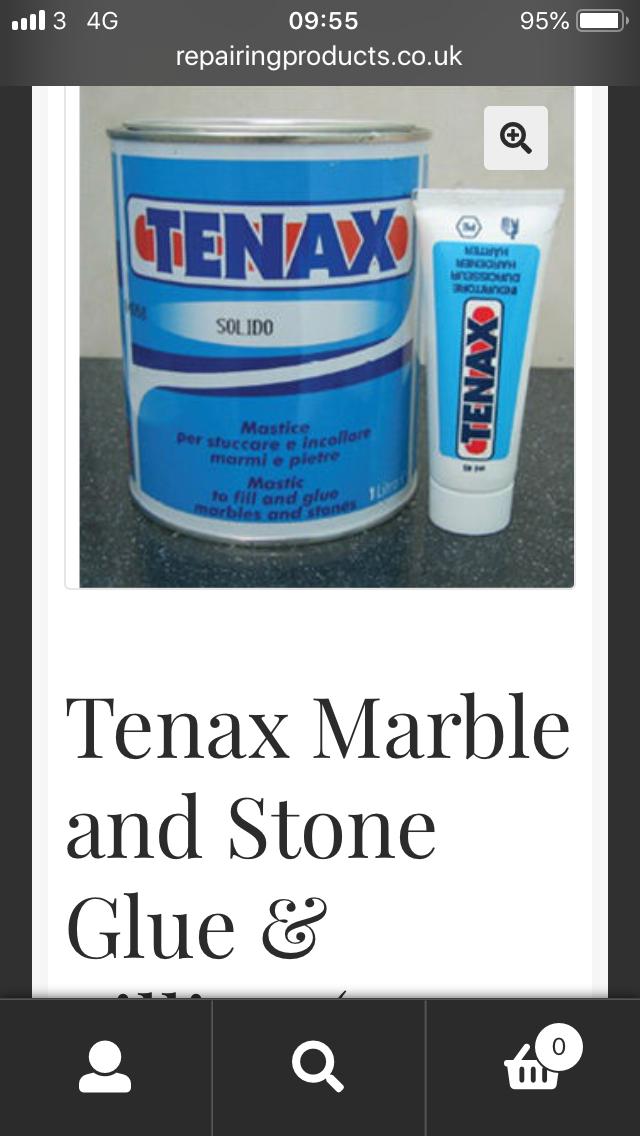

I have used colorfill on a floor I had once, although there are specialist products that can be bought for around £15.
I use jolly epoxy stone filler (straw or light straw colour depending on colour). Very similar to Tenax. Got a trav hole filling job later in the week as it happens
