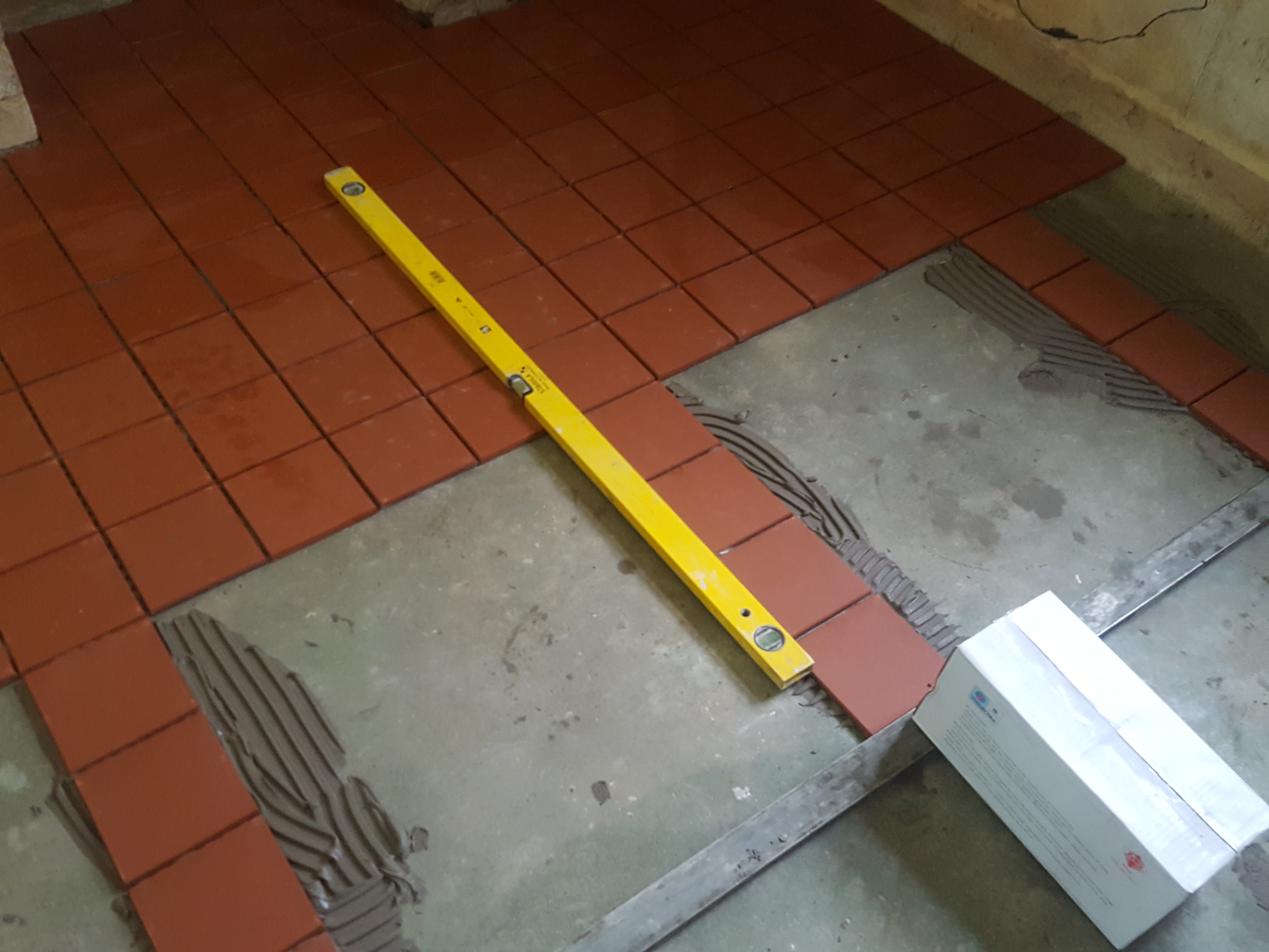

If you do that size area in bays it won’t matter much how good/bad tiles are.
Did a small kitchen floor with these last year and they're not a bad tile.
Topps told customer they are pre sealed but they aren't. They are covered in transport wax that you'll need to strip off before sealing.
John please explain how a bad tile looks OK in bays? Sorry I can't get my head around your answer?
Macten that's not good, I I was also advised they were prepared sealed!
So for that much area would you reseal with a buffing machine before grout?
Cheers both.
Tiling in bays to keep the tiles straight and square....
If they need sealing, probably a roller on a pole and plenty plenty plenty of Lithofin sealer.
