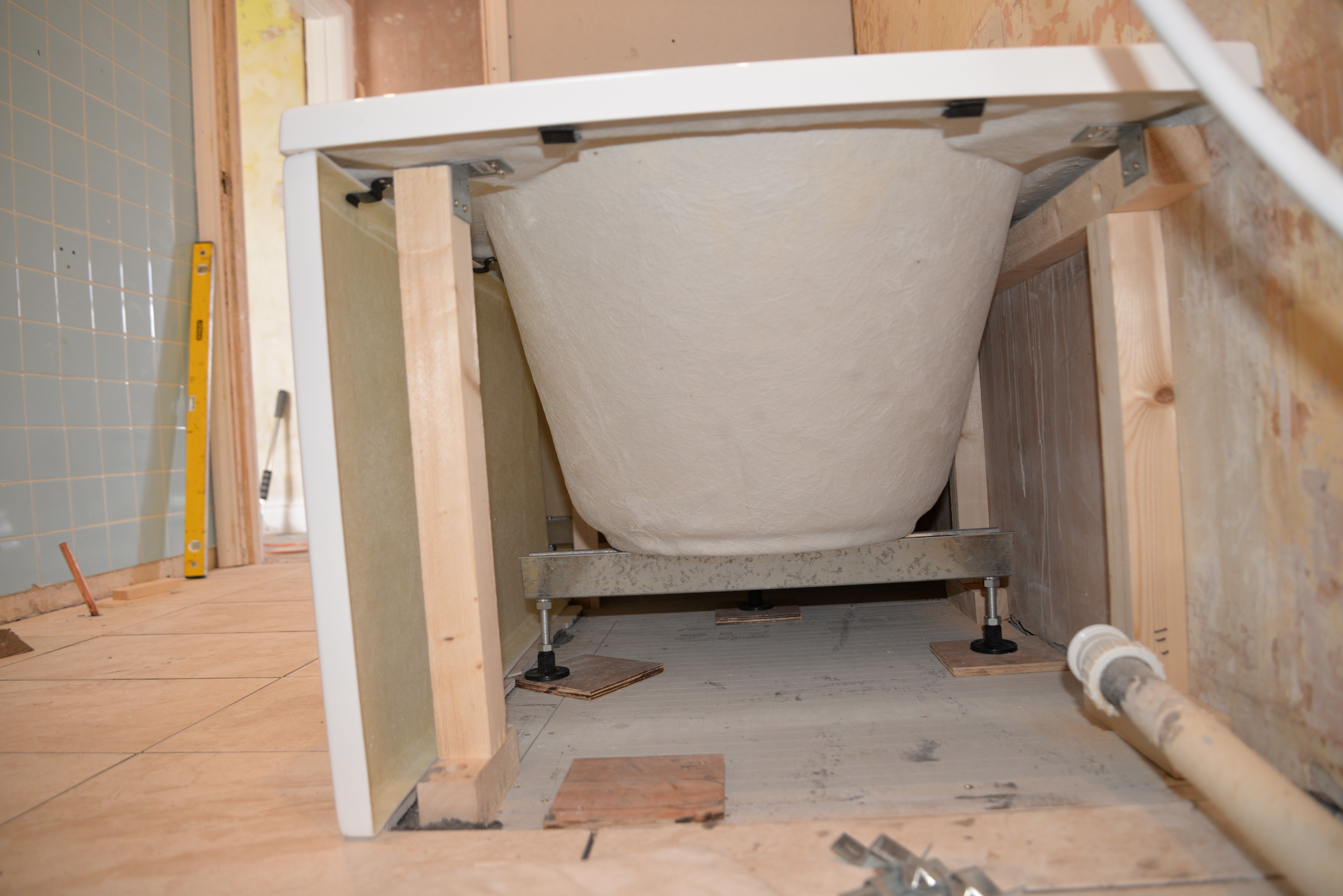

Fitted the bath today, its sitting on wooden battens and wooden uprights, there is absolutely no movement and the levels are spot on. With the bath being supported by the wood I then lowered the five feet to touch the floor.
However a slight issue, with the side panel fitted there is a gap at one end of approx 14 mm and at the other end its 20mm, so obviously the floor isnt level along the length.
How do I overcome this situation, is it permissible to put down excessive adhesive to level the tiles out to be even along the length of the panel?

Yes bob - 6mm will be okay to pack out but you're doing it the hard way! When using bath panels you should tile the floor level first and then fit your bath to desired height to remove all these headaches. In my experience you'll struggle to get it perfect doing it your way.

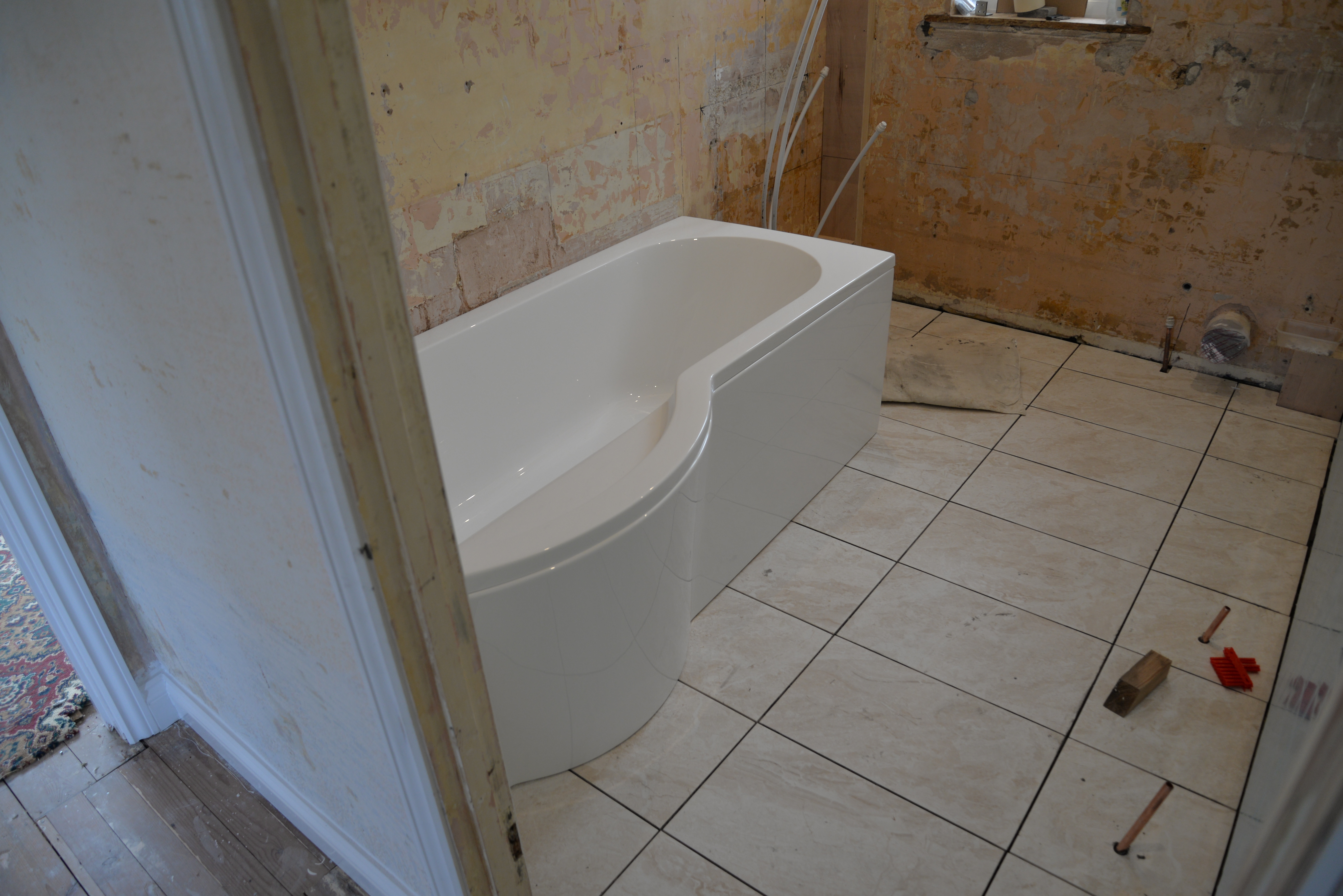

Having never tiled before this tiling lark is a big learning curve for me, I did as suggested by macten and removed the bath and laid the first row of tiles along the panel length and tiled out from that. The result although not perfect is acceptable in my opinion. Thanks for your help with this.

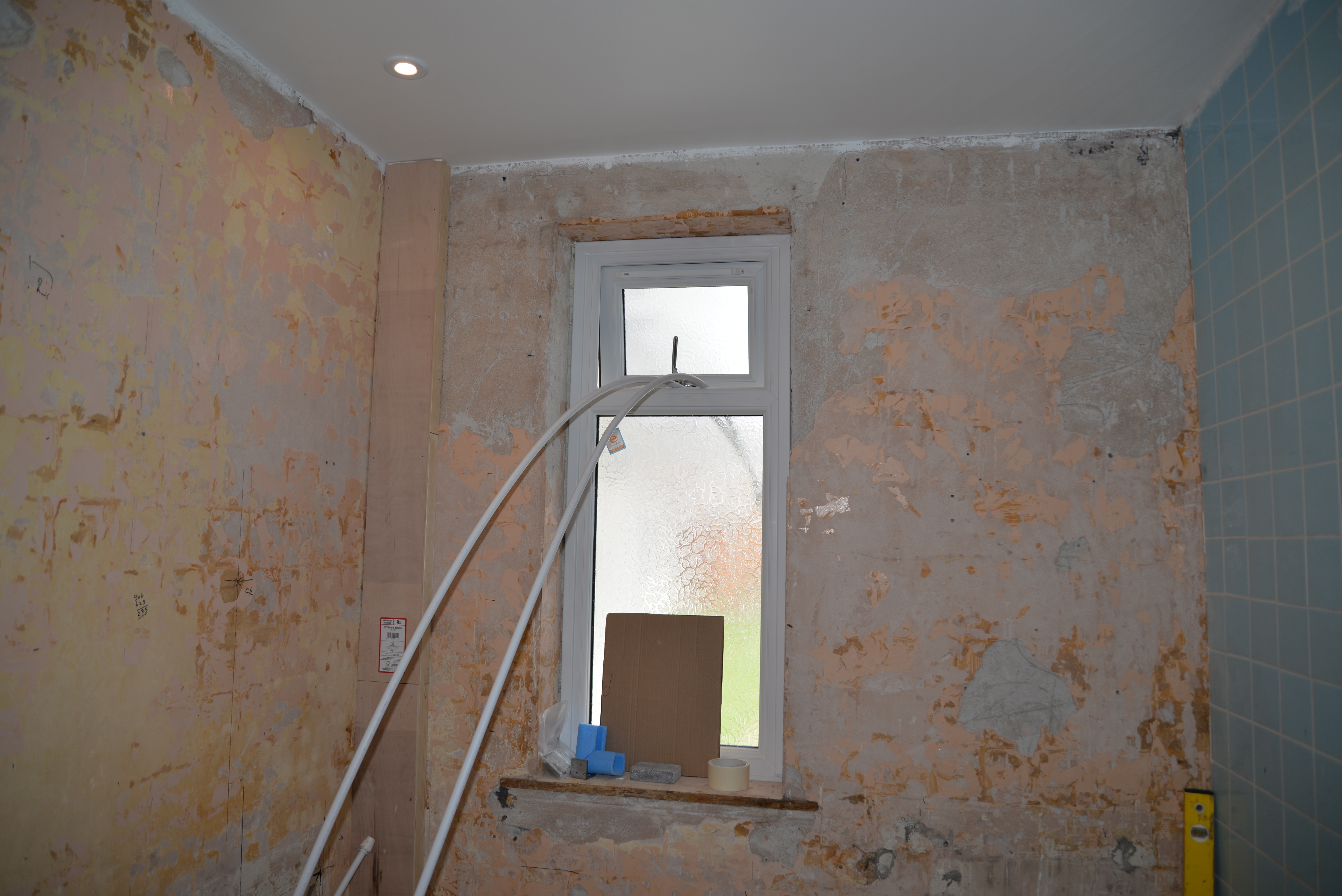

Ive attached a pic of the walls that I will be tiling next, all of the wall is rock solid apart from a small bit up by the ceiling, Im reluctant to overly remove this bit as it will disturb the newly installed overboarded artex ceiling. Any suggestions about this please.

What white grout would you suggest I use on the floor tiles, read on this forum that white can become grey--
The blue tiles are staying and I will over tile them, not sure what they were attached with but they are welded on, I intend using Mapei Eco prim grip.
