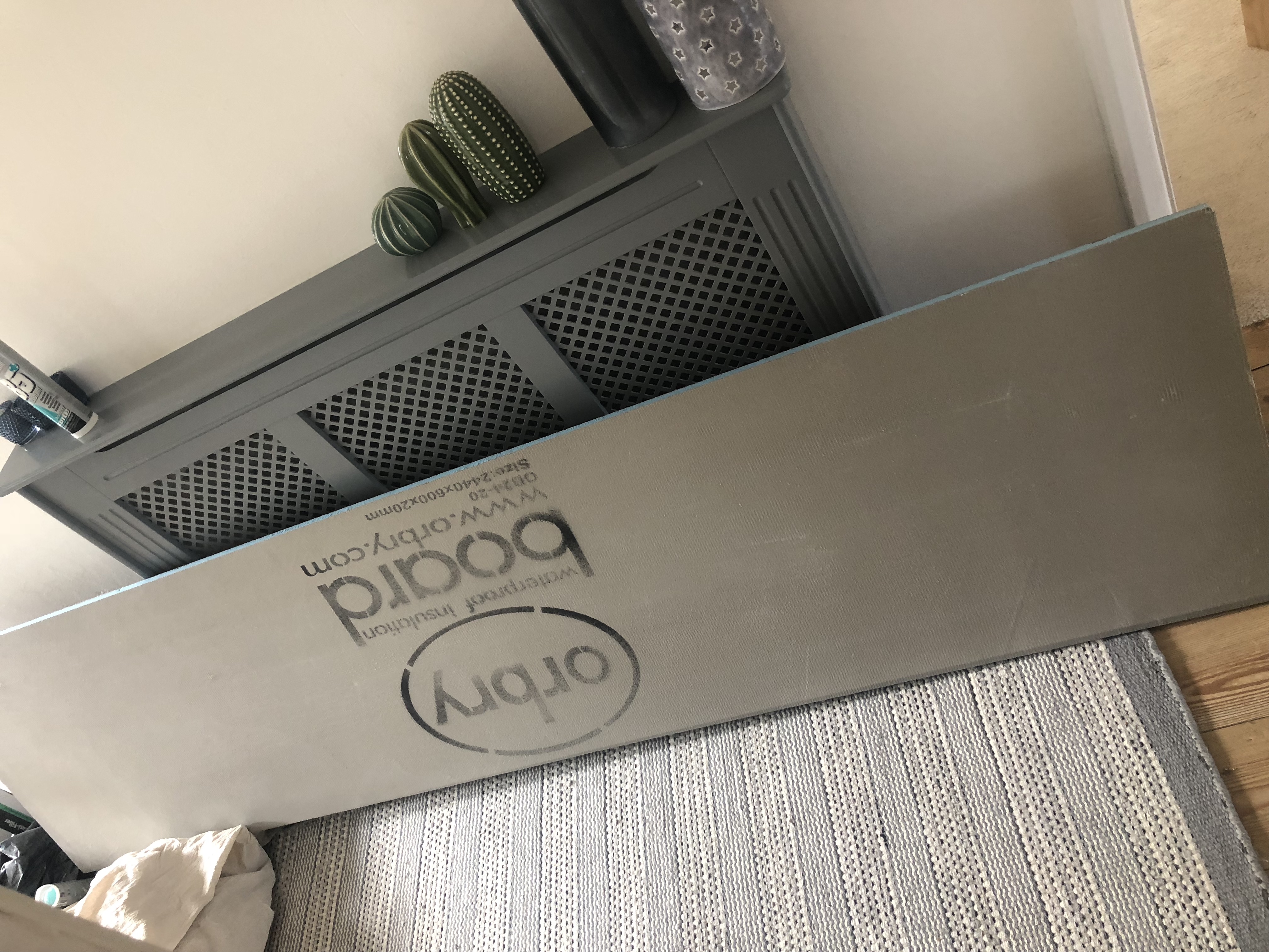

I need a recommendation for a bath panel sized tile backer board.
Only slight issue is that bath is extra deep. Floor can’t be entered to get any extra depth for waste and lip of bath will sit at 61cm. Meaning panel needs to be approx min of 58cm.
Any recommendations greatly appreciated.
Orbry....
I tend to bond a couple of pieces on the back for extra strength.
Any ‘long board’ will be plenty long enough. No need for joins.
Orbry is 2440mm x 600mm
I’ve got a pic somewhere hang on
