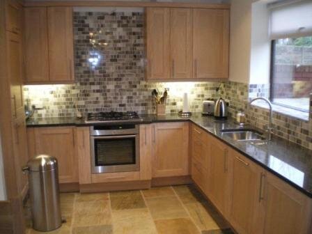

I laid these a while ago for a customer and used sandstone grout. floors 002.jpg

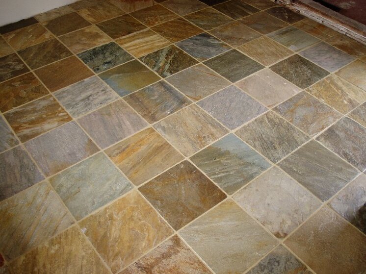

Some slate I laid a few months ago 600x300.

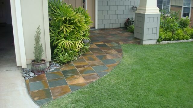

Here's some 300 x 300 chinese slate laid in half bond (brickbond) that I did a couple of years ago......

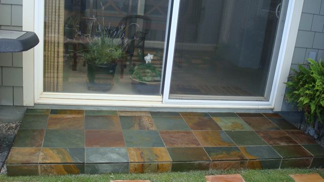

This is some 12" x 12" (300 x 300) slate for an exterior entrance. Used grey grout.
I would seal after laying tile but before grout, then again after grouting. I like to use a color enhancing sealer. Brings out the color of the stone nicely.
Side note: We can get away with slate exterior, but not all slate is good for exterior use in freeze/thaw climates.

Homza, the enhancer on that slate really does bring the colour out, I like it 🙂
