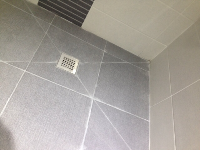

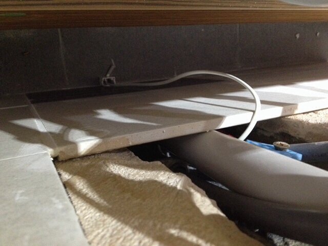

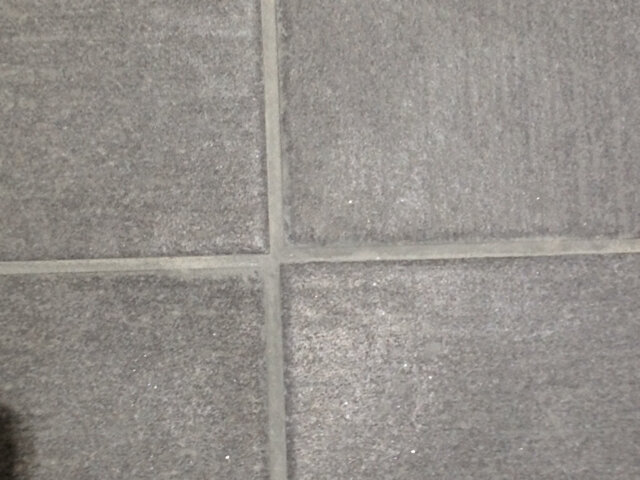

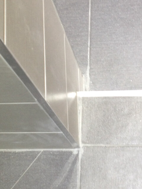

Called by a couple to inspect their recently installed wet room. A plumber who decided to turn his hand to wet rooms led to this mess-
ImageUploadedByTapatalk1382999887.964134.jpgImageUploadedByTapatalk1382999904.158384.jpgImageUploadedByTapatalk1382999919.818011.jpgImageUploadedByTapatalk1382999934.839787.jpgImageUploadedByTapatalk1382999947.053621.jpgImageUploadedByTapatalk1382999958.161268.jpgImageUploadedByTapatalk1382999971.854395.jpgImageUploadedByTapatalk1382999981.792728.jpgImageUploadedByTapatalk1382999991.746854.jpgImageUploadedByTapatalk1383000002.578116.jpg
Nothing good to say about the work! Lippage, messy grouting, uneven levels, bad cuts, no tanking (still wrapped up in spare room) spot fixing, poor layout plus my favourite......UFH sensor cable that he was planning on taping on top of the tiles!!!!
Returning in the new year with any luck to rip it all out and start afresh 🙂
I have been there today working for Geoff and I have never seen anything like it. I know the plumber who did the work from a previous job...and that was a nightmare to tile after he had laid the floor and wet room tray. It is truly unbelievable.
