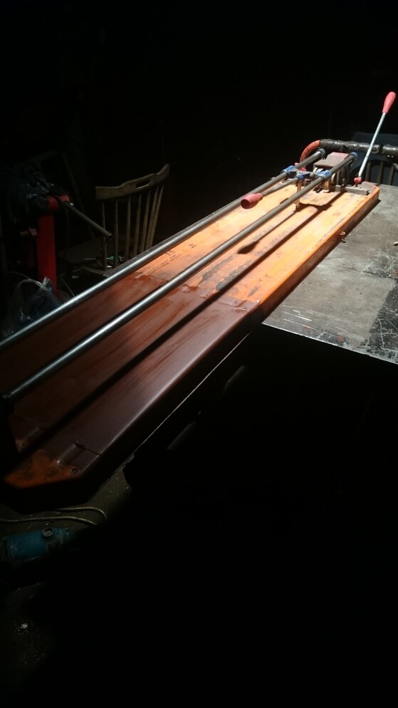

I would like to introduce the first prototype if an extention to your rubi cutter, with the size of tiles these days its hard to keep up with the ever growing porcelain we have to tackle. Pictured here is my permanently adapted Tm 90 into 136 cm cutting it will cut a 1m square tile diagonally, you can transform your older undersized cutter with an easy to assemble kit , I will be looking into sourcing some quality materials to produce a kit that is removable but heavy duty. Id like to see if any body is interested
Does it cut straight ? I had a tx 1200 and the bars used to bend when I scribed the tile the result was when I placed the cut tile against a straight edge it created a curved cut ,I like the idea of your prototype
I think its going to have play in bars whether you pay £600 on TX or just extend your 90 but with a straight arm and nice fresh wheel it whips it nice, its more of a get out of the problem of planks at 130 idea, im currently doing 120 x 60s and its gotten me out of the s##t
