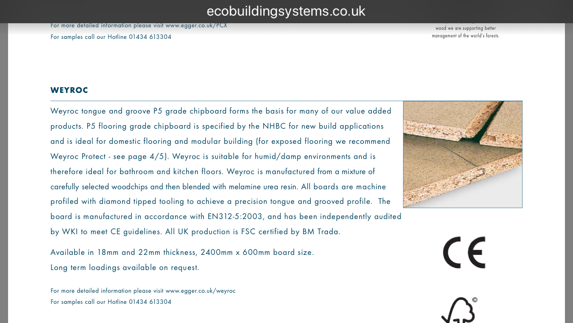

E292A863-CC4B-450B-99CD-BF147FC5B914.png Was using ‘weyroc’ as the generic term for chipboard!

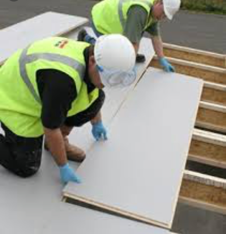

B8504B66-B1B9-44F2-9F03-182203B3CF44.jpeg I didn’t mean to disagree with you John. Over here when we speak of weyrock this image that I pulled of google is what people think of, but then as I’ve said before we are in the dark ages here with some things.

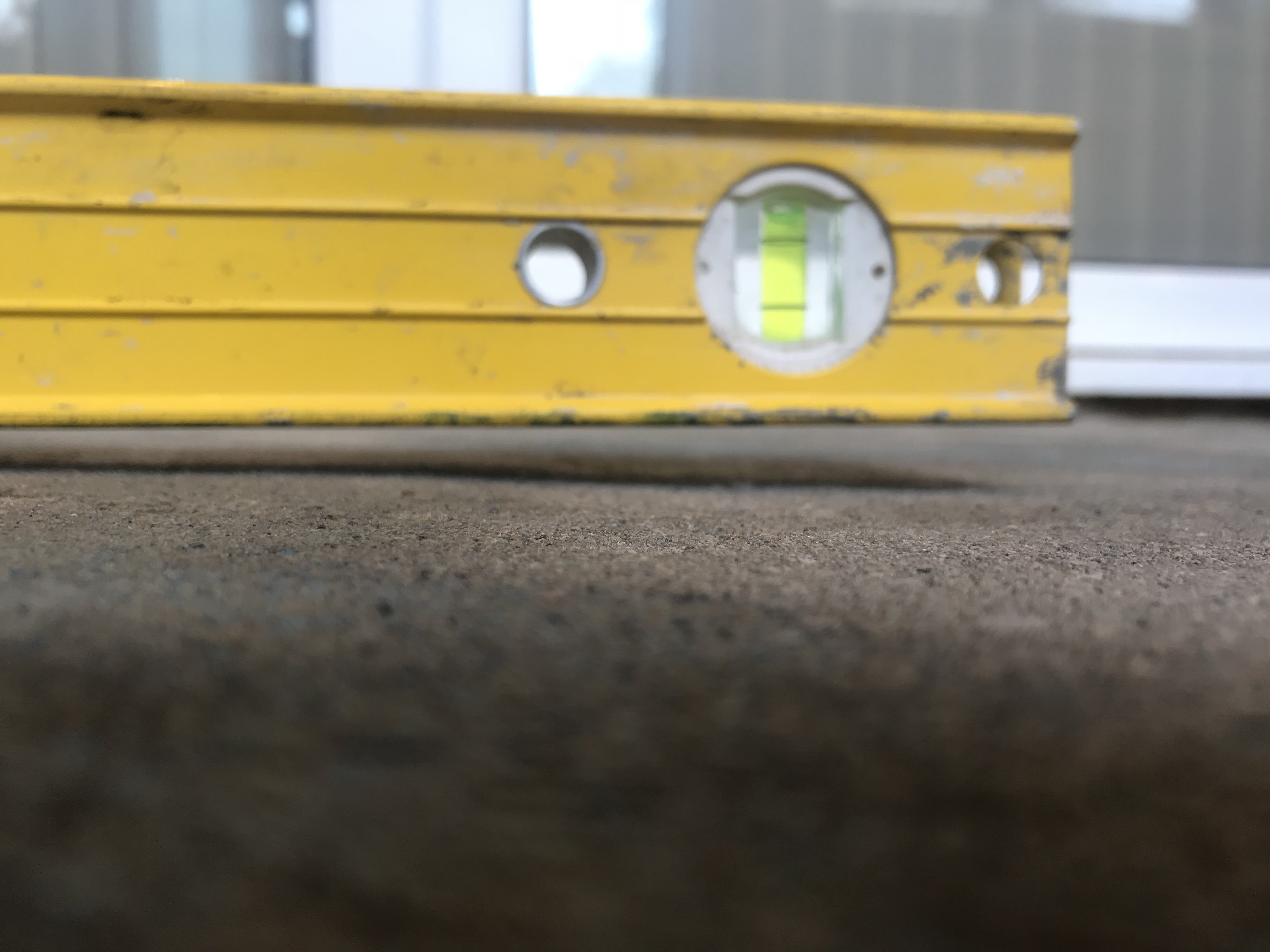

It’s inexcusable. Same screeners did a limecrete screed I tiled a few weeks ago and that was even worse but they said it was difficult to work with, but this, it doesn’t get any simpler.

We have the same weyroc waterproof coated flooring on new builds here as well - taped and tiled one years ago but it popped within a month as I told them it would! Fortunately it was a private domestic for a valued customer so redone at my expense.
Always overboard everything!!
I don't know why builders cant make floors suitable for tiling. Greedy B.......
Because it would cost extra money as (you say greedy ) tell the customer it wi be ok then make us look like money grabbing sharks when we tell them it is inadequate and it requires £££££ for remedial work and prep . To be honest the tta should be pushing the government to include in building regs correct materials in construction for tiling in any development that requires planning permission so in that I include extensions .
