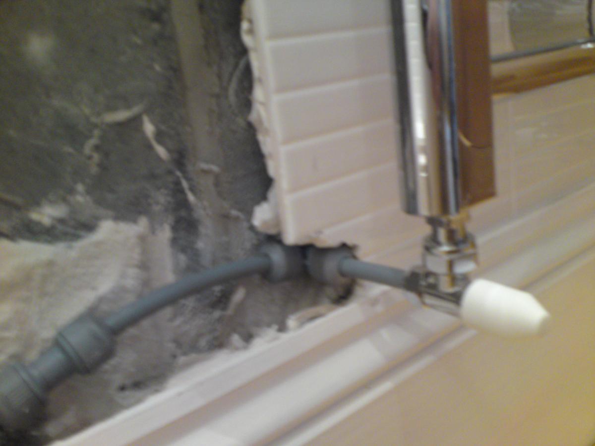

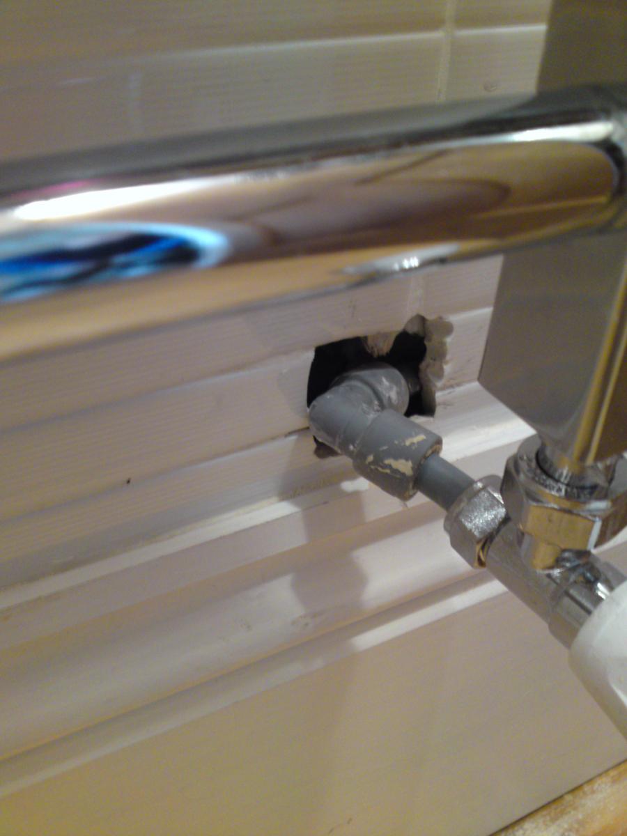

This is the best bit - In the downstairs cloakroom we tiled before Xmas there was to be a new towel radiator fitted in here as well!
As it was smaller in width we removed 1 tile on the left side and he was going to repipe this side. We cut the hole for his new pipe and today we were just meant to refix 1 tile.
This is what we found he had done to make the radiator fit.
Tomorrow he is returning to take the Radiator off so we can repair all the tiles and he can hopefully have the pipework coming straight out of the wall:mad2:
:mad2: i hate shoddy tradesmen... all trades have them..:incazzato:

to call the person that produced that well mess,a plummer is far to kind ,plastic pipe butcher comes to mind :mad2:
Personally I'd say he's more of a 'Plum' than a 'Plumber'!!..... Push fit has its place but on exposed pipework like this is just shoddy. I'd be charging him for your time and would probably have a few choice words to add too...what a muppet!
Are you sure he is a plumber thats disgusting he needs beating round the head with a leangth of john guest :ban:Idiot needs naming and shaming.
what a rubbish installation

either way its shoddy and lazy work yet again:ban:
as said that is very very poor,i realy cannot understand how a "tradesman"!!! can walk away thinking that that is acceptable,no wonder plumbers have a bad name,
