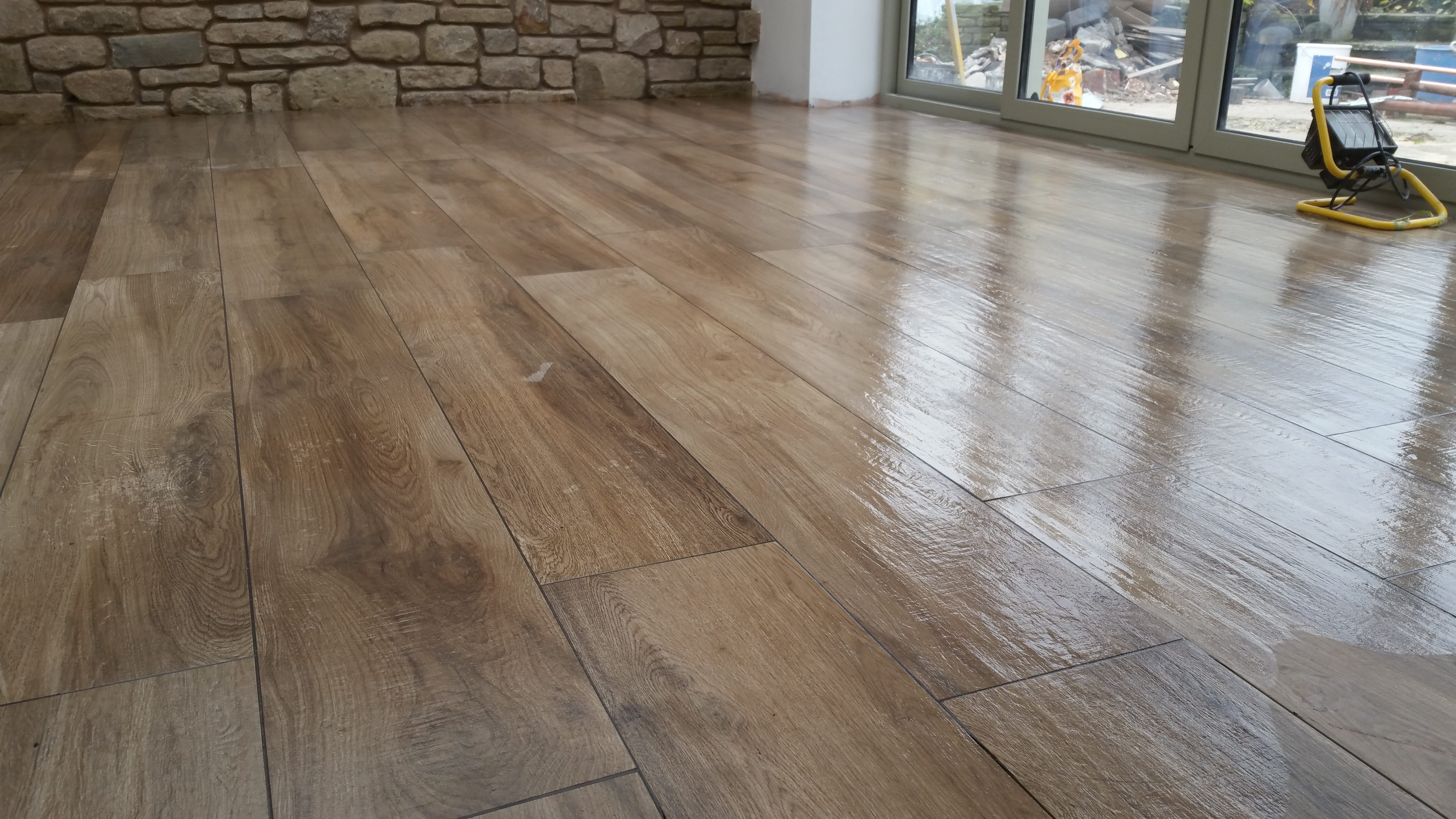

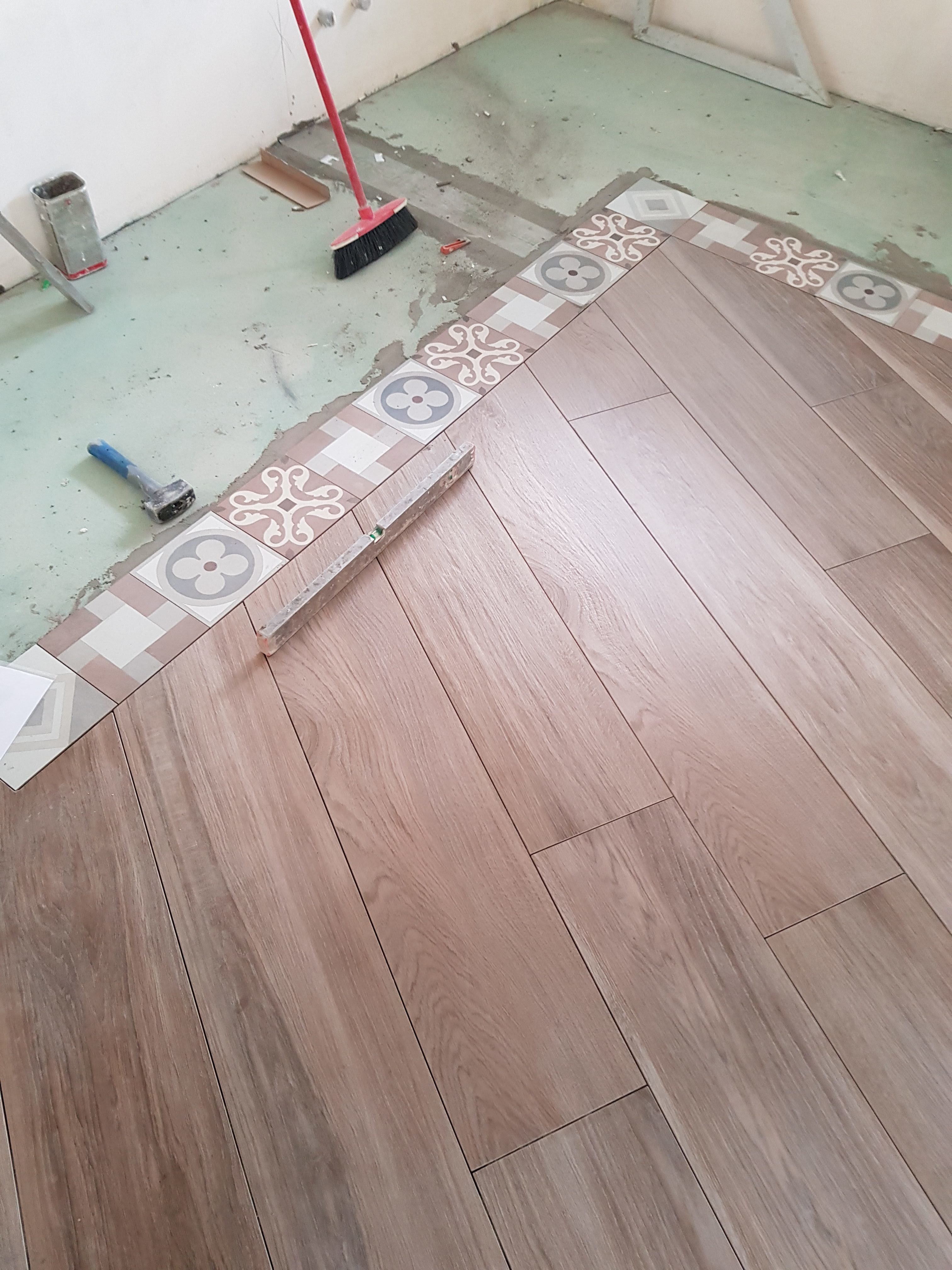

this photo is a 25x150 that I'm doing these days

make sure you follow matthew77 pattern if you are laying them like he has done ,1 whole one and 2 cut ones this has a more pleasing effect to the eye.
I usually lay in 3rd on or sometimes 1/4 on pattern, the picture is 3rd on so I’ve divided the plank into 3 equal parts and always laid the next plank a third of the way down. You will notice this effect a bit more than when laying with wooden floors as with the tile you have the grout line.
I’ve noticed also that a lot of these long plank tiles come with a no more than a 1/4 overlap warning on the boxes advising you not to overlap the next tile more than a quarter of its length. I’m guessing this is due to the curve in the plank, so when laid the lowest part of the tile (the end) isn’t next to the highest part (the middle) and in this instance a pattern like impish would probably suit better.
