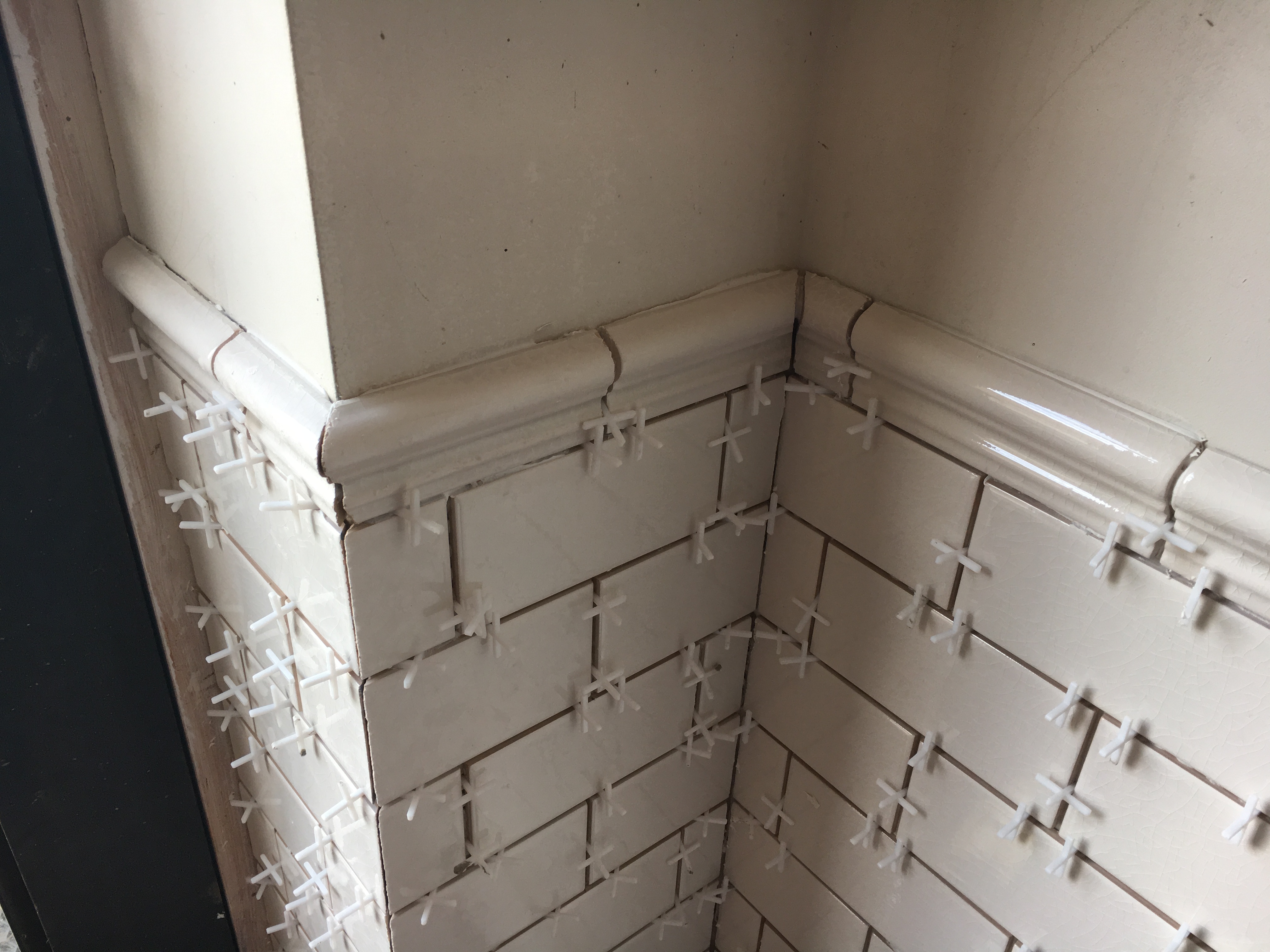

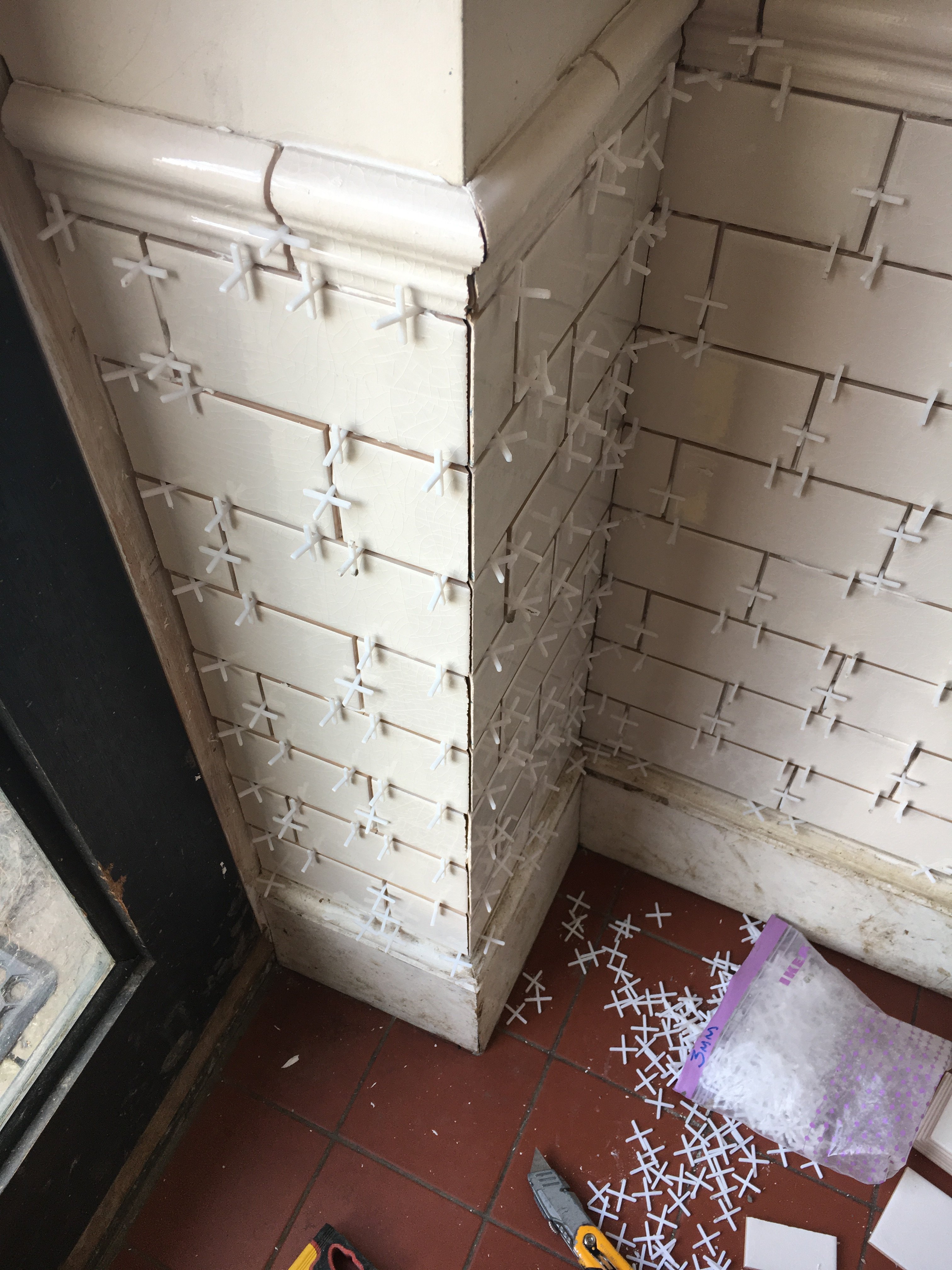

Heres some pics of the first wall I attempted.
The mitre has opened on the bottom which could mean a couple of things your table wasn't 45 degrees or you may not of held the piece square when you cut it or the wall is out either way if you have spares it will look better if the joint is even , good first attempt considering its your first time using these type of borders

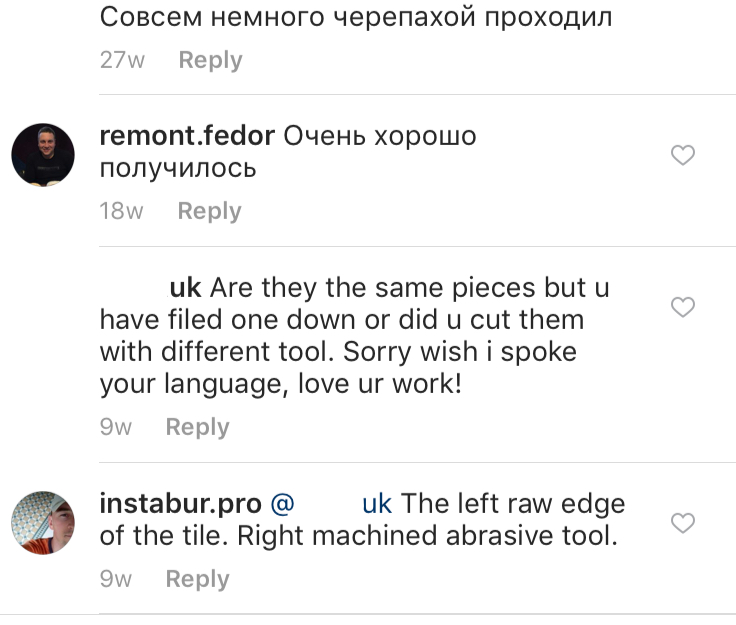

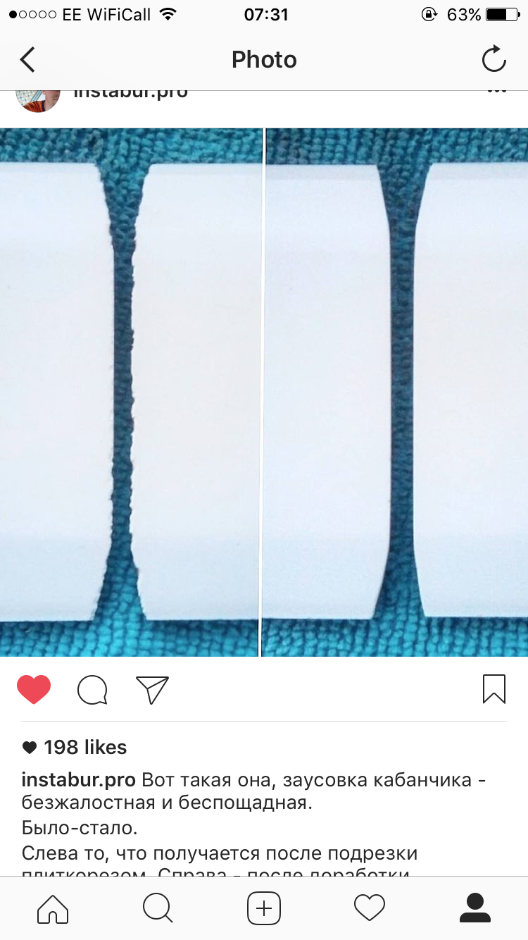

Tom, i follow a really good russian tiler on instagram and he posted a photo with and without a rough edge on external mitered cuts. I wasnt sure if the photo is of 2 different cuts so i asked him.. i think he said they the same cut but his smoothed them down somehow, unless something got lost in translation which could be likely. For your info.

As Paul C. mentioned a diamond file or sharpening block can clean up edges reasonably quickly.
