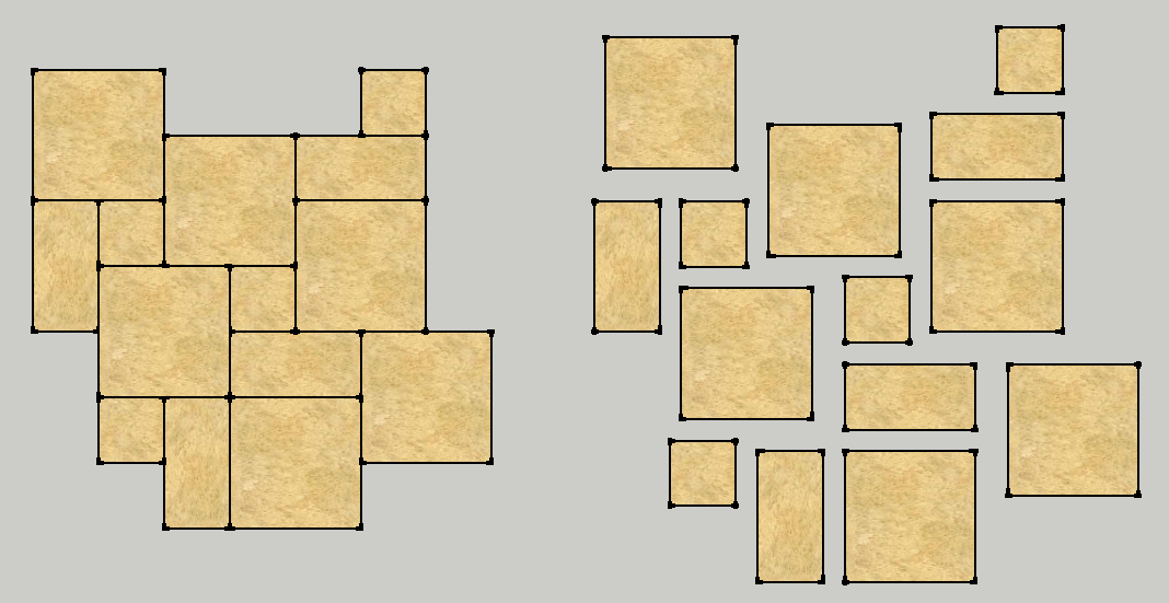

We've got a 3 tile size opus pattern we're doing in travertine. The tiles have not been bought as a set, and therefore there's a slight spacing issue. The tile sizes are 610x610, 610x305 and 305x305. Now, they clearly fit together fine with no spacing (assuming they're all perfectly cut to size), but as you can see from the attached pattern below, if you take a line across it, some parts of the pattern have 3 spaces, others 2. We therefore have 2 options, the guy at Topps said use 4 & 3 mm spacers, I can't see for the life of me how that would work. Using 2 and 3 mm spacers we can ensure a total of 6mm of space across all areas of the pattern. So 3 2mm spacers where we have 3 spaces, and 2 3mm where we only have 2. Again attached example with massive spaces so they're easier to visualise. The 3rd option is obviously to trim 2mm off the smaller tiles where we have 3 spaces, ensuring we can use 2mm spacers throughout.
What would people recommend, visually and amount of work taken into account. Would mixed spacing look weird? Should we be trimming the tiles?

WillCalderwood
Thanks, you say trim the small tile. I might be picking up on something unintended here, but you used "tile", not "tiles". I can't seem to work out how to only trim the smallest tile and get it to work. Should I have to trim both the smaller tiles, or should I be able to get away with only trimming the smallest?

This is a very common problem but not as difficult as you think to sort out.
If you had an average joint of 3mm joint you can overhang the joint by a mm where you need to and it will never show when grouted if distressed tile edges. Where you have two tiles = size of one tile with no joint. Just open up the joint when fixed with thin blade.mathematically it does not work but it sorts itself out with a bit of thought.
Will - if you are going to follow a repeat pattern and not use the 3 tiles in a random 'Opus' then your diagram is out in bottom left.
As these tiles are usually not made as a design but brought together as you have done, size and colour differences are extremely common. It's nearly always the small square which has to be accommodated into the layout and cutting the mm's off 2 sides of this small tile is the only solution. It can be tiled using a variable joint without spacers and self spacing, but the tighter joint of the small square is often noticeable on a square edge tile. Fortunately travertine and wet saw easily overcome this variation .

We've just finished tiling a floor with opus pattern where tiles were not a set. So the smallest tile x 2 = the exact size of the next tile up. No allowance for spacing. The way we did it was to layout the tiles as a dry run spacing by eye, then measured the overall dimensions of the module. Marked out a grid based on this dimension so as to stick to these lines which meant that the larger tiles stayed perfectly aligned across the whole floor, the smaller tiles were fudged into the gaps. It looks great and the unevenness doesn't jar at all especially as the tiles themselves are naturally variable colourwise. With hindsight the tumbled edge would have been a better choice than chiselled as this would have masked the variance even better. Partner wanted to trim the tiles to fit but I put my foot down, which he admitted he was grateful for as it would have been a lot of unnecessary work not to mention dust!
