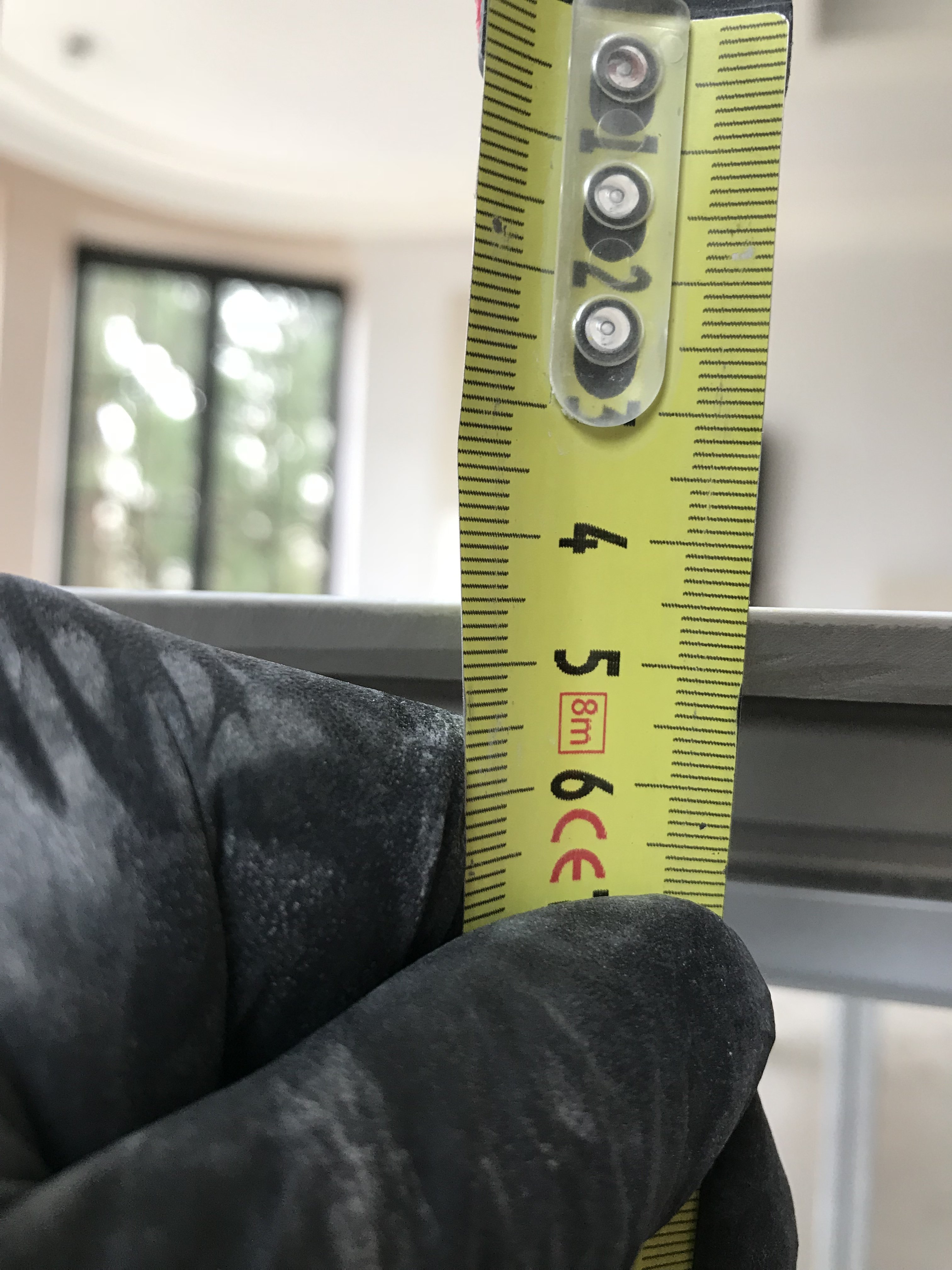

Hiya yeah I was looking at ur pics of the large format marble tile looks brilliant. Just wondered how you finished ur edges have you mitred them and polished them. Also what tools do you used to achieve such artwork

Anyway, yes Adrian, all my external angles are mitred and resin filled.
They’re all done with just a small Bosch 7-115 angle grinder, freehand.
Firstly undercut with a regular diamond blade, then polished back to the edge
