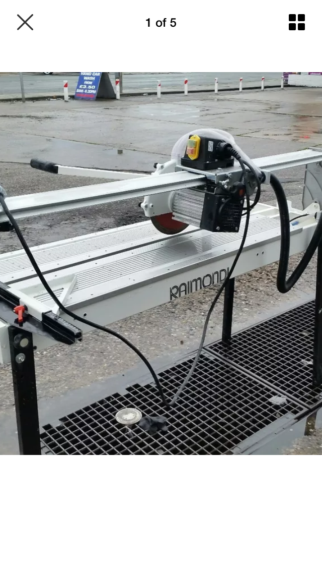

If you're predominately working with nothing over 300 x 600 or 600 x 600 then its not a problem as you can get a 300mm cut without touching the arm. although if you were working with a 900 x 900 for instance then in theory you may need a 450mm cut, then it fouls on the arm. you can get over this by doing two cuts to get to your required size... but that's wasteful. I got over it by getting this as I was using 1200 x 600. hope this helps.
