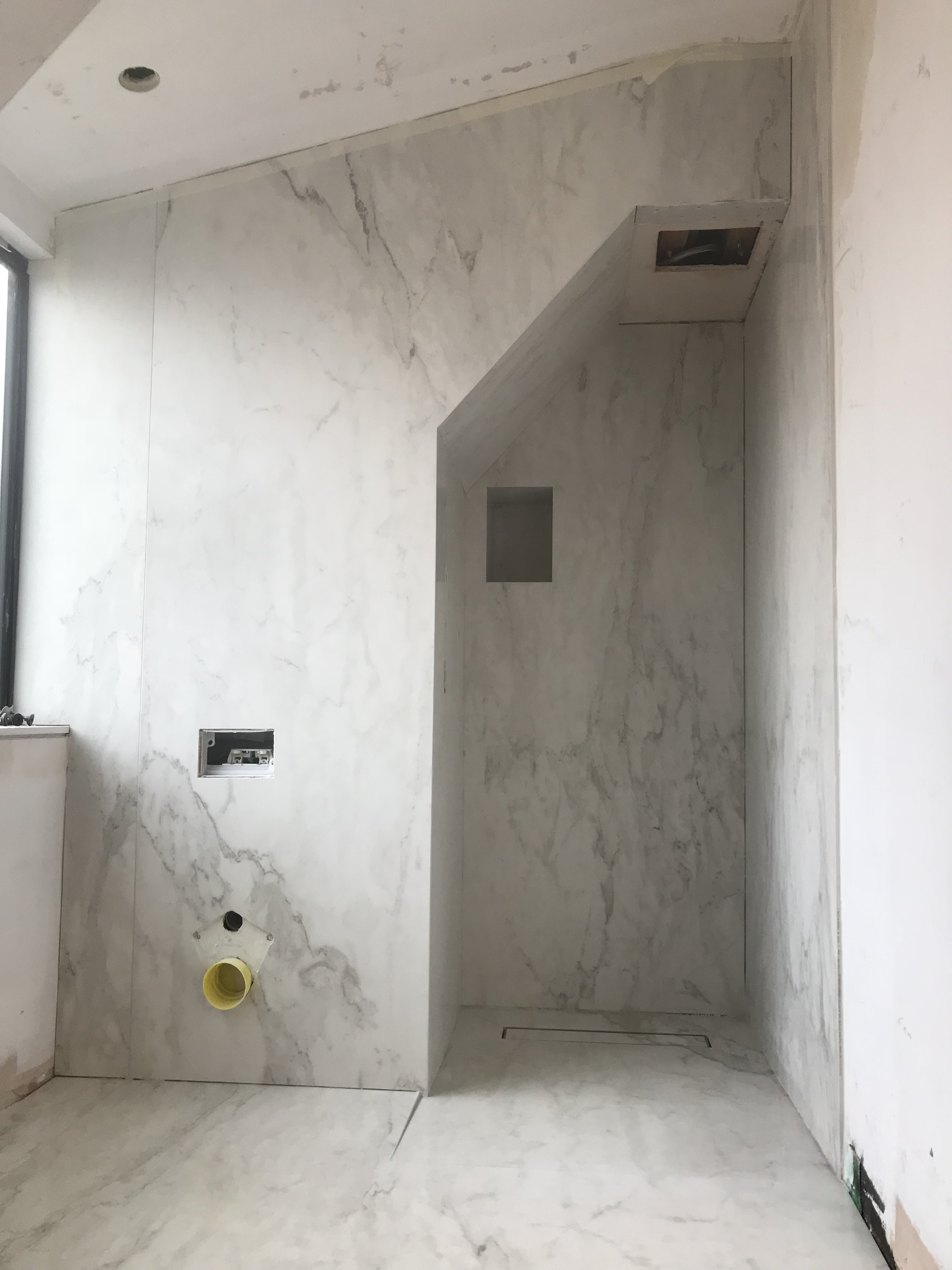

Do you mean like this?

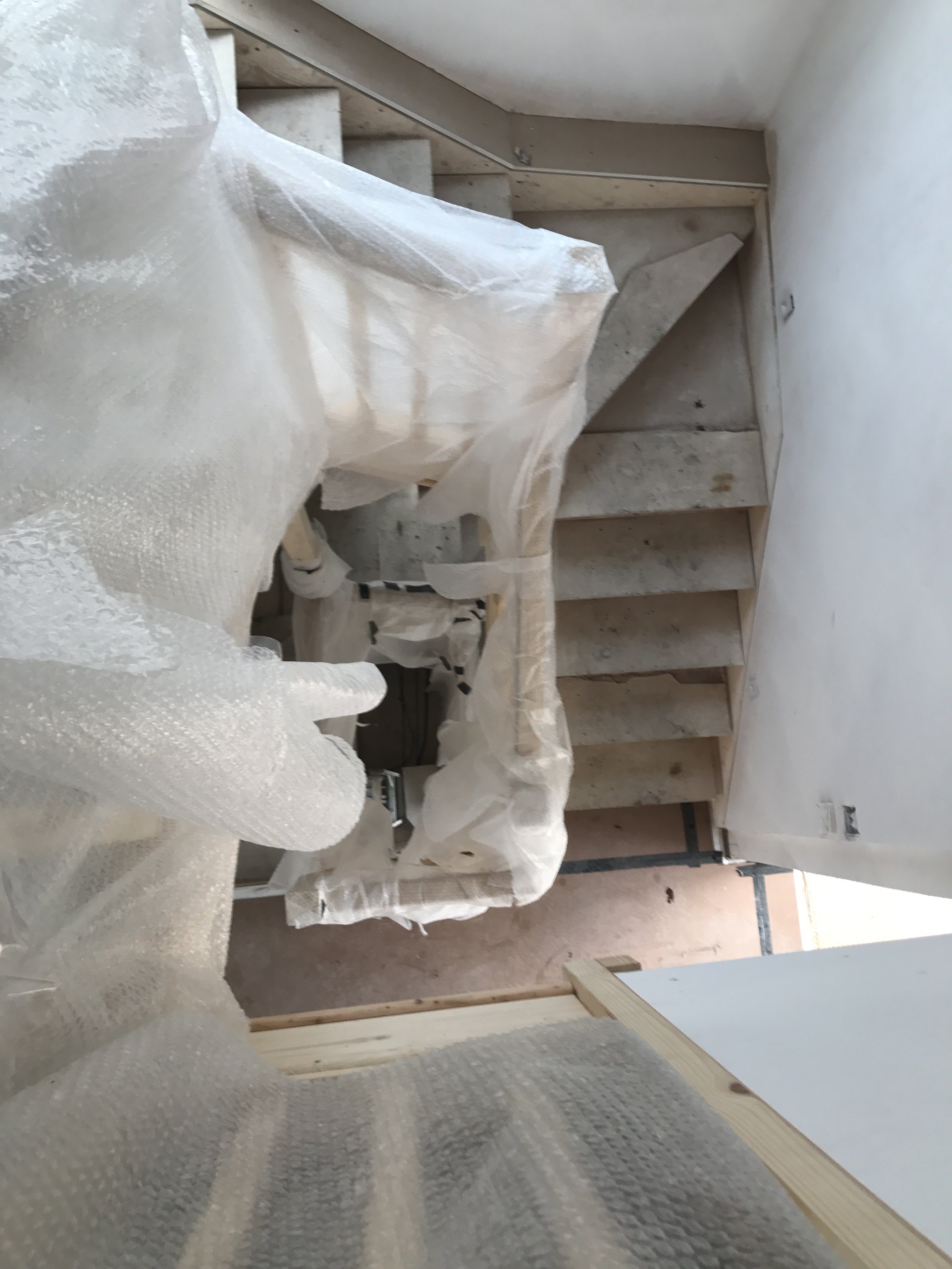

Those had to go up these!
30C55198-005B-4B9B-BCEA-01FA543B8D5B.jpeg CC273C72-CB94-42F2-A2FE-FE3407635D67.jpeg C17BFE90-BD79-4774-B677-49DD23339D88.jpeg
All the way up to the loft space.
So I suppose, yes we do lug them up stairs to Joe’s ensuite. 😀 It was 4 flights to be fair. 🙂
View attachment 98020 View attachment 98021 View attachment 98022
