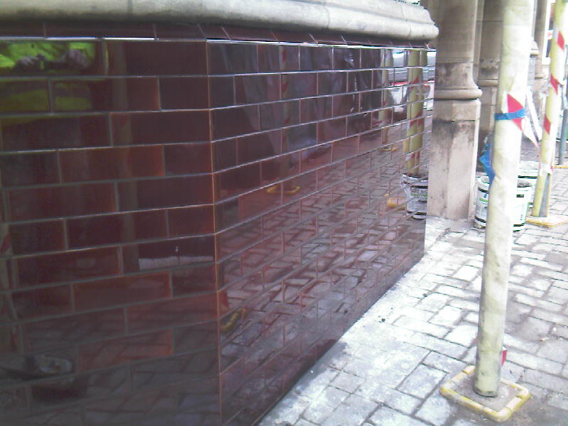

these are mitred joints, the ones to the right of the pic. The lighting is casting a shadow making it look like a cut tile, but they're full tiles. And granted they're Porcelanosa tiles so not cheapies
These are highly glazed tiles and the glazed damaged easily when cut. To obtain the mitres I had to reverse the mitres on the half tiles so that as Doug says, I mitred 1mm away from the glaze. Photo-0179.jpg
