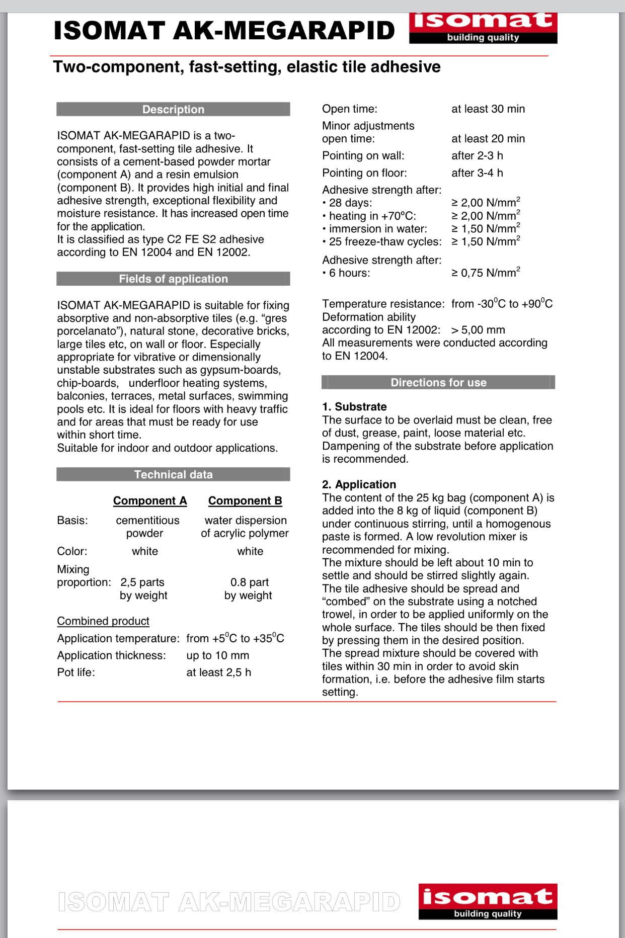

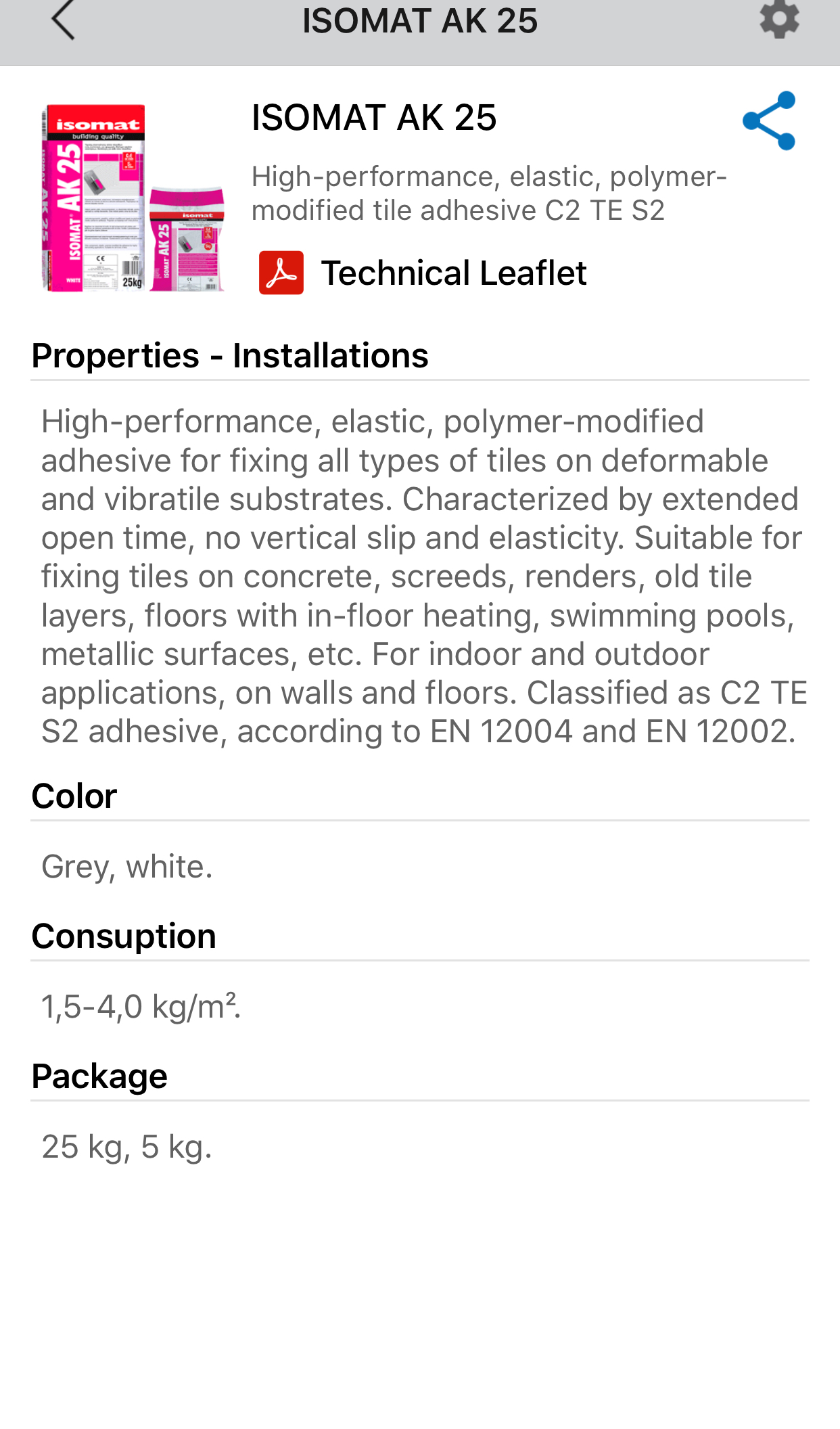

Here are some tech sheets for you read adam.
Ak25 is an S2

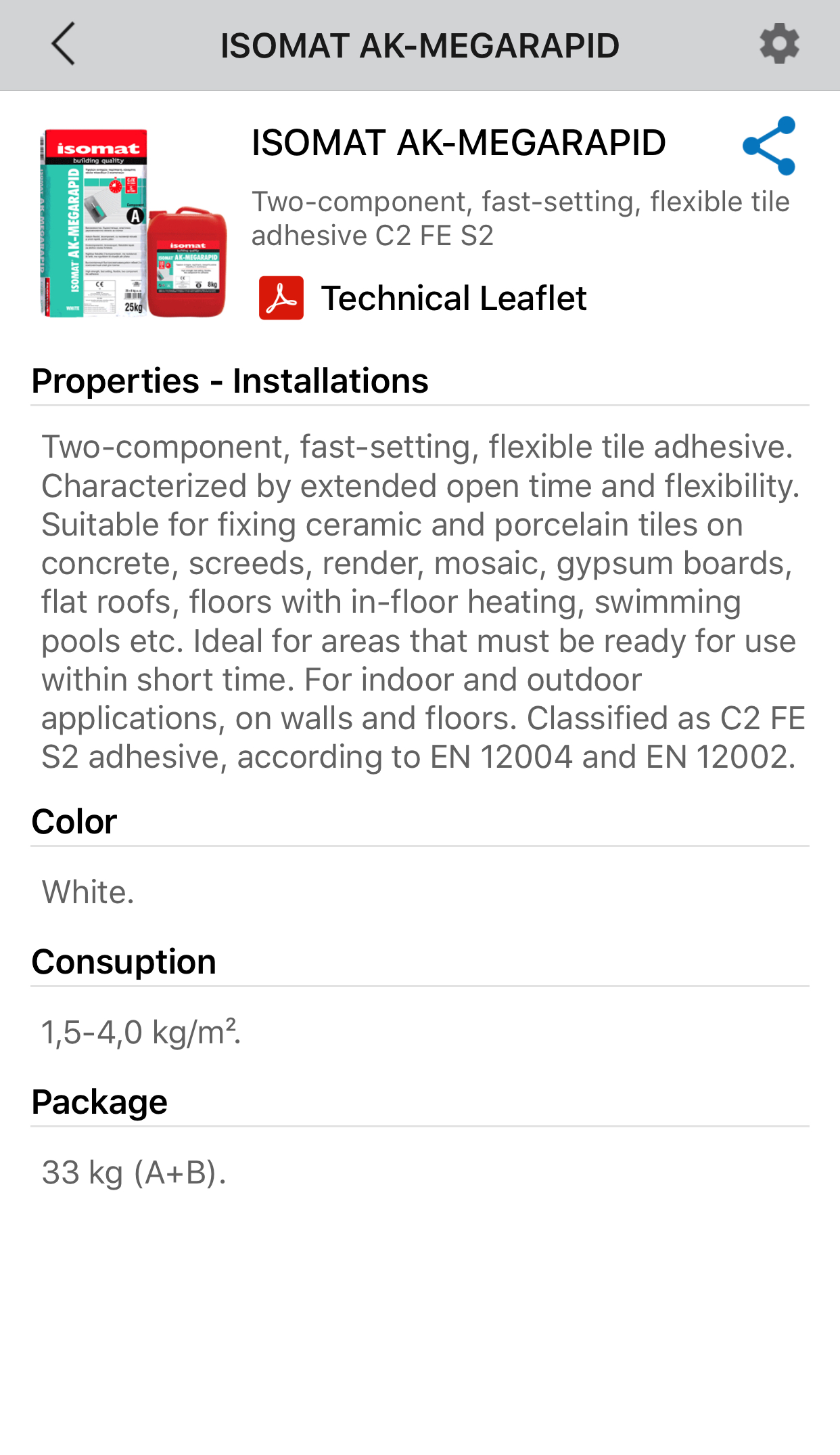

Mega-rapid is a two part adhesive, maybe this will help you understand the difference.
With the mega rapid, the fact that it is water free, will help prevent moisture issues with the marble.
Ak25 is an S2

The megarapid looks like a good material for the job. Any additional advice or pointers when working with this adhesive? Cheers
Nice one 3fall
No, only that it has a genuine pot life of 3 hrs. However, if you expect this might take a while, reduce the amount mixed at once, and make sure you weigh quantities correctly, as per ratio.
I’m sure I don’t need to remind you of that tho.
Otherwise you’ll be throwing away more than you use. 🙂
It’s also important to allow the adhesive to slake before re-mixing and using.
