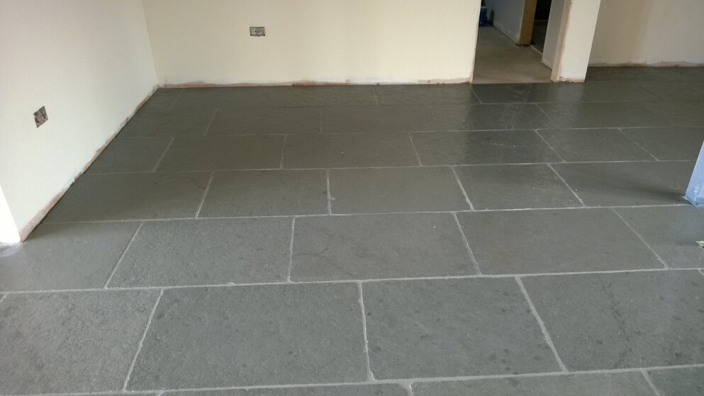

The Limestone size is 600mm x 900mm tumbled edges and tumbled surface, so definitely not smooth. I've uploaded a photo of the flagstones. The photo shows exactly how I would like the finished look.
I phoned two tilers today and am beginning to get the feeling that not too many tilers have experience of laying 20-22mm thick Limestone flagstones?
