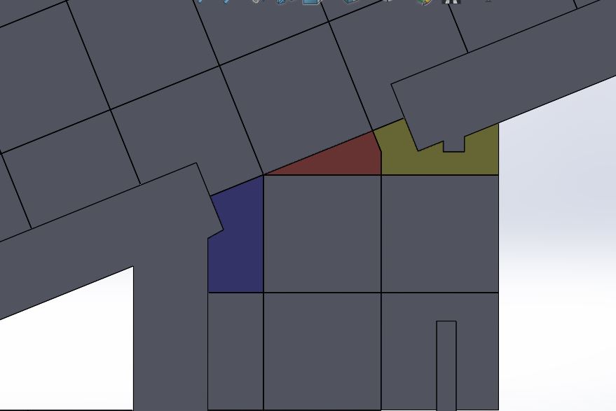

Hi all,
So after a bit of time looking at this (pushed on by the fact the tiles were delivered 🙂 ) I'm looking at doing the below as a solution.
Splitting the angle would give me a joint running 11Deg through the threshold at the door, which i didnt like.
The below option (three coloured tiles) at least retains a straight edge parallel with the door.
Anything i'm missing with this option ?
Thanks,
Tom
Hopefully the “yellow” tile isn’t a full tile from the back wall otherwise your plan will not work as it won’t be wide enough.
Well spotted,
We were probably going to run a different tile into that adjacent room, so the plan may still work.
But that is why i posted that picture, i did not catch that,
Much appreciated for that comment
Tom
