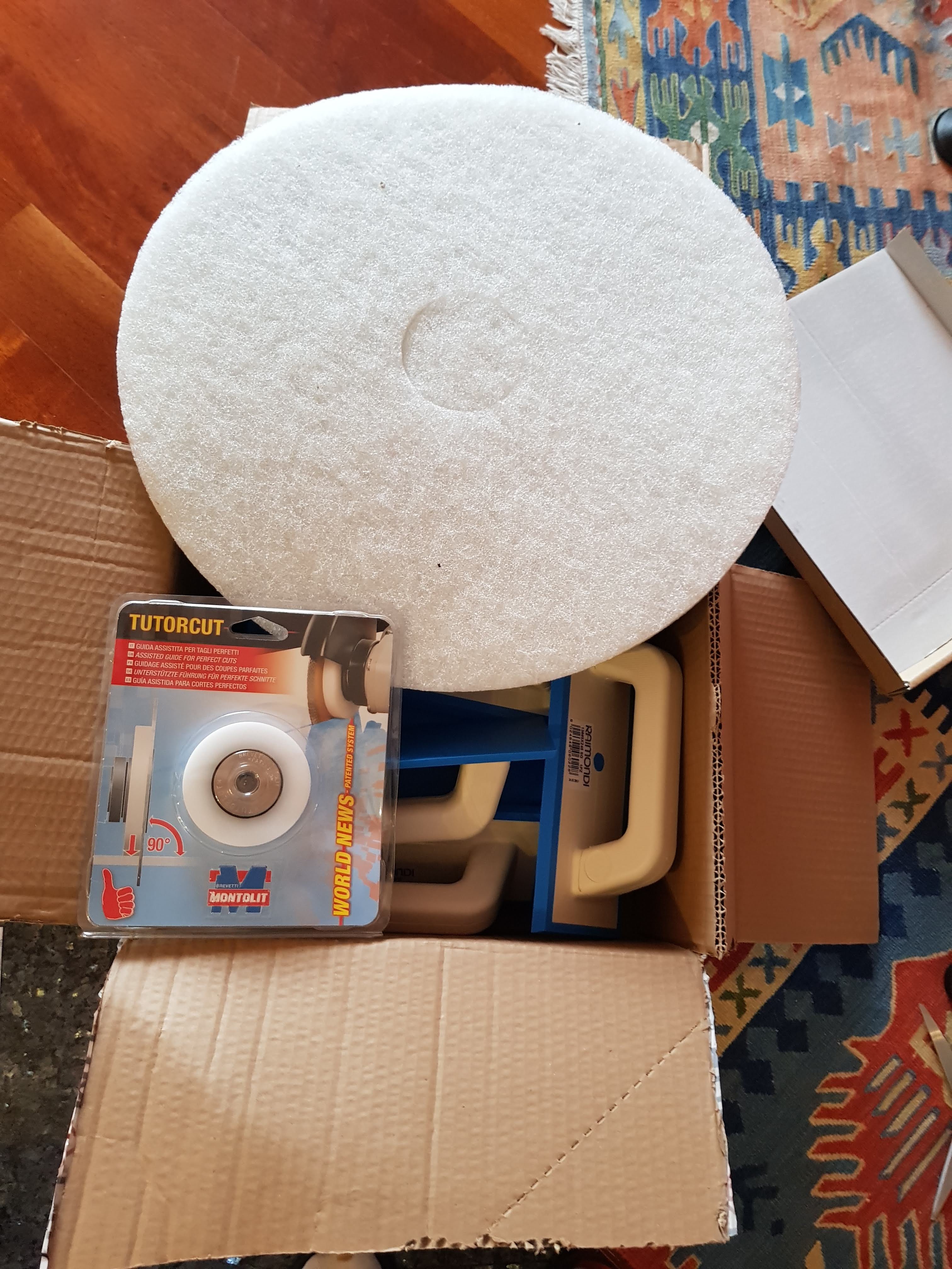

@Plan Tec Tiling
now Bosch is at the highest level of brightness
