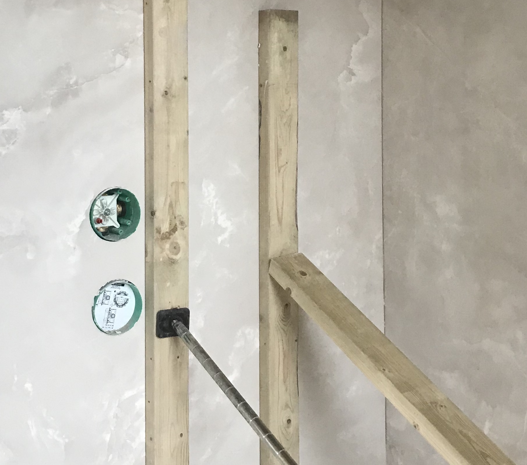

What’s going on there with that timber ?
What’s matter Andy, don’t you believe me?
Looks like mark frosts ways are creeping in. ‘Marc we don’t need that sigma frame for this one just pass me that 2x4’
You can keep them bananas down south

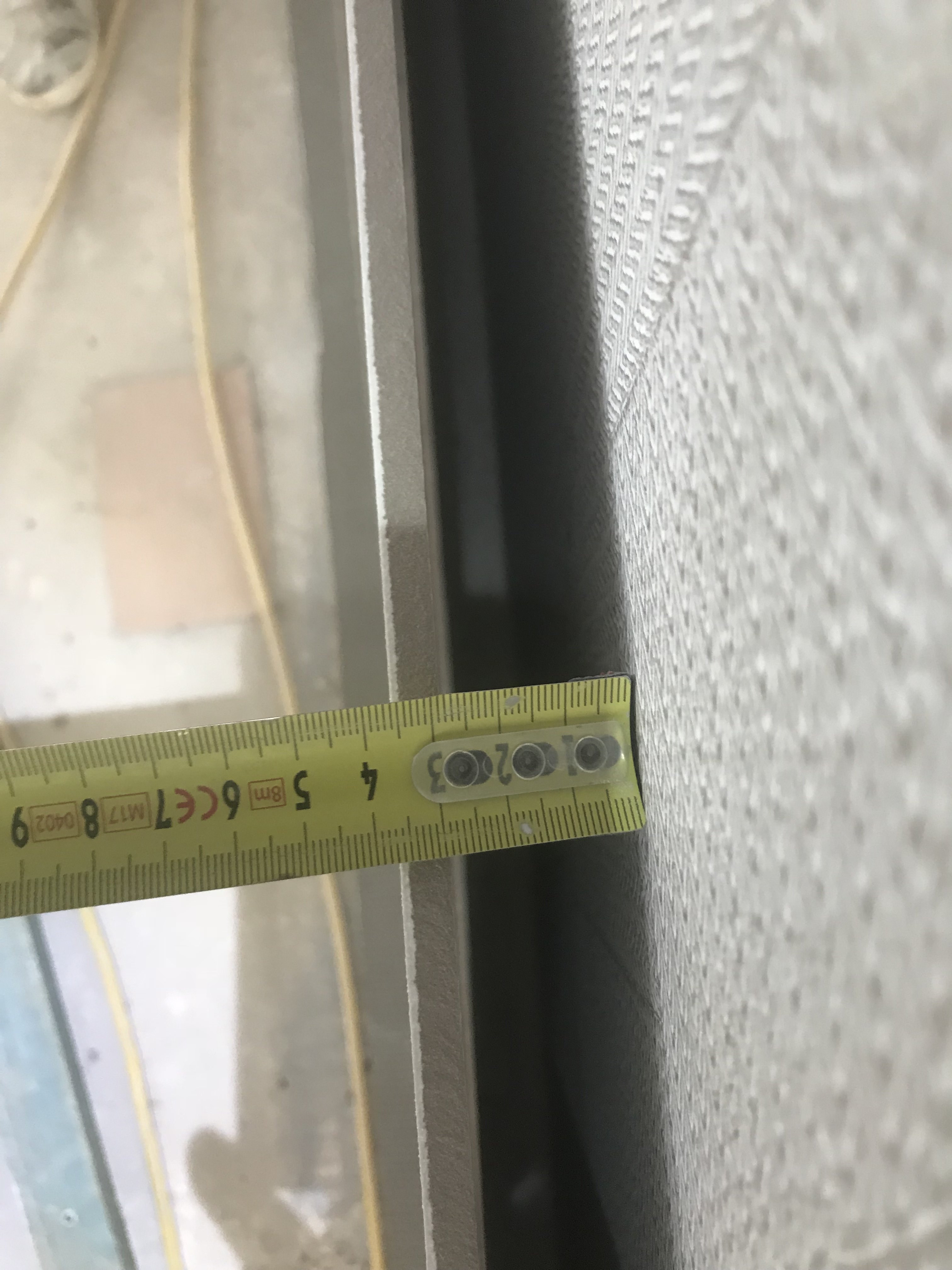

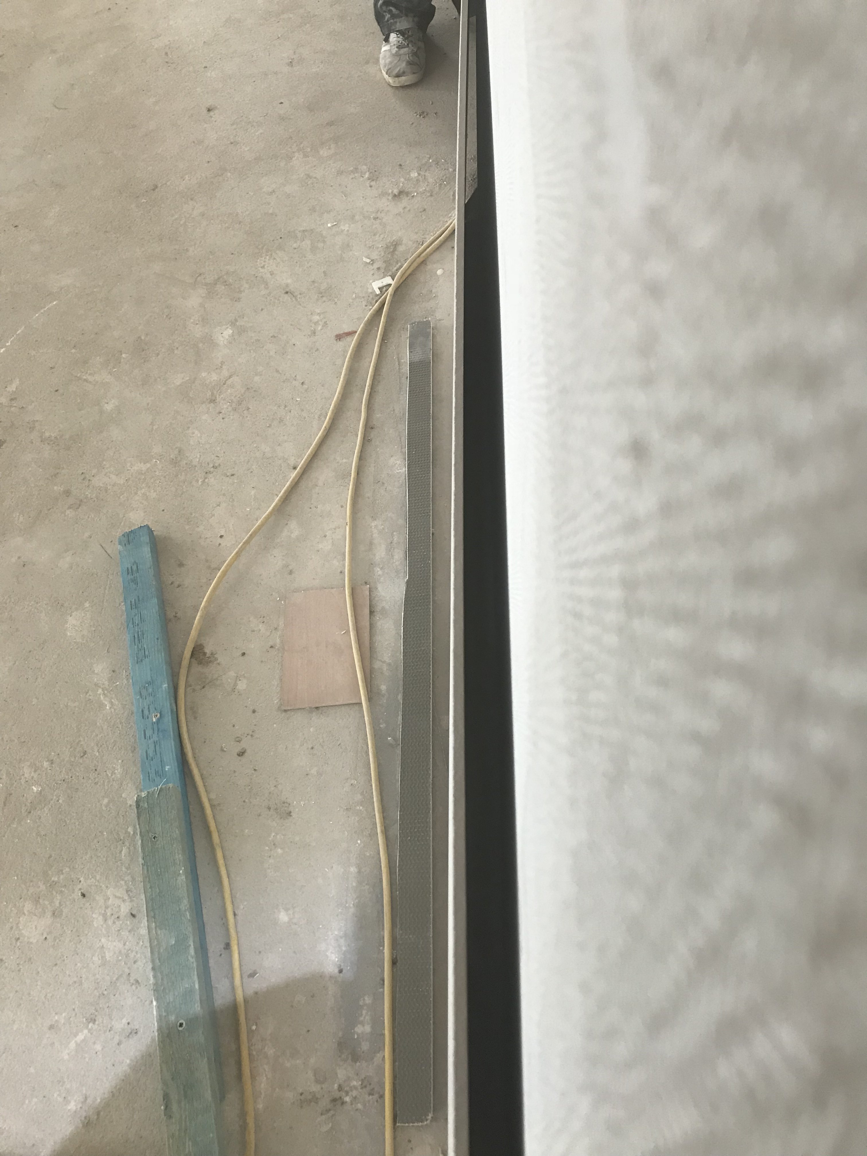

Yeah this colour has given us, well me, headaches.
The black and white were fine, but these, not so much.
Tensioned and extremely bowed, almost unusable.
I had to wait for a rep from Italy to visit (too big problem for U.K. rep) , firstly to see if I knew what I was doing 🙂
And secondly to check out my request to back them.
Some 25-30 sheets, not a fivers worth.
They agreed to replace any or all tiles that didn’t behave themselves.
