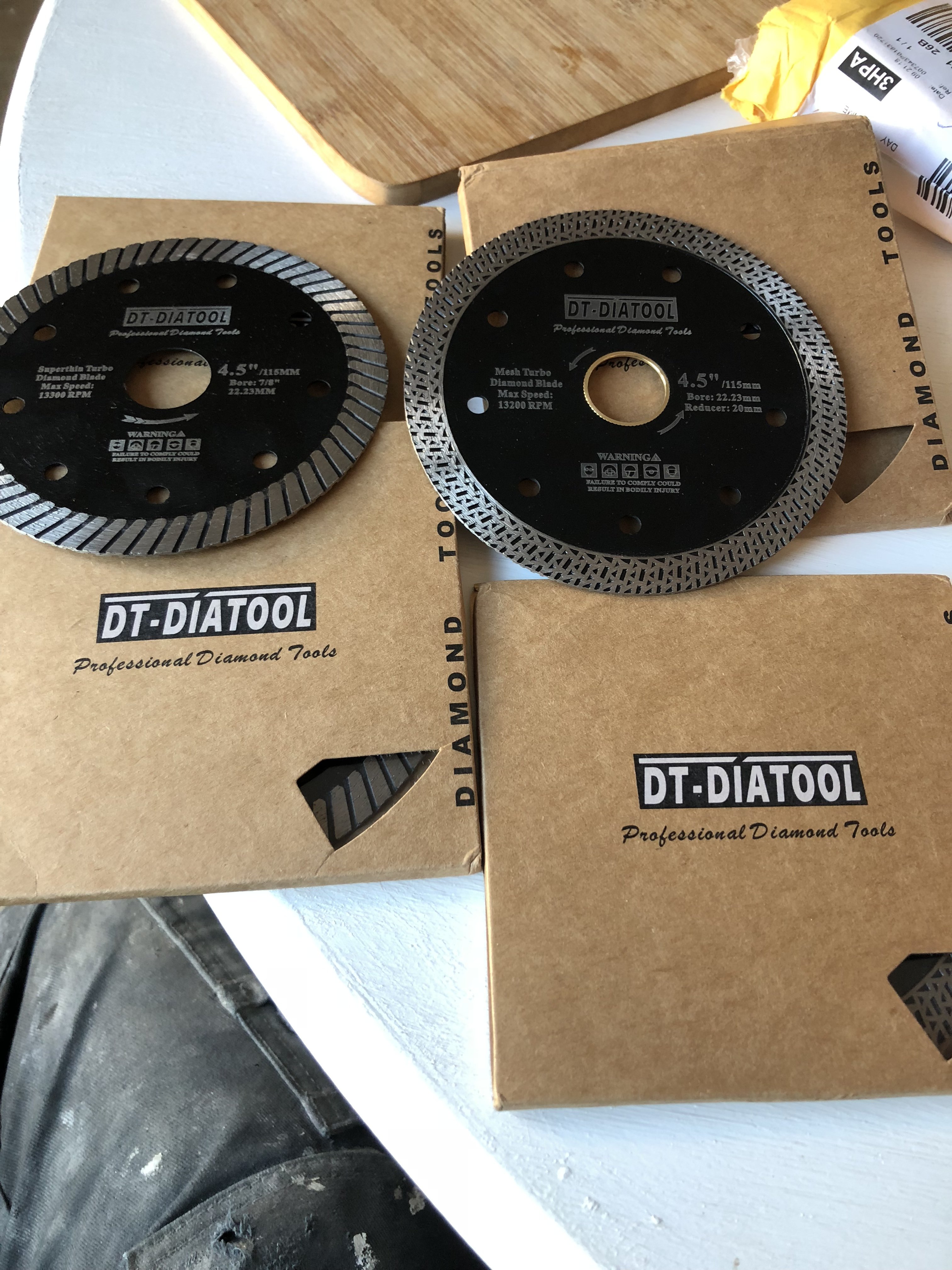

I've just ordered 5 of those blades on Antonio's recomendation.

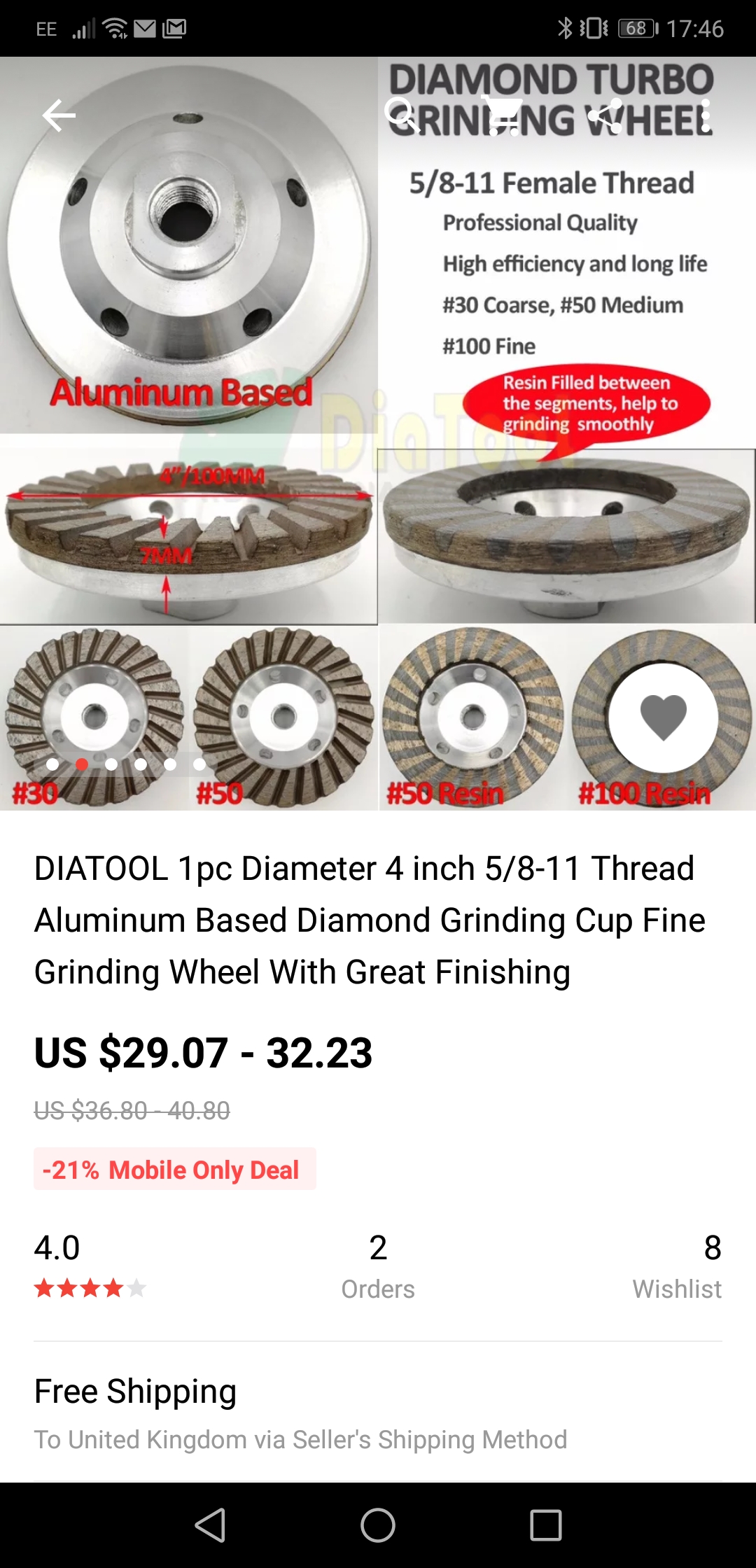

A bit of advice. If anything is described as having a 5/8-11 thread it won't fit anything sold in the UK. It's an imperial thread size that fits American machines.
If you buy something make sure it's M14. That's the standard size of tooling sold in Europe/UK.
I compared the blades to the Montolit CGX. Very similar cutting.
That thin blade cuts through 20mm Quartz ridiculously fast. Using it on some 10mm porcelain and it almost runs away from you.
The mesh blade is very similar on Porc. Slower on the thicker stuff. Far more stable on the standard size porcelain though.
Need to give the blades a proper test though.
