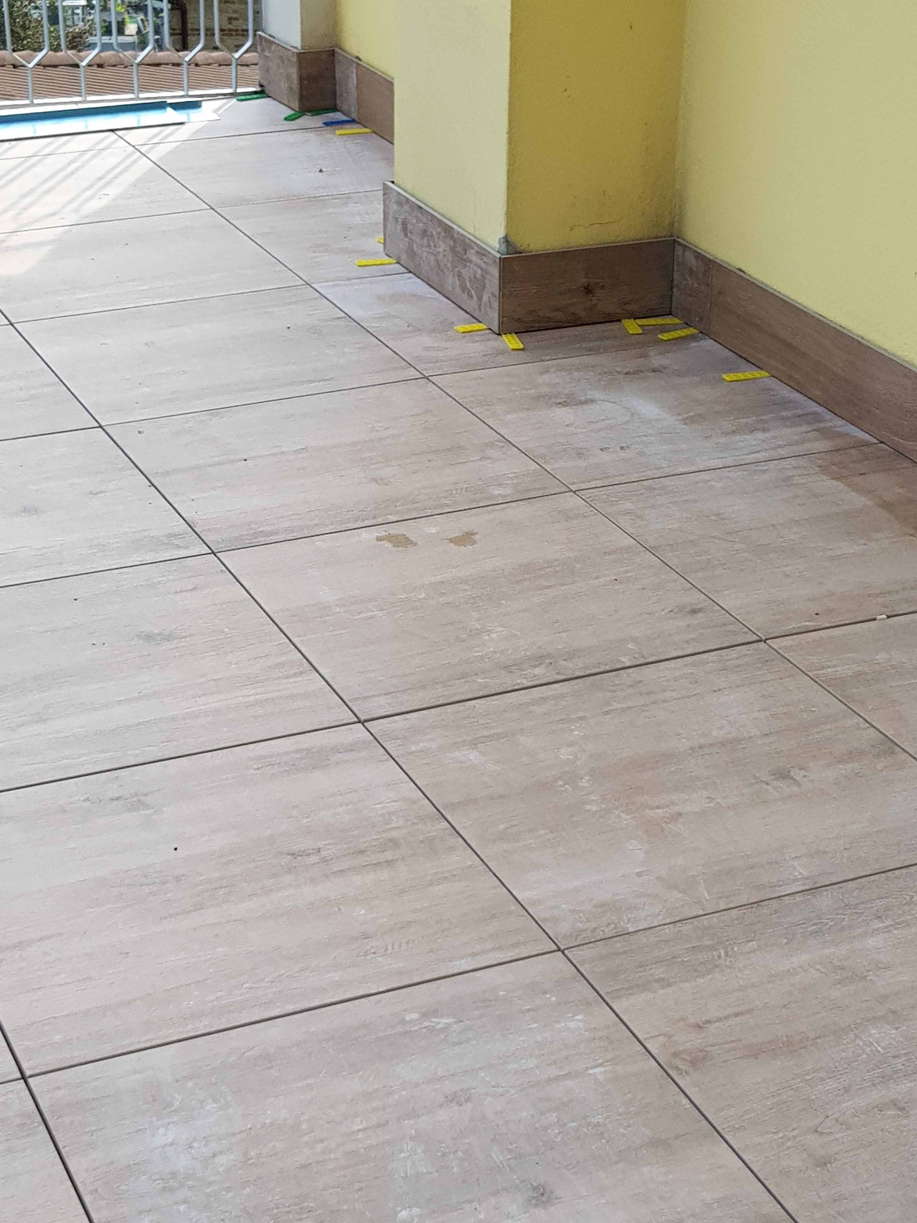

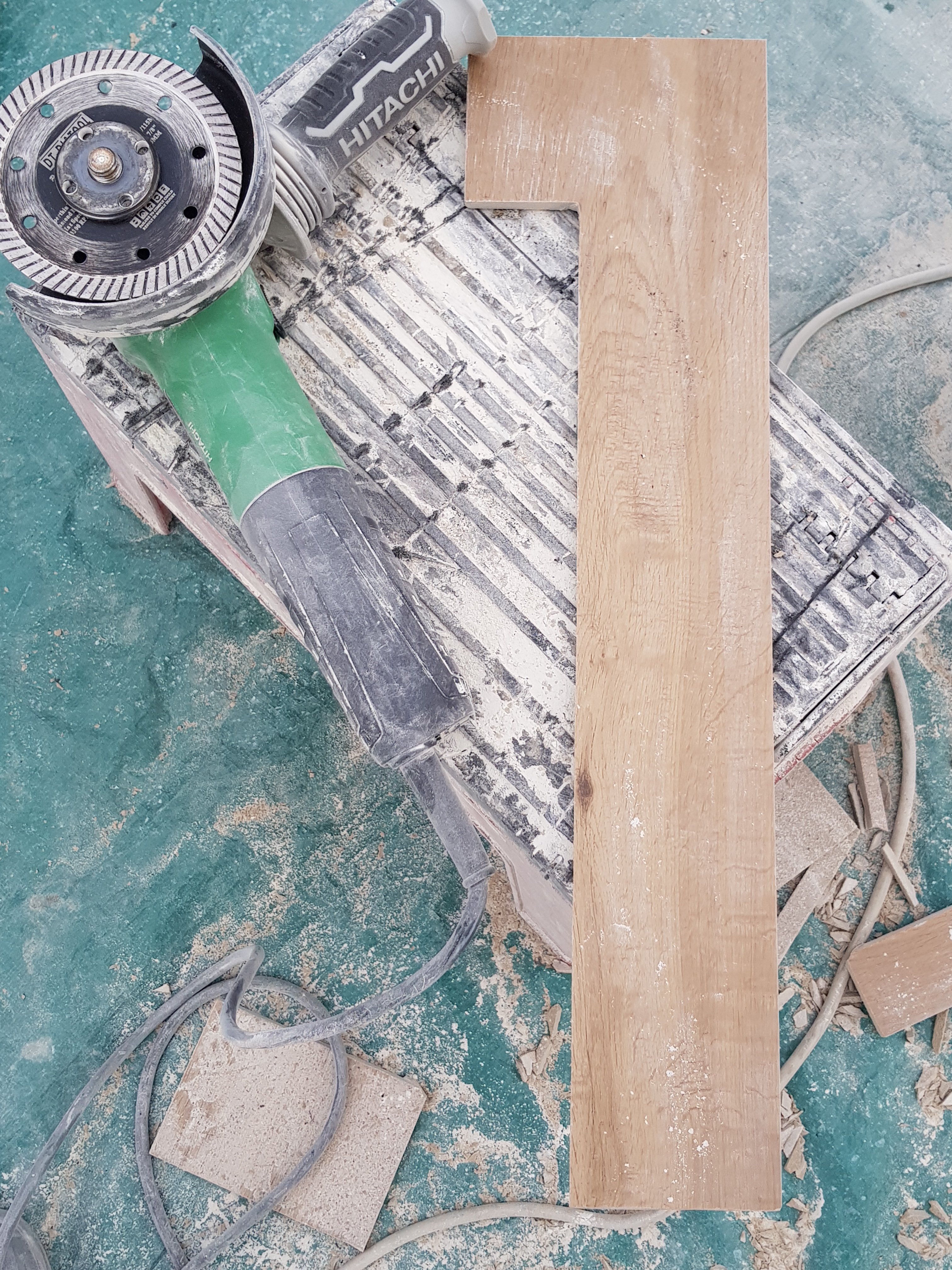

this morning I left the tile cutter home ... too eager to use the black blade
View attachment 100933 View attachment 100934
then, I had never experienced such a blade before.
(And I swear I've tried many)
I do not care about the blade life, I'm interested in finishing and speed.
I will still do some tests, then I will go to buy the 125mm and if I find it
a small one for thin porcelain.
I fell in love
now I will speak only if I have problems with the black blade.
ps (I will sell all the other blades I have,
in one block).
excluded the one that gave me albert, again
in the package 😉
