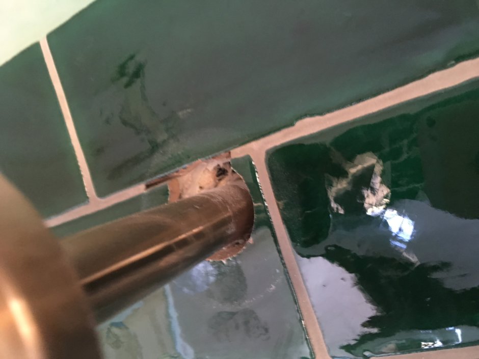

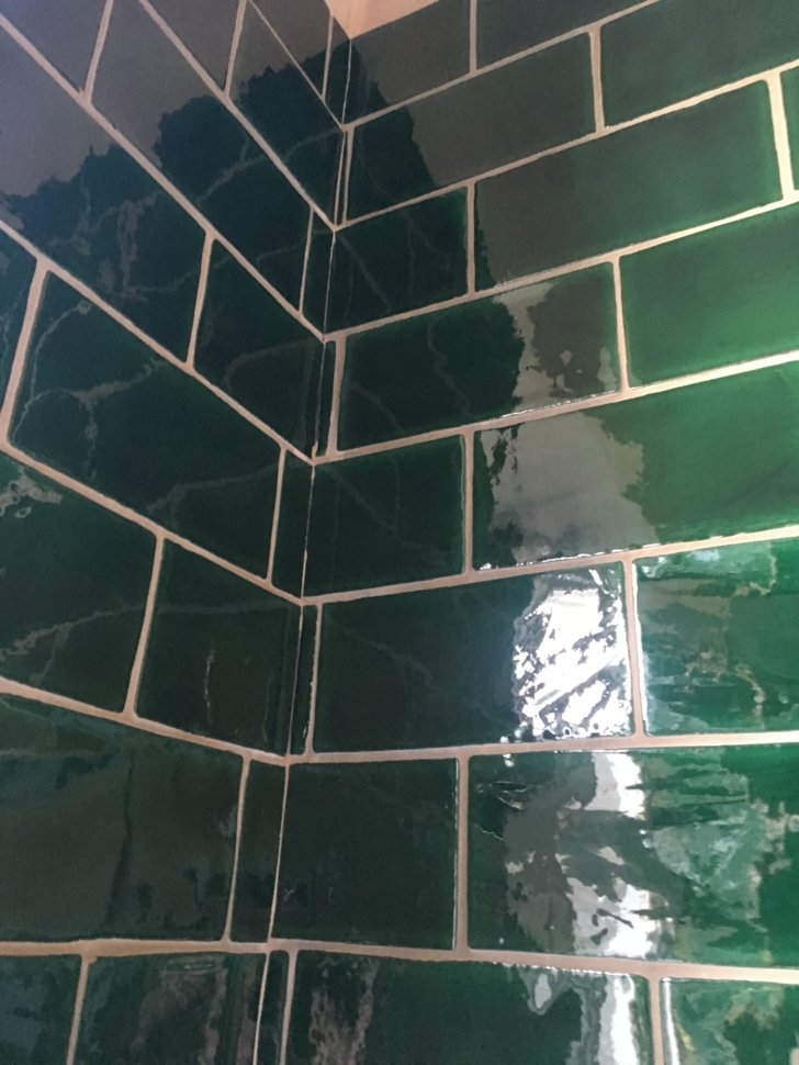

Invested in expensive tiles (£1,200 for this lot) and the tiler initially charged over £1000 to fit these 9sqm as part of his refurb of my whole bathroom (plastering prep was extra). I have argued him down to match another quote because of the state of the corners - slivers etc, but does the rest of the job look acceptable and long lasting to you? There is a wedge shaped gap at the door that I wonder how he will fill. The tiles have a gap to the wall I can slide card between them up to 2.5 cm deep (shown). Please advise.
Post automatically merged:
few more pics.. the rainshower pipe wobbles in its hole, is that acceptable?

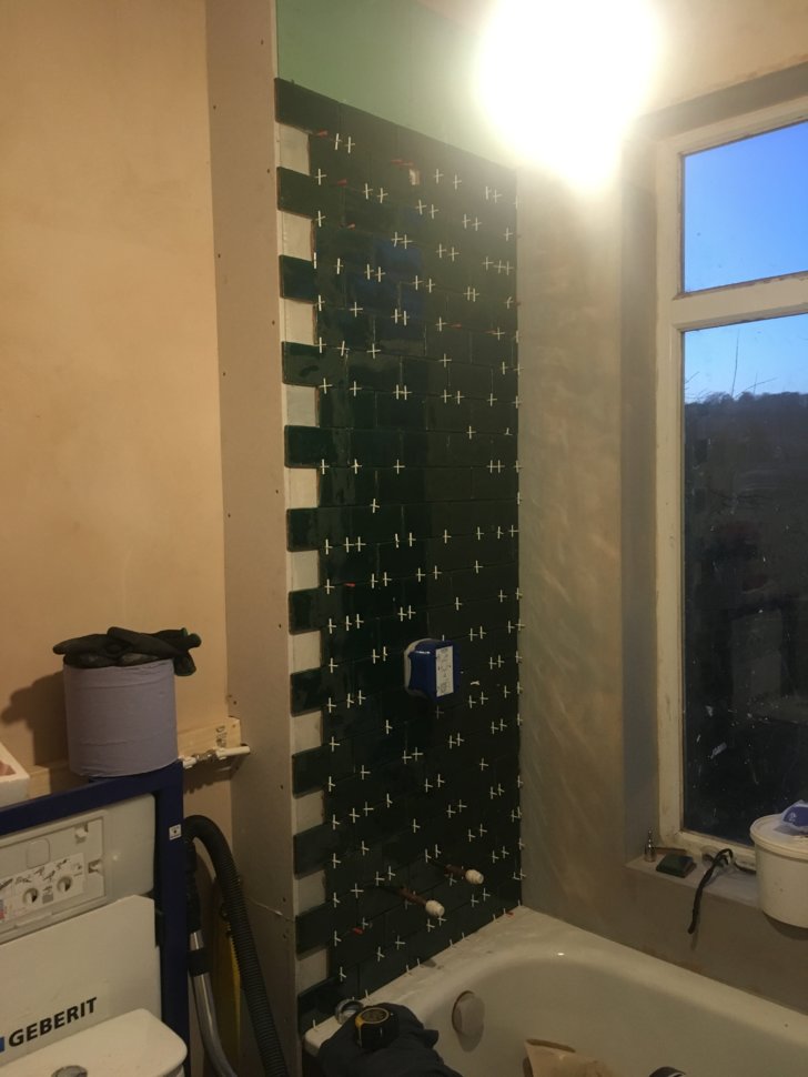

Has there been adequate waterproofing used? (glazed and sealed ceramic green tile)
Many Thanks for your help.

tiling looks fine to me, just badly planned and setout.

Unfortunately there are a few setting out issues here and clearly the cost IMO is a little over the top for that amount of tiling with the tile you have chosen. However, it is retrievable to a point as the actual tiling looks ok as i'm assuming of course that the tiles are meant to be a little un-even with a rustic style edge hence the slight uneven grout joints? he needs to cut a sliver of tile to go under the door and shave the door down to size. thankfully with this style of floor tile, a small cut isn't the end of the world and would look much better then a threshold filling that gap. The cuts into the corner are not ideal but at least he has wrapped them around the corner to make then look like 1 whole tile so I would probably be putting a nice neat small silicone colour match bead in each corner to tidy it up. The cut around pipe you have shown will look fine with a chrome cover plate and maybe thats what he planned to do anyway? I'd say if he gives you the discount and sorts them issues out you might still be ok, not perfect but still a decent look. Hope this helps.
Thanks for your detailed response JMC. Super Appreciated. I've also just paid a tiler to give his opinion in person and he also said the threshold needs to have that extra bit of tile before the threshold bar (but thought one of those too). Last time we spoke tiler guy said threshold wasn't in the quote but he would do it - the bathroom floor was definately in the quote lmao!
For the silicone bead would you say colourmatch to the green tiles would be best aesthetically? And that goes all the way up each corner?
The tiler who visited also pointed out the trims around the window are on in two different ways/ different thickness showing to the room, but perhaps there was a reason for that.
It was an expensive job - 6.5 k for the bathroom and I bought nearly everything and prep was standard, old suite and floor were already out and new basic floor laid. Hopefully I've learnt some lessons going forward with new contractors. When I asked for receipts due to high materials costs (1.8k) guy admitted he worked profit into his materials costs - reckon at least 50% and hasn't shown any receipts. Argued that I wanted him to take off that for two waste pipes I had bought. Will have to bring that up again. Just to give you a fuller picture of the story!

Not nice Tess, looks like they are probably a bit chancy and unfortunately they have had you a bit here but its difficult for a customer to choose the right tradesman sometimes.
With regards, the silicone, use a colour match as close to the tile as you can to hide the joint, will look miles better. Without seeing the setup of window properly in pictures, its hard to comment on the trim situation but sounds strange to have them 2 different ways.
