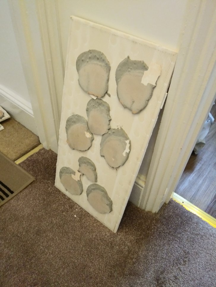

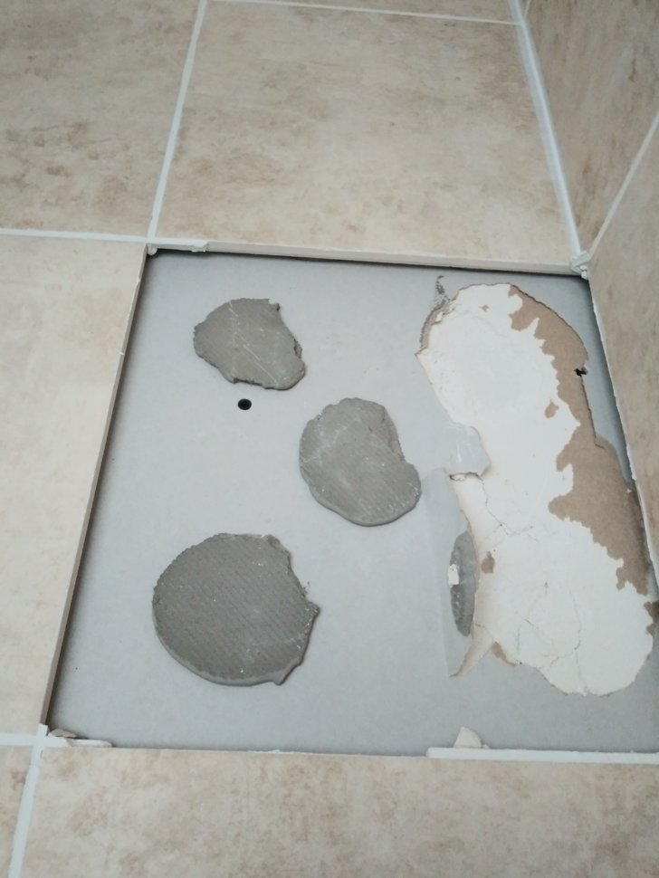

Just an update. After almost 2 years there is still a dispute but we managed to get some tiles off this week....
Pretty sure this show dot and dab...
Just an update to say we won our case in full against this builder and the judge found the tiling to be below standard and awarded us all our money back.
