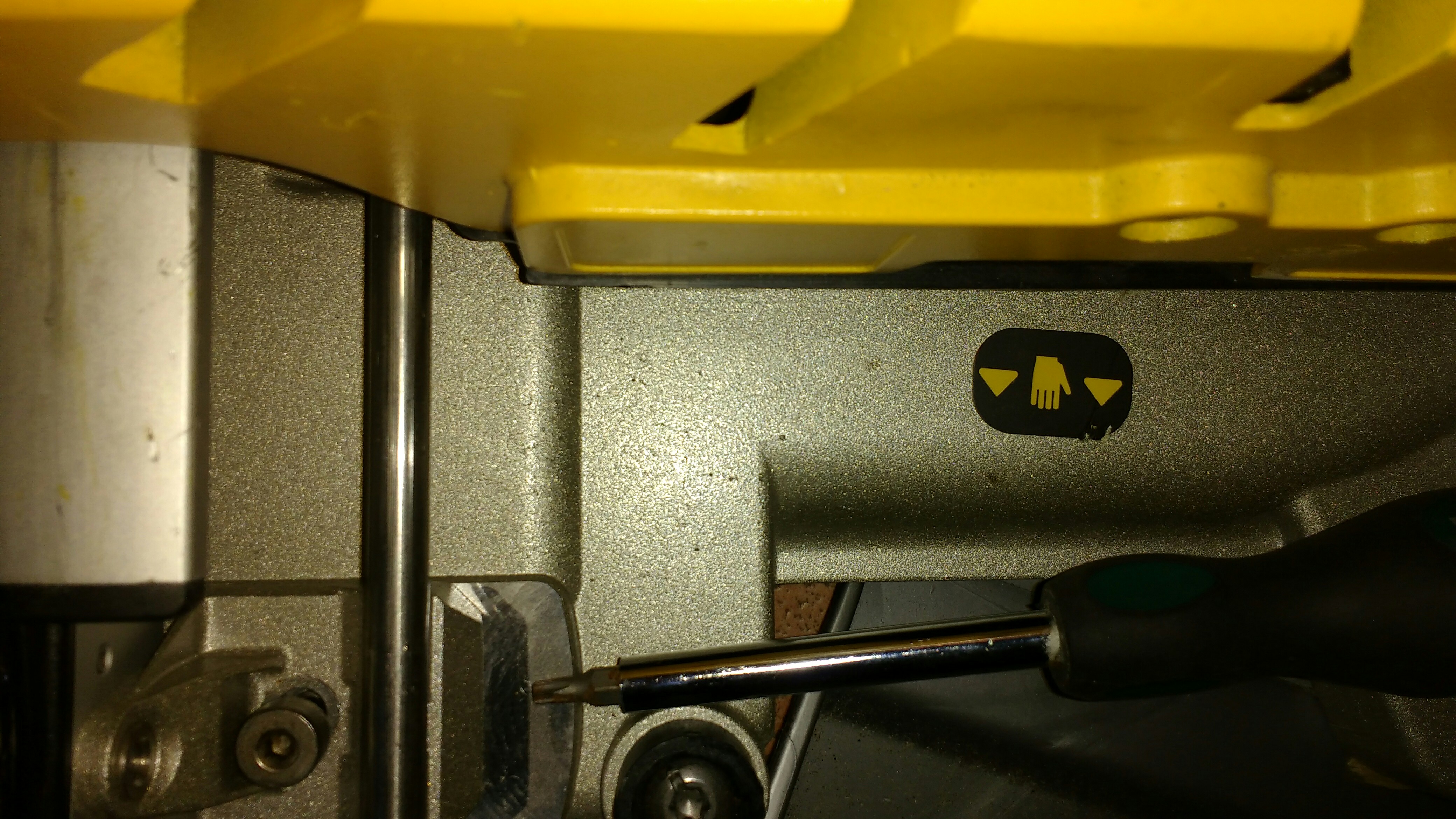

I've read the instructions! The wheels are all on. Id I go messing about with them, sure won't I knock it out of line. Say if I loosen the wheels from not tight, surely the tray could end up 1 or 2mm out!
Does anyone wheels move from side to side or are they bolted tight with wheels still moving. All mines are bolted tight to the frame.
It's the track u adjust not the wheels mine had the same problem as yours and I spoke to dewalt and they had me sit with the detailed drawing and talked me through what to do its easy and takes 2 mins

There's nothing wrong with it apart from lack of understanding the machine and how it's adjustable
I've been at it an hour and still not aligned!
Pic 1 is how much I've brought the rod away from its original position. See the clear part where tip of screwdriver is. About 10mm easy and still nothing.
Pic 2 is the saw standing upright while taking the pic. This is what I tightened up to try and bring it inline! This is while I've loosened all 4 top screwbolts! Even the sliding table with t slide down the rails while it's standing up.
