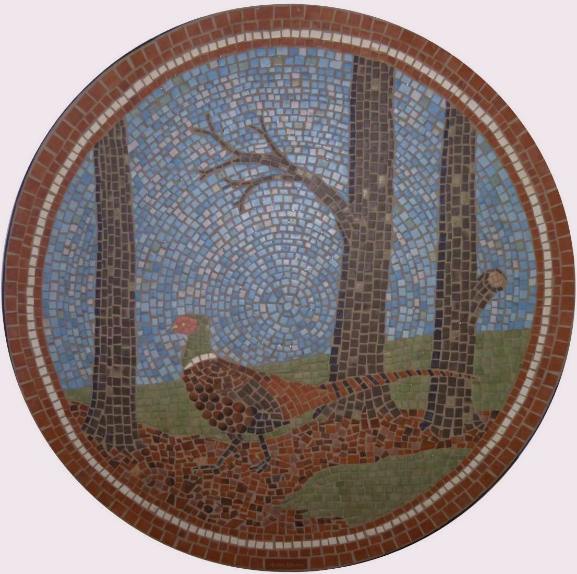

Embarking on large scale project, Have previously made mosaics using reverse method, sticking tesserae onto brown paper using wallpaper paste, then sand in gaps, ring of steel round the mosaic and concrete. When solid, turning it over, washing off paper and sand from gaps and grouting. Now making a floor in panels. Can I still work on brown paper with wallpaper paste and make lots of square panels and then could an expert tiler fix it to the floor as a whole? Tesserae not all the same thickness (though within a couple of millimetres) Want it to last a very long time.

Hi, Here are a couple that are about a metre across and a pic of me working on a larger rectangular table top (in reverse)

Thanks for replying, I've posted some pics. I'd be very interested to see the kind of work your local potters have done.
