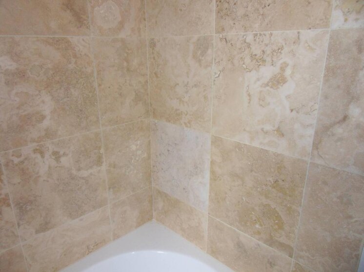

We need advice on one tile in our shower area that we first thought was just dusty. The Tile is travertine and when it is wet looks like all the others. when it is dry thought it appears to have a chalky appearance or covered in dust. Should we just try and seal it to bring up a shine or is there anything we can put on it to look like the others?
Don't really want to remove the one tile as we don't want to ruin the hard work we have put it.....Help!

Hi Polly welcome to the forum.
Did you seal the travertine before and after grouting?
You can get a lot of shade difference with natural stone.
A picture would help a lot.

travertine shades from tile to tile thats what gives the un-polished stuff that unique look,other than that it might be grout left on the tile

Does the tile feel rough compared to the others..?.. it might be residue from manufacture process.. a piece of 400 grit wet&dry will sort it.
Here is the photo.
