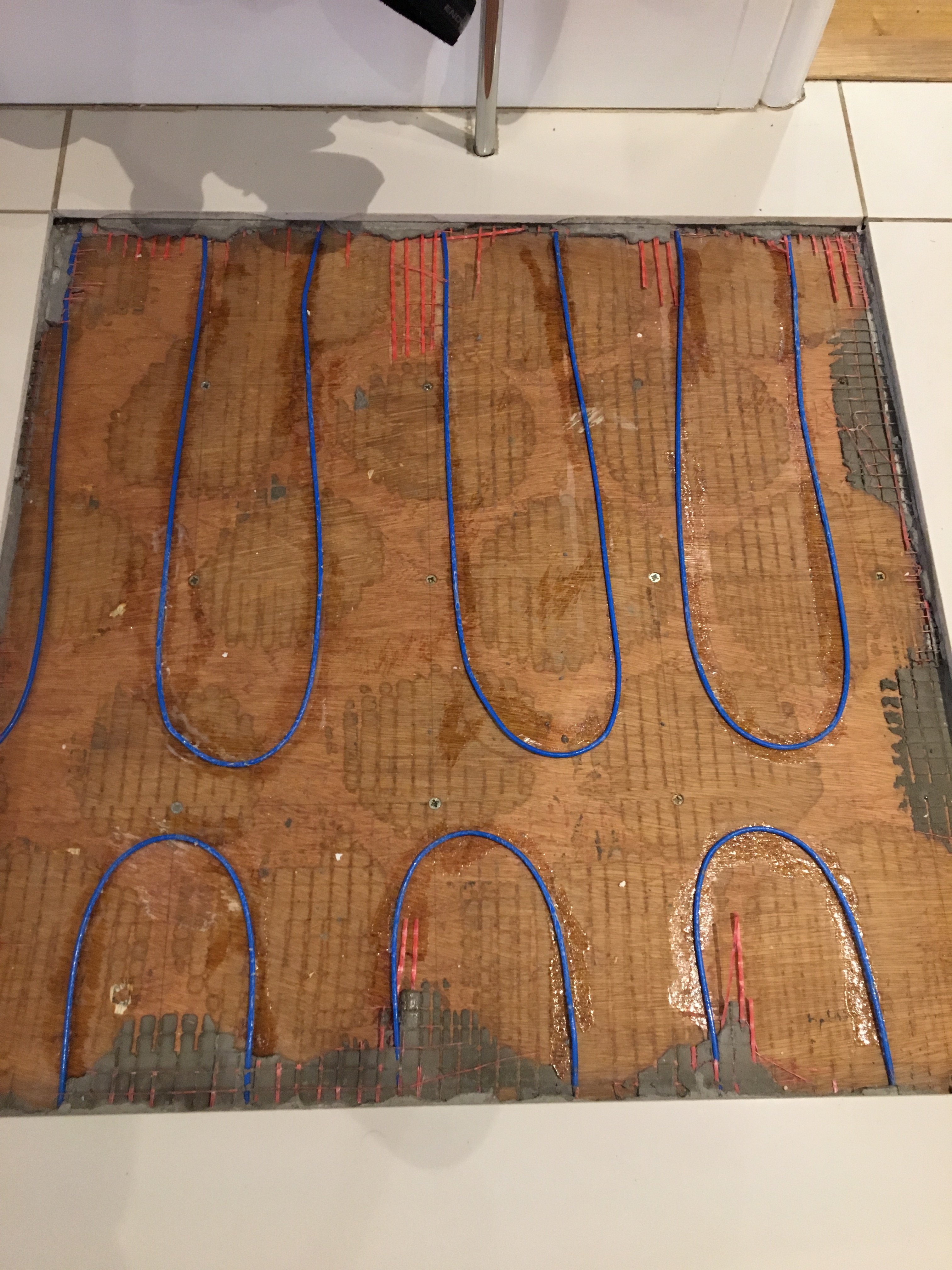

Hi Guys,
Got a real worrying job coming up, got to remove a single 500 x 300 travertine tile from a floor so plumber can repair pipework underneath, customer says he knows the tiler went straight onto the heating wire with no SLC. I also know the Travertine was not honed and filled as the original tiler said it was falling to bits during cutting. My concern is the heating wire, customer said oh we can repair it if it breaks. Going to have to dig grout out right down to the addy surely to get it out clean, have I got any chance of not damaging the wire? Cheers Rob
Treat it with kid gloves, I had to remove 4 tiles with ufh and clean wires up for a customer
19CF8D9E-2F03-4406-BC8C-06DF79E94459.jpeg 1A969650-7AA5-450E-88C5-4096F56C4ED0.jpeg
Any chance plumber can go through ceiling . Last person I know who had wire repaired paid £300 .
There is a repair kit but you need good eyesight and a steady hand
