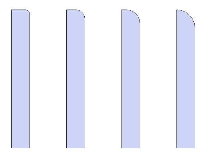

The image below is a scale drawing of 20mm thick stone which has been profiled with four sizes.
From left to right.
B5 - B10 - B15 - B20.
A B10 profiler (that's a 10mm radius or half a 20mm bullnose) looks quite pronounced on 10mm stone.
The B5 produces a more attractive profile size.
Using a B5 on 10mm thick stone would give a finish to the same scale as the second image from the left below.

Which of the profiles are you after? Much easier to see when they are set out like that by [MENTION=37954]ATSDiamondTools[/MENTION]

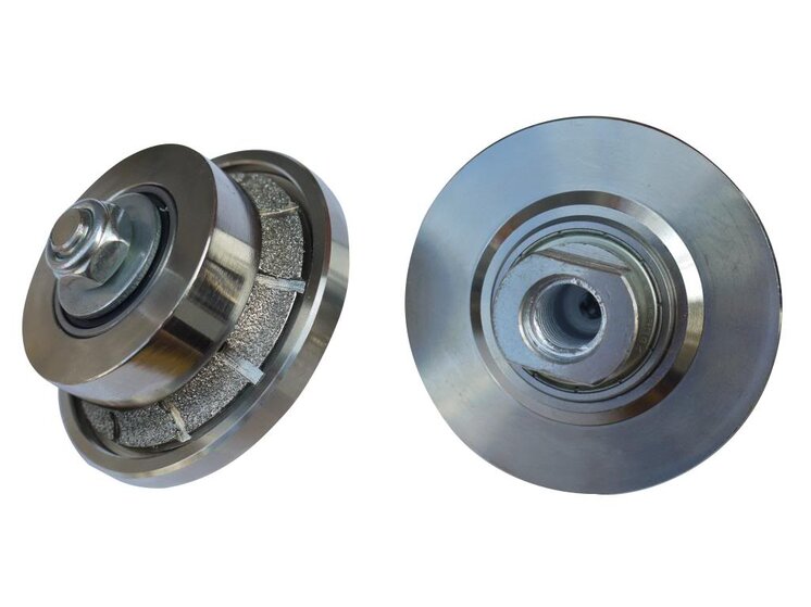

For the reasons Darren states here is why we make the cutting head on the B5 slightly less aggressive.
The B10 can be too much for a 10mm marble or travertine as these are a "one grit cuts all" piece of kit.
As a general rule go for a tool half the thickness of the product you're working with.
Half bullnose tools.
10mm/12mm tile = B5
15/20mm tile = B5 or B10 depending how much profile you require.
25/30mm slab = B15
40mm slab = B20
50mm slab = B25
Full bullnose tools are fixed though, they are designed to cut a single thickness product in one go and the stone needs to be pretty well calibrated.
