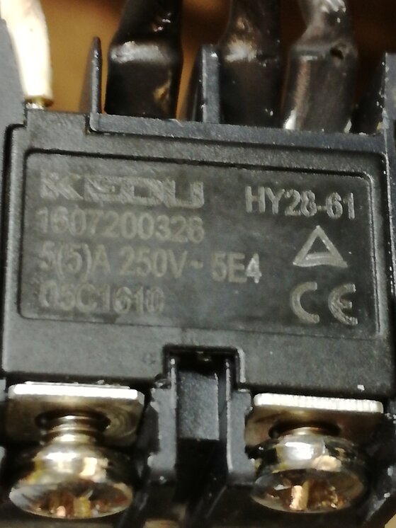

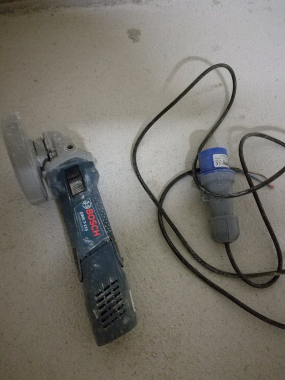

my bosch gws 7115, this week it stopped working.
I immediately thought of carbon brushes, but he has only 6 months of life, then I ordered carbon brushes, I opened today grinder and I noticed that the problem was not carbon brushes. (They have the same length of the new ones +/-). I disassembled the whole switch, nothing, then your luck has turned and look what was broken ...
I also made a discovery, (for me). If the grinder is not completely closed,
(the entire carcass), does not start.
I tried to turn it on, while I was working, but it would not start ... then I tried to assemble it all .... and gooooooooooo. 🙂
