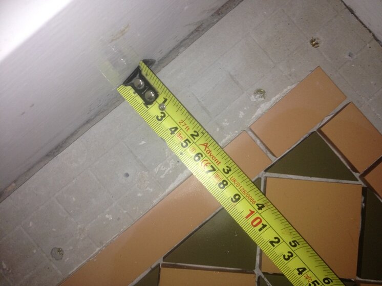

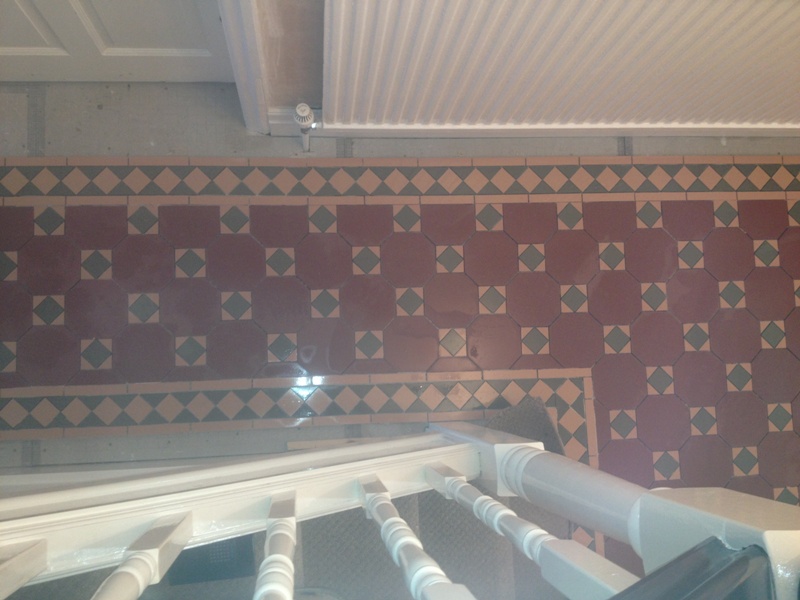

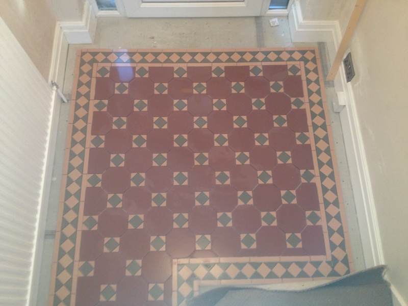

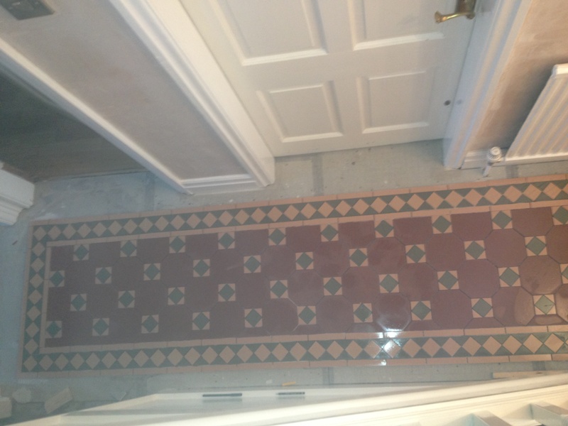

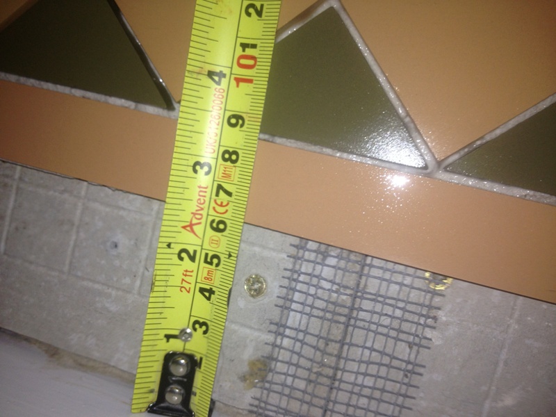

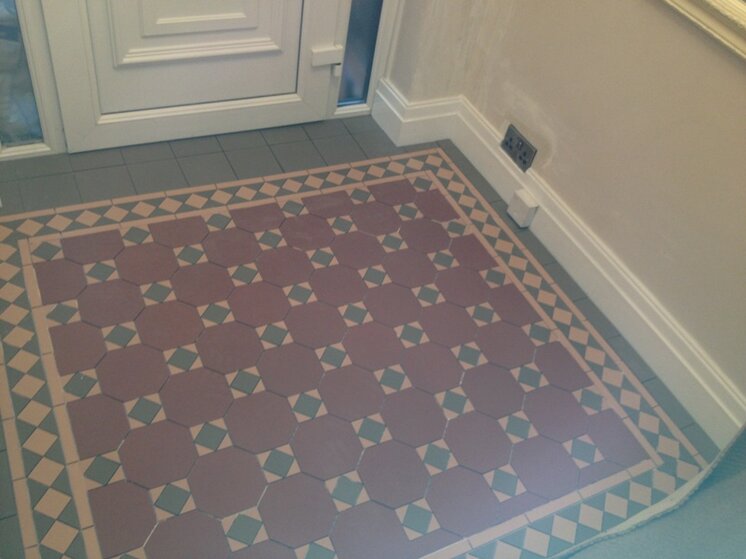

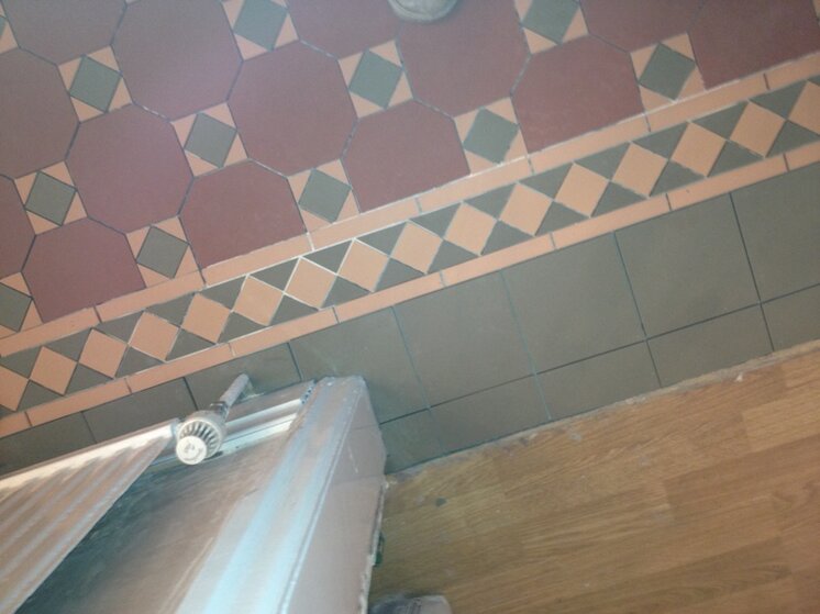

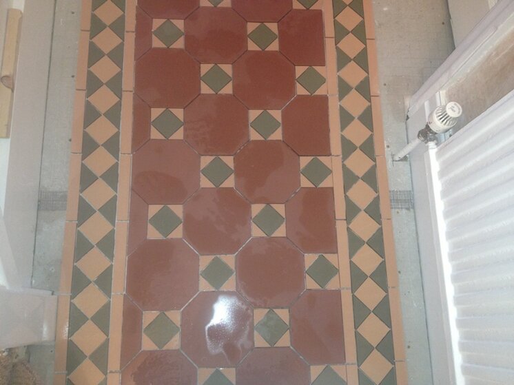

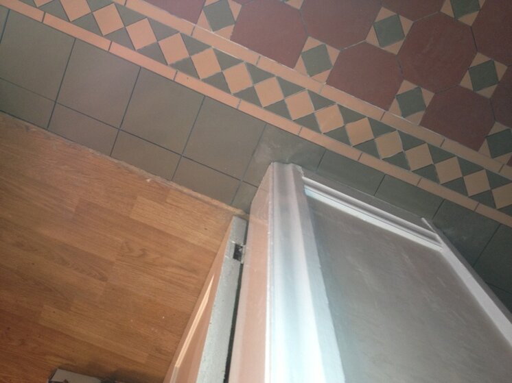

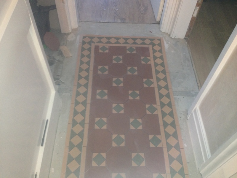

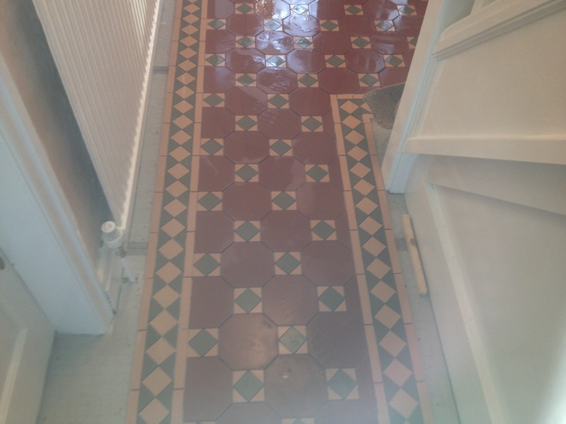

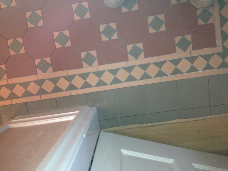

Just a few pics to show a pretty simple set out, this is the type of thing TJ and I would like to pass on to people who would like to attend the course. I am coming to the end of this one, the pics are not the best, but you will get the gist. NB. no double headers/ on point buff squares in border, no overlaps etc. variable within a couple of mm.
I am trying to show how with some good setting out, and some thought, anyone, once taught the techniques can achieve the pleasing overall effect.:thumbsup:

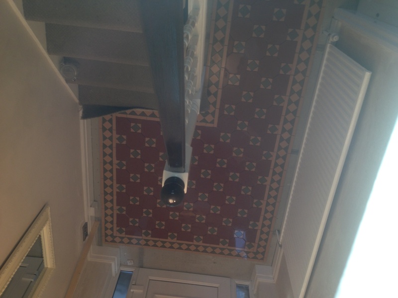

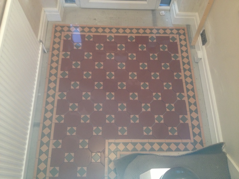

Just todays update, variable gone in, I did ask if they would like a threshold feature but they declined, I did suggest they took the border into the stairs as is the traditional way, but the customer is always right.
